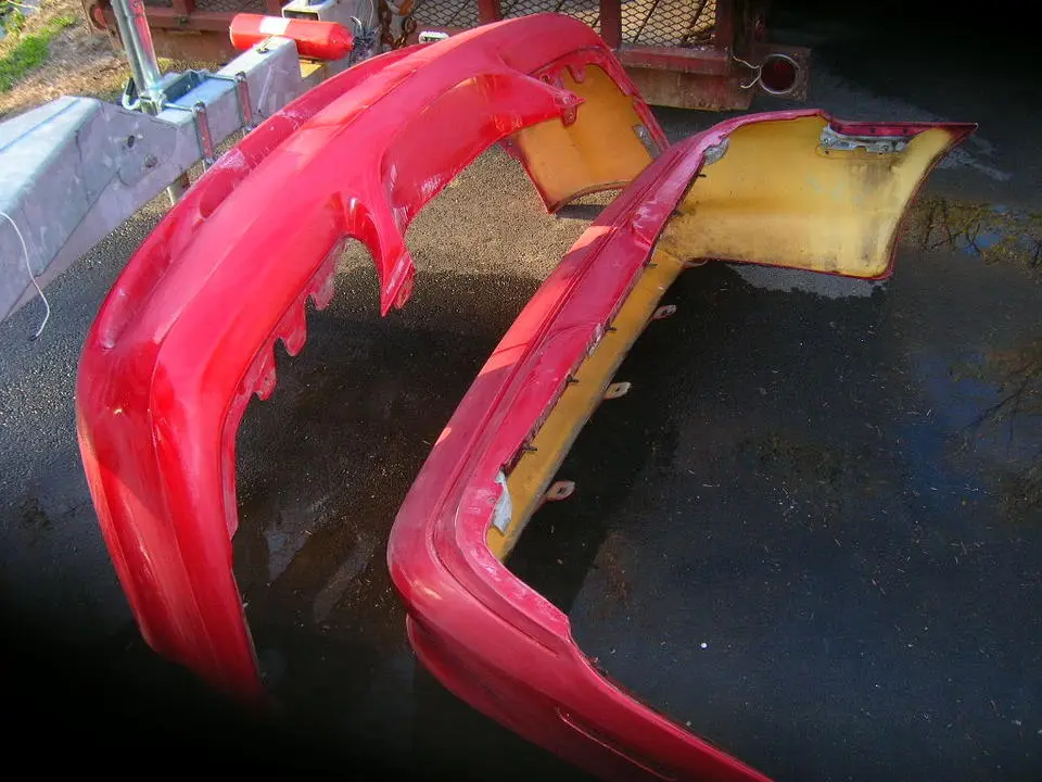

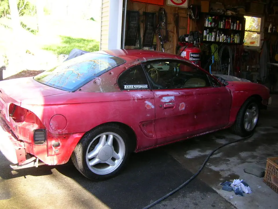

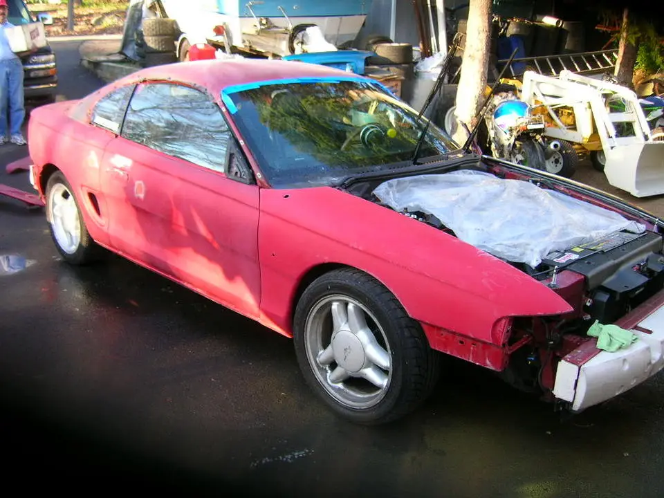

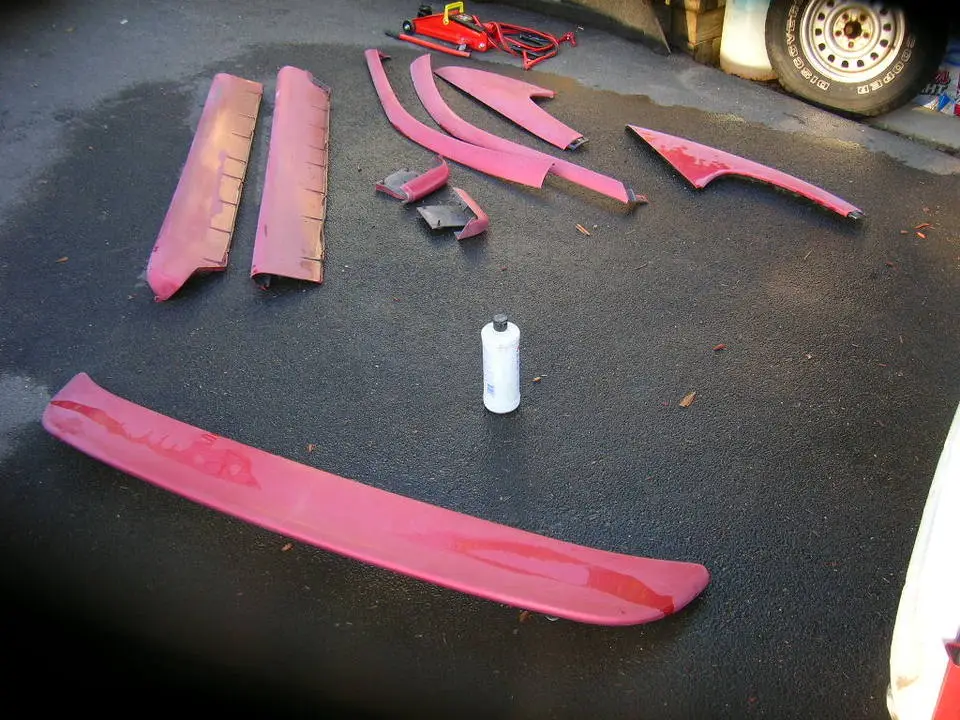

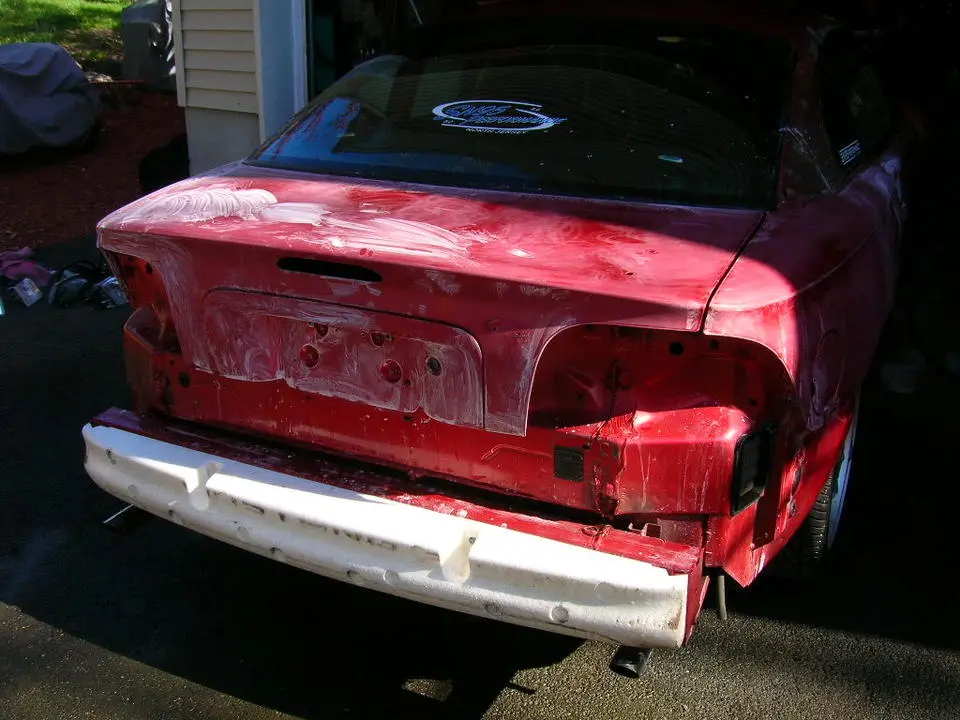

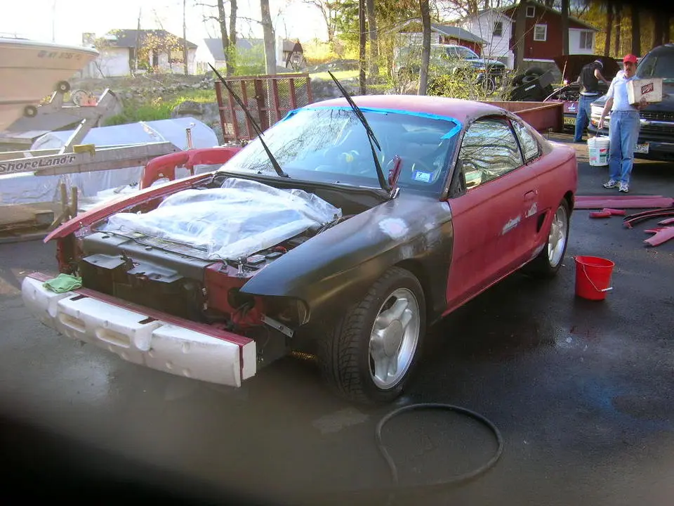

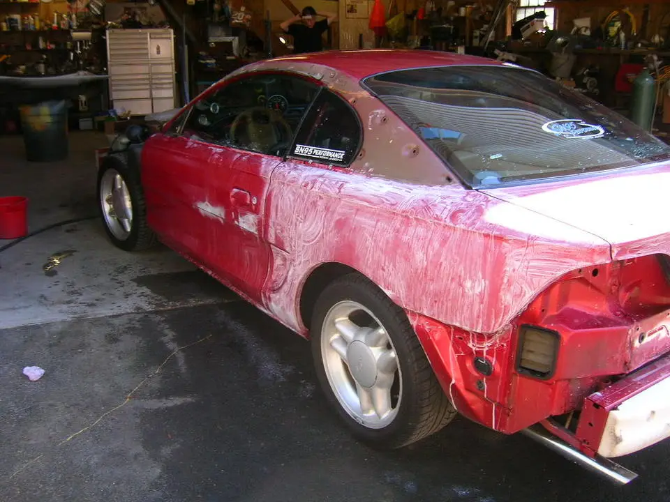

BIG UPDATE!!: Today i drove down to Jay's (blk9450 here on SN) house to start ripping the car down for paint. His brother is painting the car for me in their big ass garage.
Starting to wet sand with 400...
Fully wetsanded with new fender installed...
Panels ready for primer...

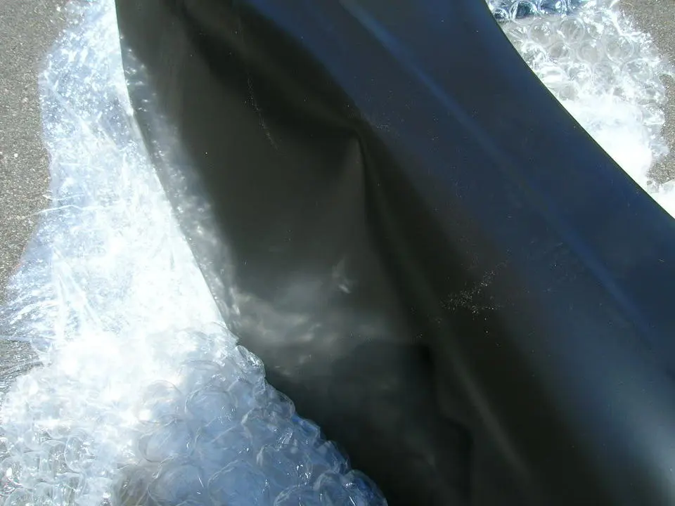

I recieved my new fender from FedEx today, and about an hour into tearing the car down, i decided to open the wrapping on the fender which i shoulda done when the FedEx guy was here. Well, the fender had a HUGE crease on the top about 8" long that luckily we popped most of out, and filled with bondo, but i was so ****in pissed off.

Tell your buddy in the backround of the new fender install to tighten his belt! :P GREAT JOB man... how bout i drive down there and he paints my notch? :D... As you kno i need paint, BAD. Good work, keep it up.
