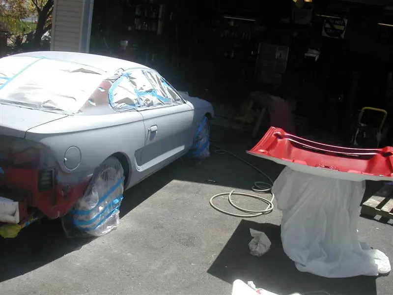

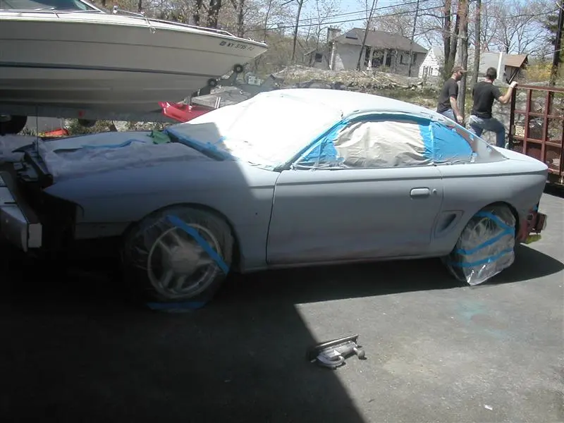

just finished prepping, body is primered and hood got its first few underside coats.

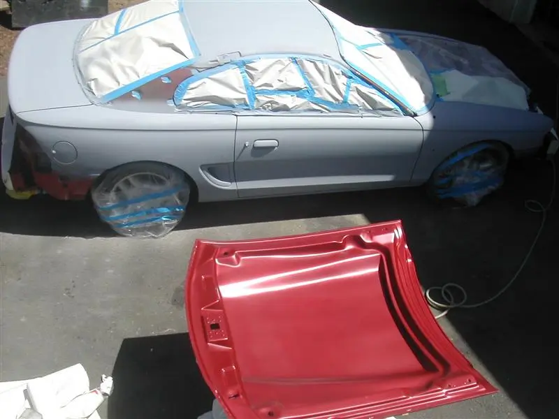

d

are you going to R&I the handle and lock cylinder?
you know i dont speak spanish

R&I = remove and then install after paint

no the cylinders are taped. the handles are body color, you spray them on the car...

gonna be a little tricky to get color/clear all the way around the handle.....
im just trying to give you a little tip that will make it turn out just a little better. since you already have the trim panel off for the belt moulding and mirror, it will only take about 10 minutes to remove the handle and lock cylinders. the handle is held in with 11mm bolts, and the lock just clips in place.
its the small details that help the job turn out that much better. you went through all the trouble of removing the bumpers and other trim, why not go a little further?
either way, good luck!!
