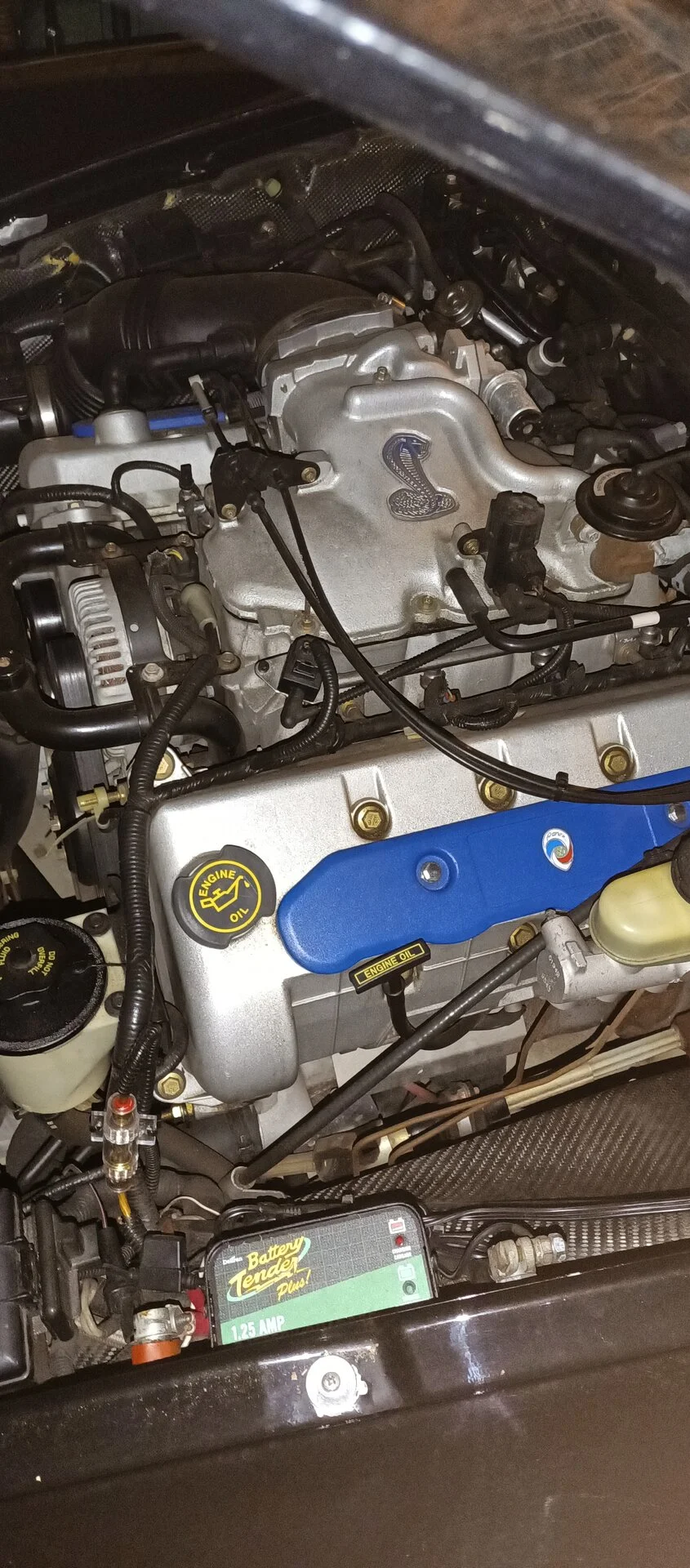

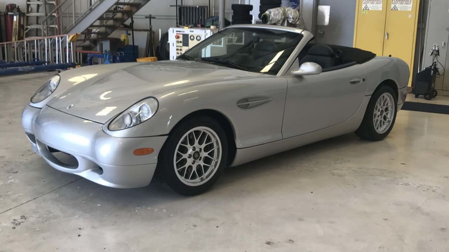

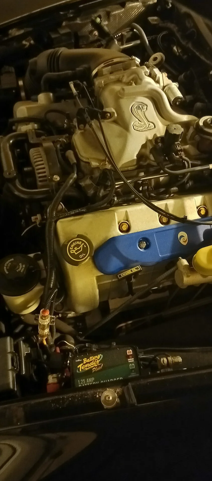

It is actually a 2002 Panoz Esperante.

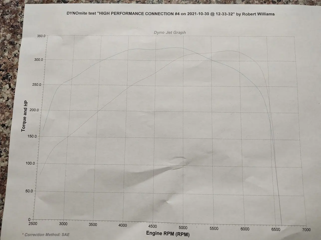

I got a recipe for ya:
JBA headers
JLT intake
2.5" pipes with h pipe from there
4.10 gears
dyno tune
320 rwhp a little bit more torque. doesn't sound like much but look at the area under these lines. i got power EVERYWHERE.
my engine is stock except for a slight bump in compression (flat top pistons) and 99 cams.
its fun as hell to drive. a lot of dudes are real happy with 4.36's so maybe check those out, too.
if you make fun your goal instead of some arbitrary number you're gonna get more of it.
