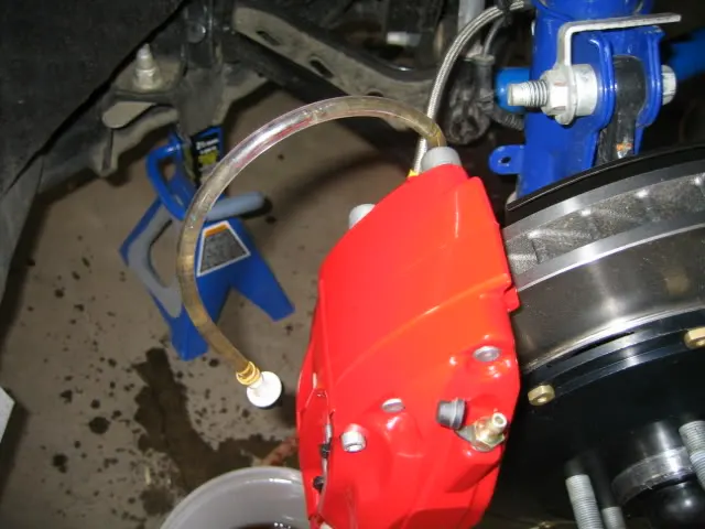

I use a brake buddy from nappa it has a hose with a check valve on it so you can bleed by yourself
