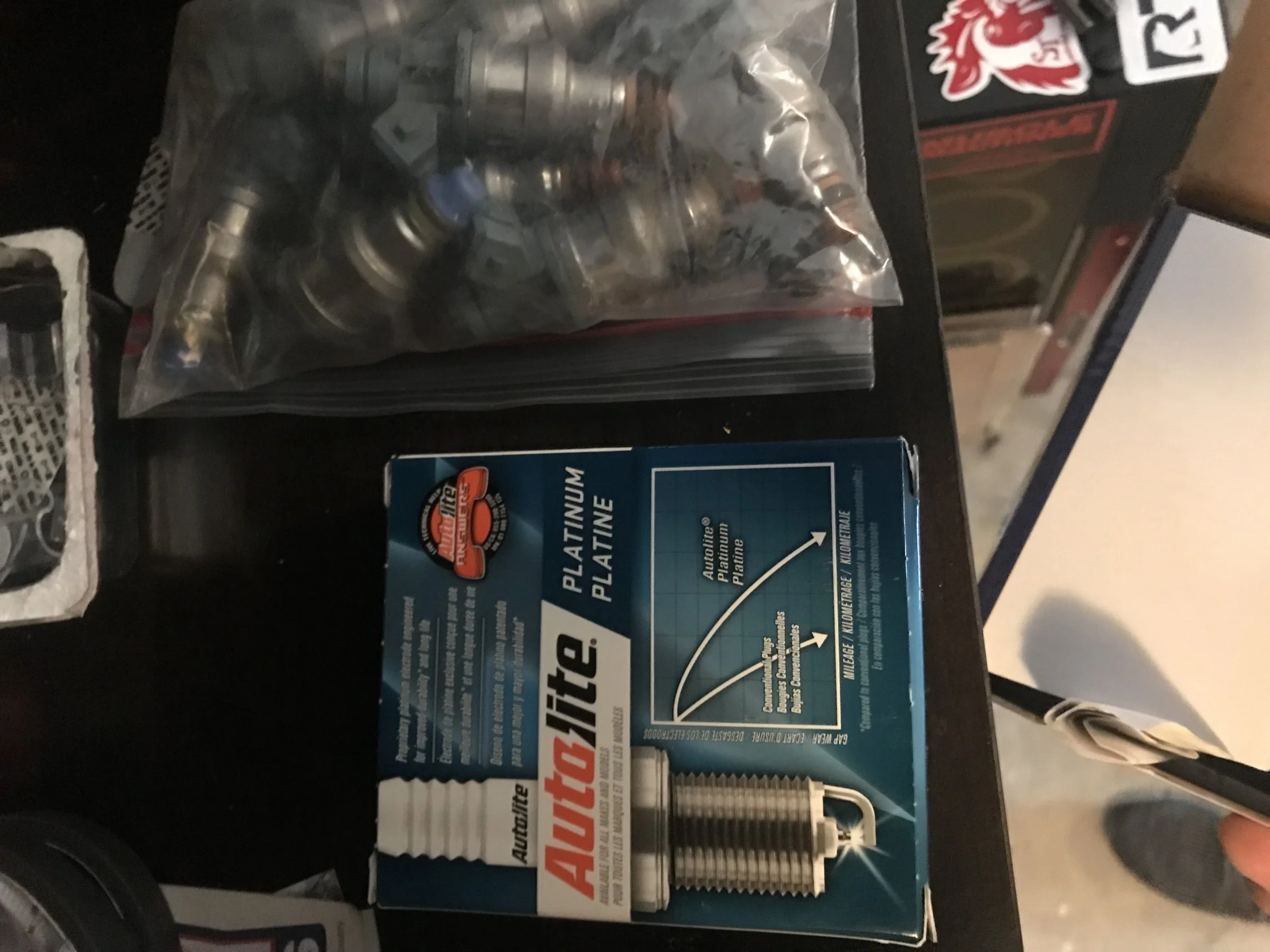

So bought these plugs for my car as I’m putting in a new msd cap and rotor, live wires, and Screamin demon coil. Now Davis says to gap to .65, these plugs are pre-gapped at .54 can I gap these more? The guy at the store said bc they are platinums I cannot mess with them or gap further or it will mess them up.
You are not supposed to gap Platnium or Iridium plugs at all. The metal is only a coating, and easily damaged. No gapping or cleaning. Install the plug, or remove and discard..that's it.

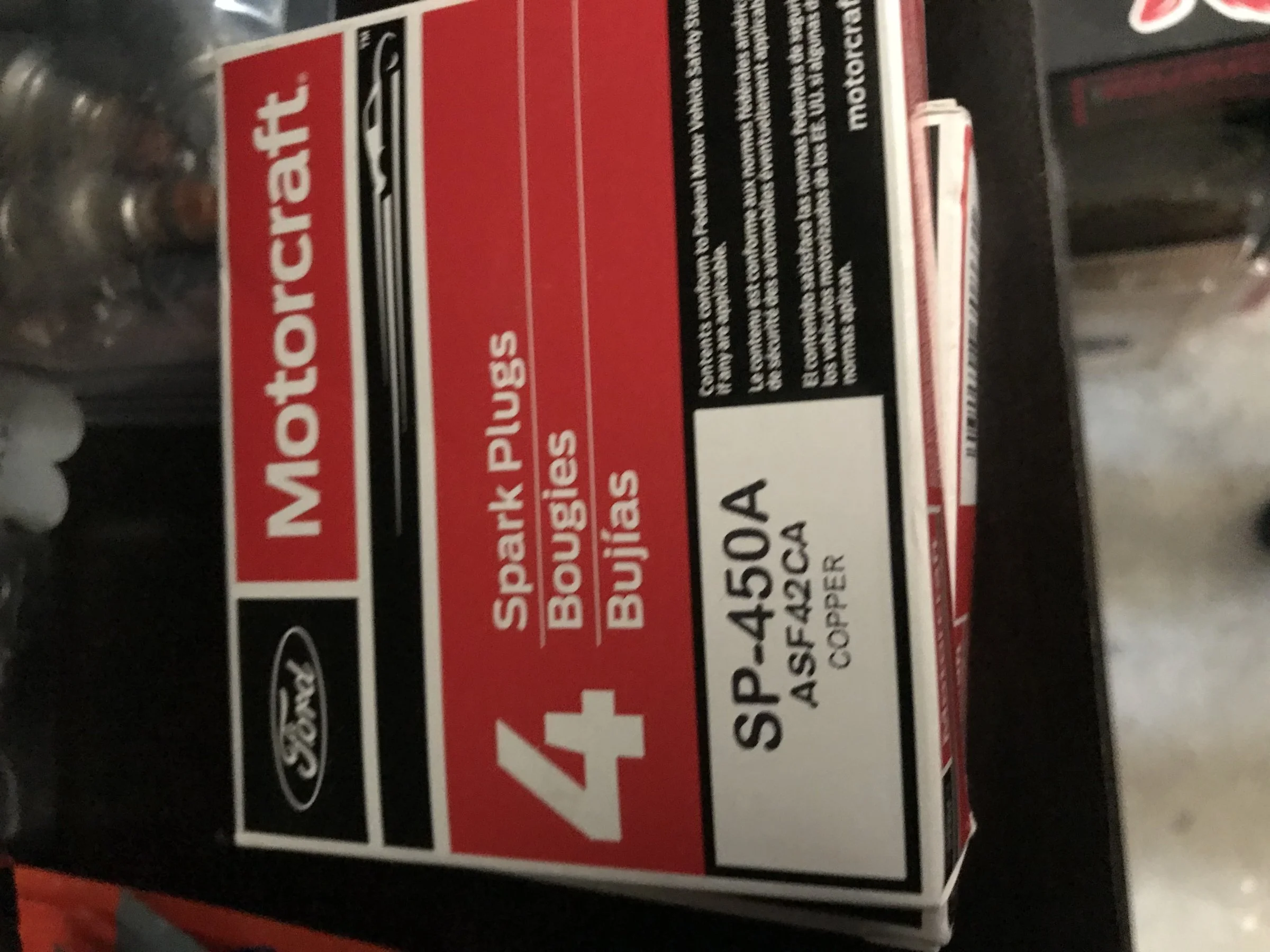

Thanks for the advice took them back and swapped them out.
