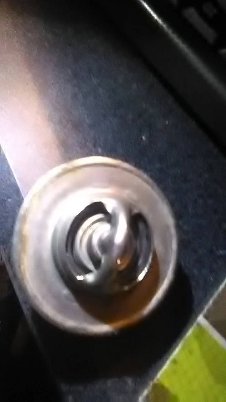

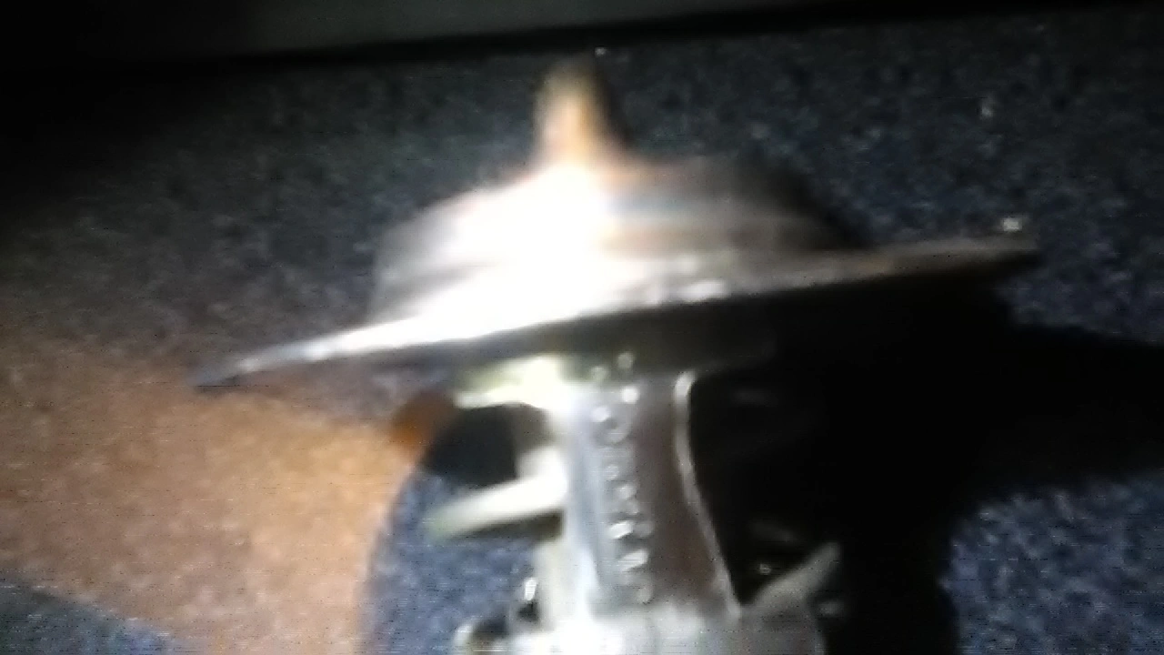

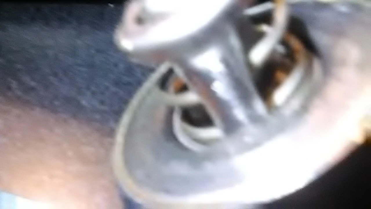

I had overheating issue back in April and I purchased some parts for installation namely thermostat, housing & fuse. My car overheated this weekend and now won't start. My son pulled the thermostat that was supposed to be new (pics below); The replacement part I purchased for 1995 Mustang Convertiible 3.8 was as shown on the receipt a Pre T THM PM195-0025 from Napa. What was taken out this weekend was a MotorRad 91C 195F pics below with name printed on the side. Is this the part I purchased or was it never changed in April? Is this the same thermostat on the receipt as in the pictures? IMG_20190826_223857.webp IMG_20190826_223927.webp IMG_20190826_224055.webp IMG_20190826_223857.webp IMG_20190826_223927.webp IMG_20190826_224055.webp IMG_20190826_224211.webp

It sounds like you may have purchased parts for someone else to do the work...if so, did you receive your old parts back as a method (not surefire) of ensuring installation? Also, I've mentioned this before on other posts..many parts manufacturers supply parts to multiple distribution chains, so finding a part "branded" as something else in a Napa box (or even a Ford box) would not surprise me...I saw a lot of it while working in auto parts for many years. You may try heating water on your stove with a cooking thermometer in it to see when/if the thermostat opens, or try to take it back (some are sold as lifetime guarantee, although your receipt does not indicate that being the case) or buy another one, install and get down the road.

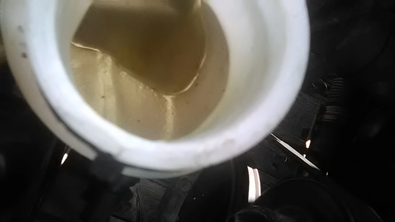

The liquid in the puke tank didn't look like antifreeze, it may have been the camera shot though.

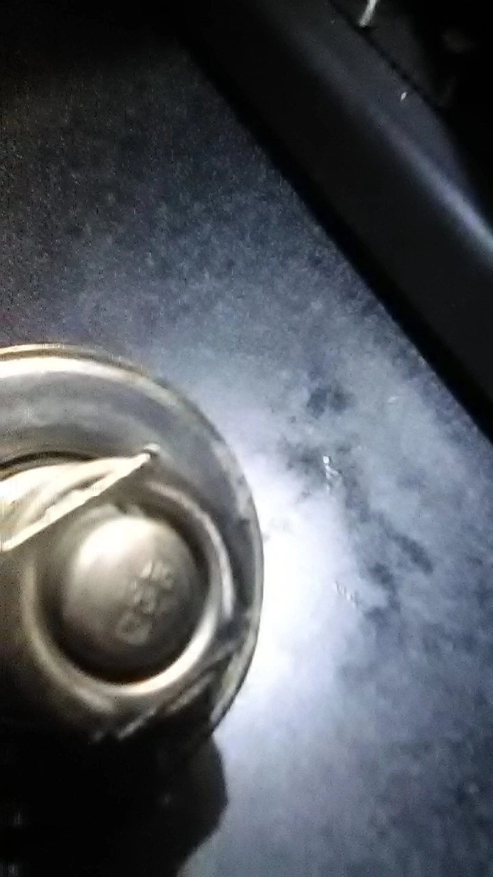

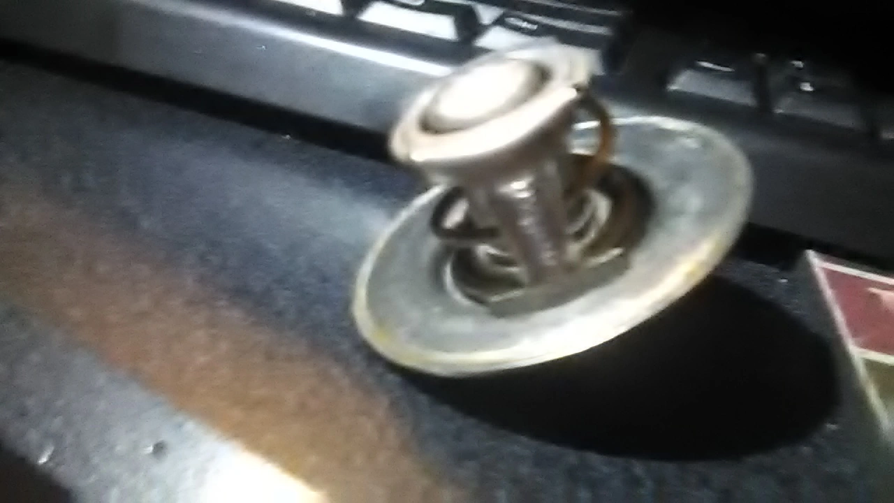

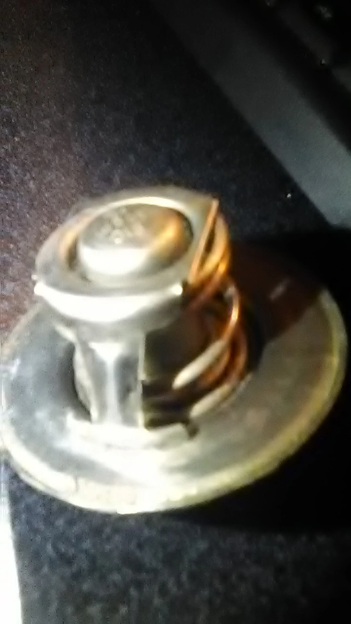

I need to know if this one here looks four months old or is this the stock brand or an older one that maybe was not changed out? I could not find where Napa in Idaho carries the MotoRad as a brand name on anything in the store. Am I wrong? I think this person is having me buy parts that they are returning for money and saying they put on. I may no longer have an operating vehicle because of this and it is a family member so its important that I figure this out. I think they are different and that Napa does not carry the one that was just taken out. It looks like it has been in longer than 4 months as well. these are three pics of one taken out that says MotoRad on the side and has 91C 915F FD? on the center piece.

It was shadowed and water had been added to it. It does not sound any different trying to crank now. I did find a hose that had worn through to the AC unit that I need to pick up another one to replace. I will try to pull the plugs as soon as the sun comes out here. Is there some kind of reset or something to start the car if the AC has issues and the car overheats? The reservoir was full where it was not full before it was to the full line but not full to the top before it overheated which I do not understand and now it looks like the guy who was supposed to put n a quart of oil a short time ago may have put in almost two quarts instead of just under a quart. This should not be happening the car ran great except was starting to have sloppy steering over 50 recently which may have been due to it being dropped off the jack when they were changing my front tires recently or my running over an unseen curb. It only has 100000 miles on it and its a 95. I am so frustrated and the thermostat that was taken out says MotoRad with other numbers and it should have been a Napa one that I purchased in April installed. I don't think Napa carries anything that says MotoRad for my car in thermostats but I am checking on that as well.

I am not trying to do anything more than determine if this person should be working on my car now and if they are being honest without bringing it to them in the event there is a simple explanation and I am completely wrong.
I'm not sure that any of this matters unless the thermostat is the thing that is responsible for the overheating. Have you dropped it into a pan of boiling water to see if it opens and closes? If it does, it's a waste trying to pin it on the thermostat.
