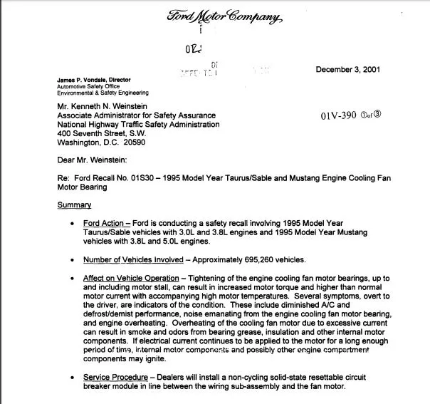

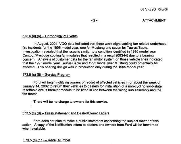

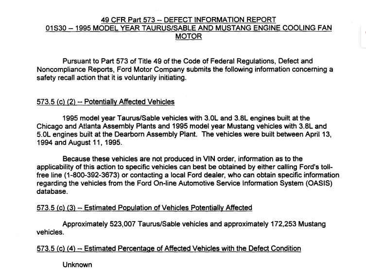

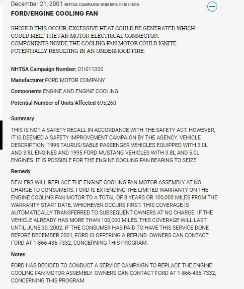

Sorry I dropped off the entire situation just depressed me to where I just left it parked and have not touched it to check compression, or anything else for that matter. Someone mentioned the water pump possibly causing the issue - is the water pump located underneath the car where the board could have hit it and did something to cause the problem with it overheating after I pulled over to take top down? The only thing I noticed before I pulled over is that after I hit the board it seemed to not want to handle as well as it was, but that could have been caused by the tire since the day after I brought it home the drivers side tire was flat. I have not even bothered to have this changed at this point hence the not looking underneath for damage from the board or checking anything else. I did however take another look at the hose I was told was blown and the person who told me this obviously does not know what they were looking at because the hose to the ac is perfectly fine. I had replaced a couple of sensors earlier this year when I had the belt changed so I am pretty sure it was not a sensor problem. However, I did look online and found something interesting regarding the fan on recalls. I had a shop check recall information last year when I had a anchor put into the car for carseat and they said they found nothing on my VIN but this says that they did not recall by the VIN does anyone know anything about this or if it would have caused the issue?

It won't crank over - it trys but won't quite turn over all the way. I am stuck on the board thing because it gave a flat tire as well and I am trying to figure out if it may have damaged something. Of course, I have not even looked under the car yet I just got the tire put it on it. Also wondering if the recalls on the fan motor may have had a play in it but FORD told me my VIN Was all clear two years ago but they never checked the plant or the build date only. They did not keep track of the VIN where and when my car was made so it wouldn't show the recalls under my VIN. My insurance agent is asking questions so I am trying to rule things out without paying for another tow to the shop. Hoping there is an external reason for the overheating but had to put it down for a couple of weeks it was giving me a headache.
The fan recall was done due to fire hazard with the wiring. If your vin was cleared, then there’s not much more to say.
