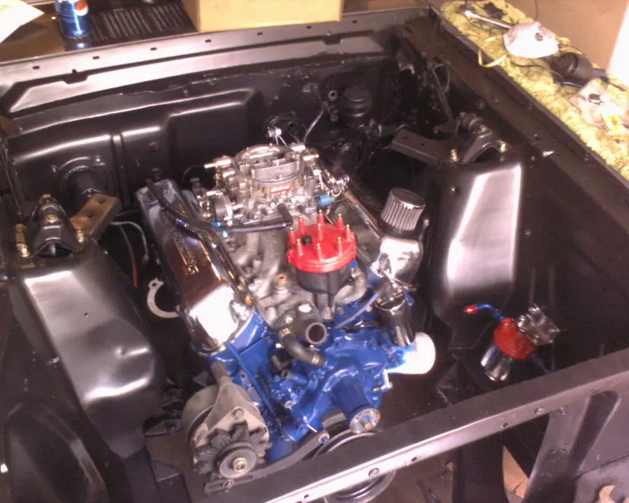

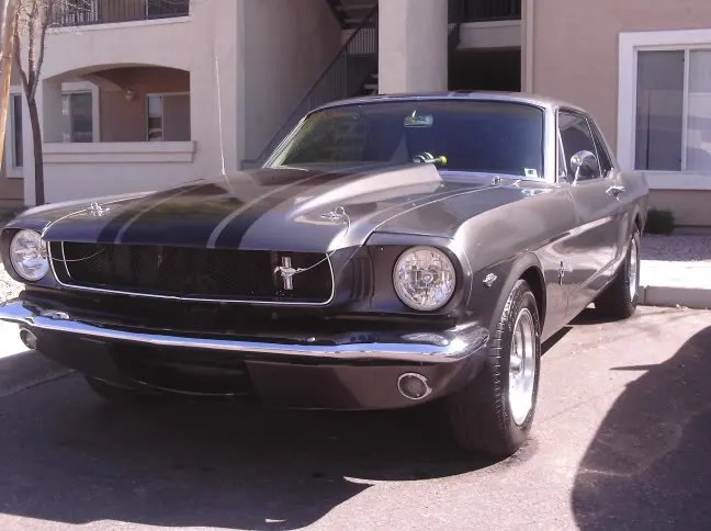

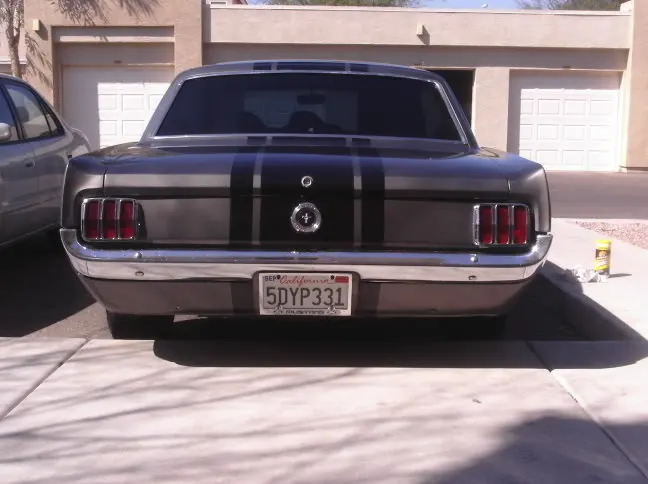

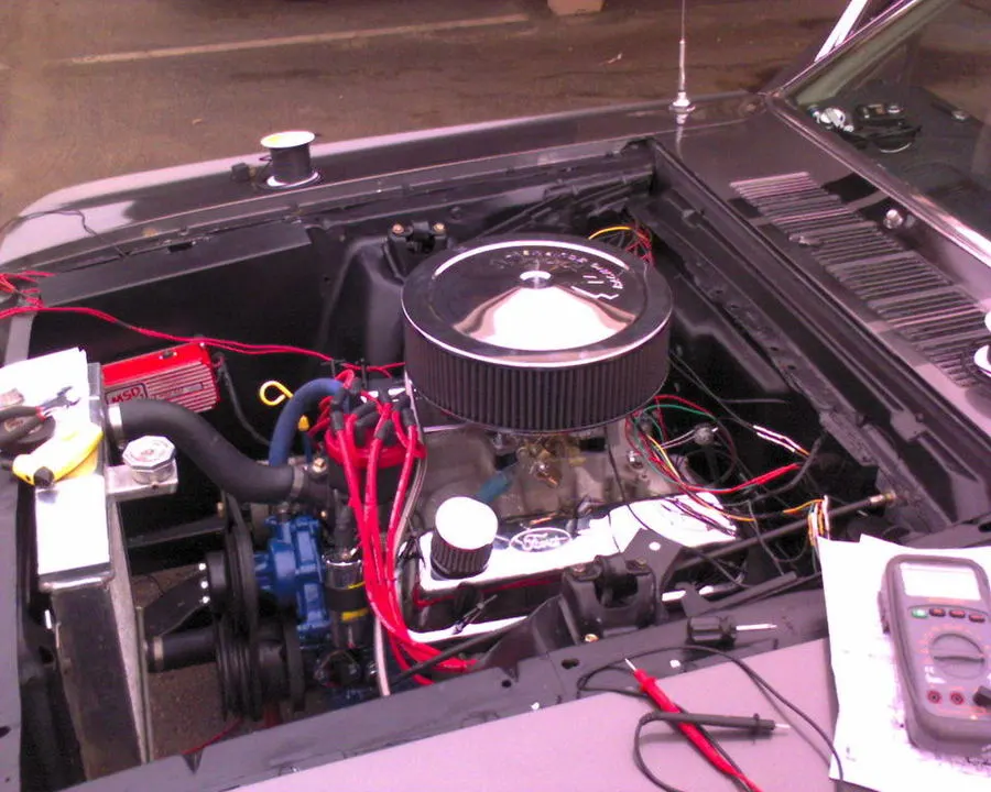

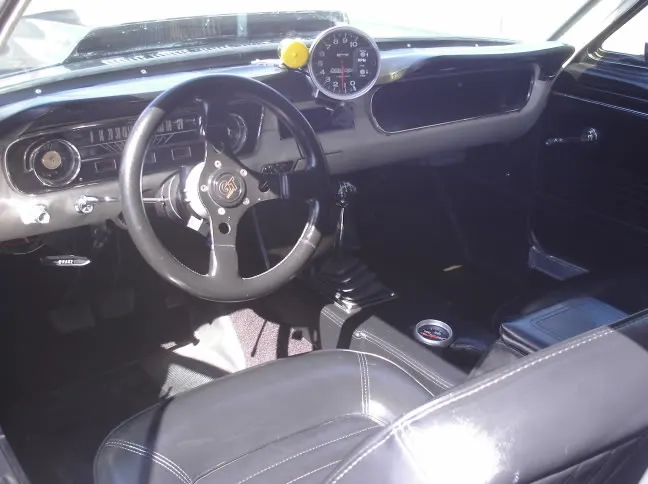

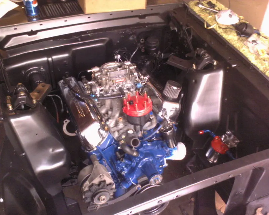

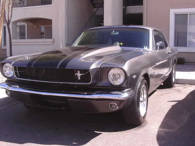

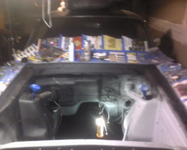

Well, what do you guys think...shes not done yet but getting close.
Recap: t5 swap, TCP R&P conversion, battery relocation, engine comp. rewire, detriot tru trac lsd, electric fuel pump system, sand, paint, cleanup, some interior work and alot of other little things...
post comments...suggestions too...
i have more pics too of everything else if anybody is interested
Before:
After:

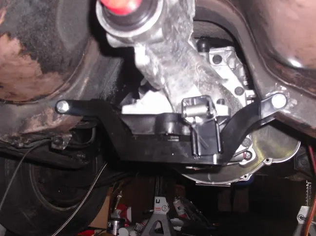

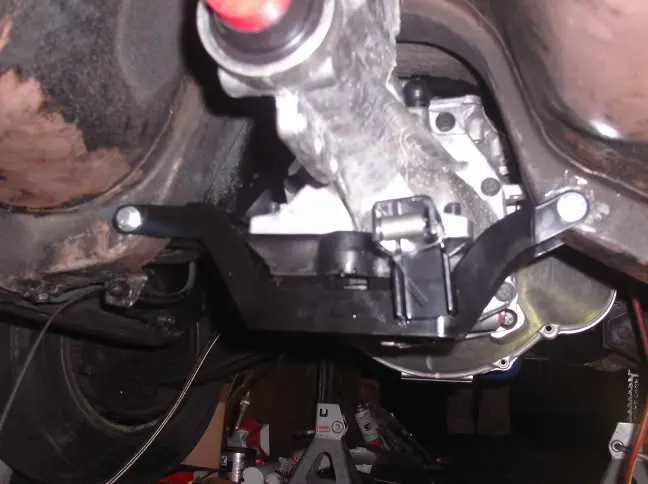

Nice Job!! car looks great. Did you swap the t5 in place of an auto or was it already a manual? I'm looking to swap a T56 or TKO 600 in place of my auto, a few companies have these kits available, any suggestions? Keep us posted with some more pics

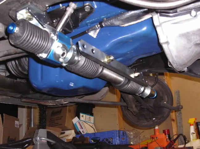

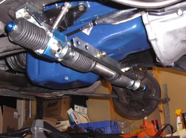

she was originally a c4 auto. At first i was going to do the swap to an AOD just for the extra gear, but then i started thinking about what im going to do with the car, how nice it would be to have two extra gears and just a manual trans is so much cooler than an auto...so i went with the 5spd. the swap was very simple, not a biggie at all. i would have liked to go with a richmond or beafier trans but the cash flow was taken up in other mods.
i suggest doing a kit if you can, i did the kit from modern driveline, i paid a little more than searching around and buying stuff, but it was alot easier to to call them up and have them send what i needed. the only thing i got seperate was the clutch pedal(ebay)

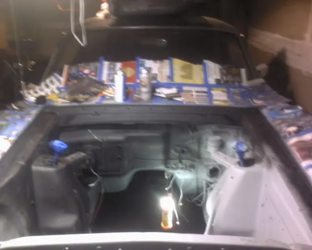

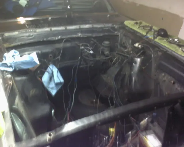

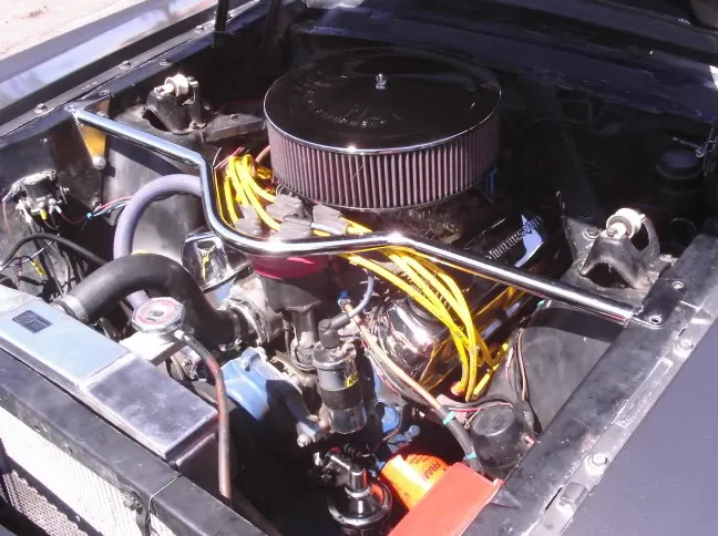

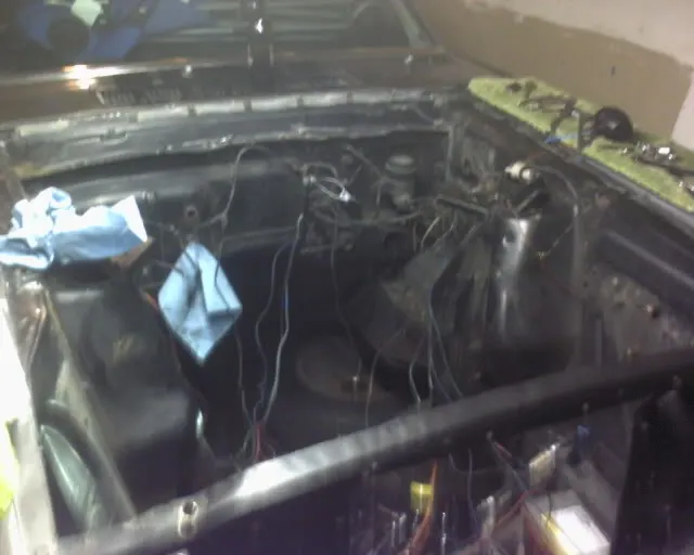

during the process:
another before pic:
ill get some more when tomorrow or tues
thanks for the comments guys!

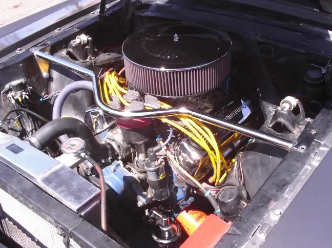

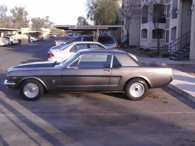

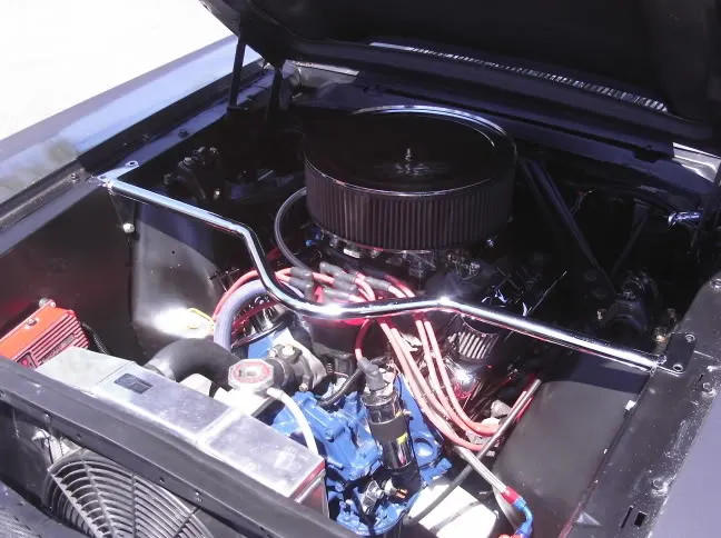

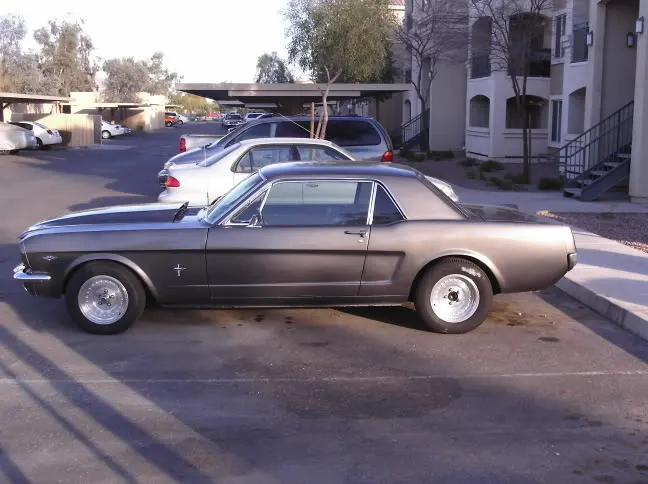

here the side view.. this pic is a little older(prior to wax)

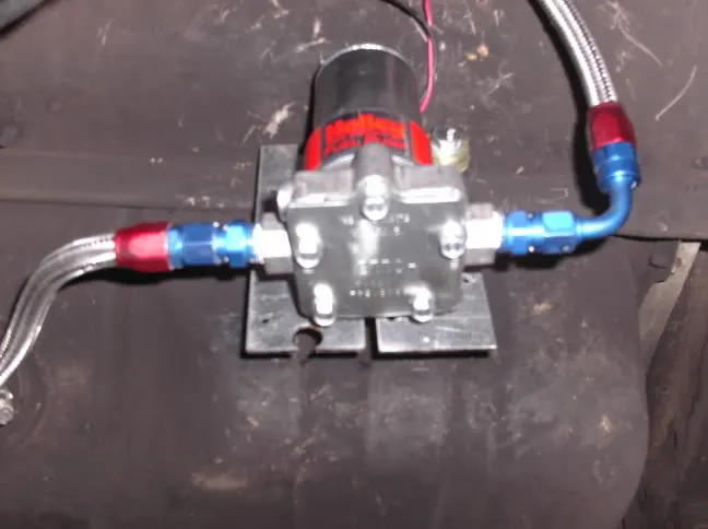

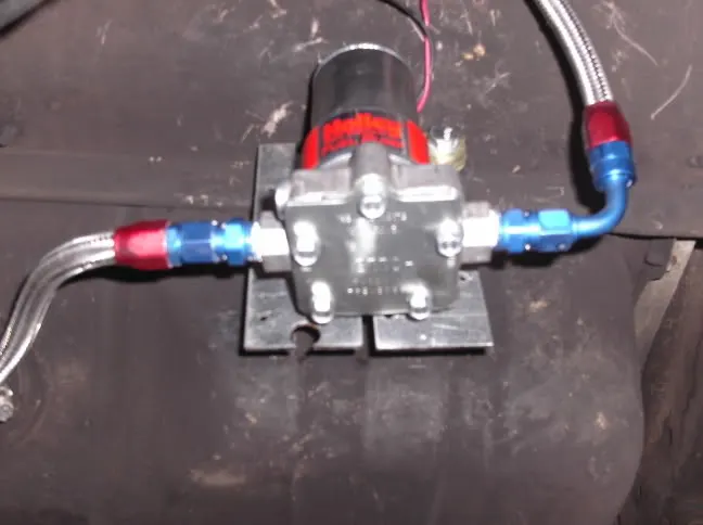

electric fuel pump mounted at tank:

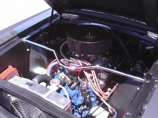

Safety
First off, the car looks great! Nice Job!
My only suggestion to you is do some work on the breaking system. Get rid of the “Jelly Jar” Master cylinder and at least upgrade to the dual reservoir master cylinder for safety sake.
Gotta be able to reign in all those newly found ponies! :nice:
Cheers,
Rufus
Rufus
that is one of the next prejects. i pulled some front discs off a mavrick a while back, just need to get a new m/s, rotors and pads.

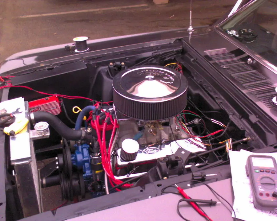

mikemustang289 said:
What kind of paint did yous use? did you do any sanding or just clean/prime/paint? this was with cans correct? Semi-gloss?
i sanded the entire compartment, not down to the metal but till it was smooth, ground out some of the ridges, points, etc. then primed it with grey, then sprayed it black. Its a Semi-Flat black made my Krylon.worked well. went on good and doesnt attract greesy hand prints
