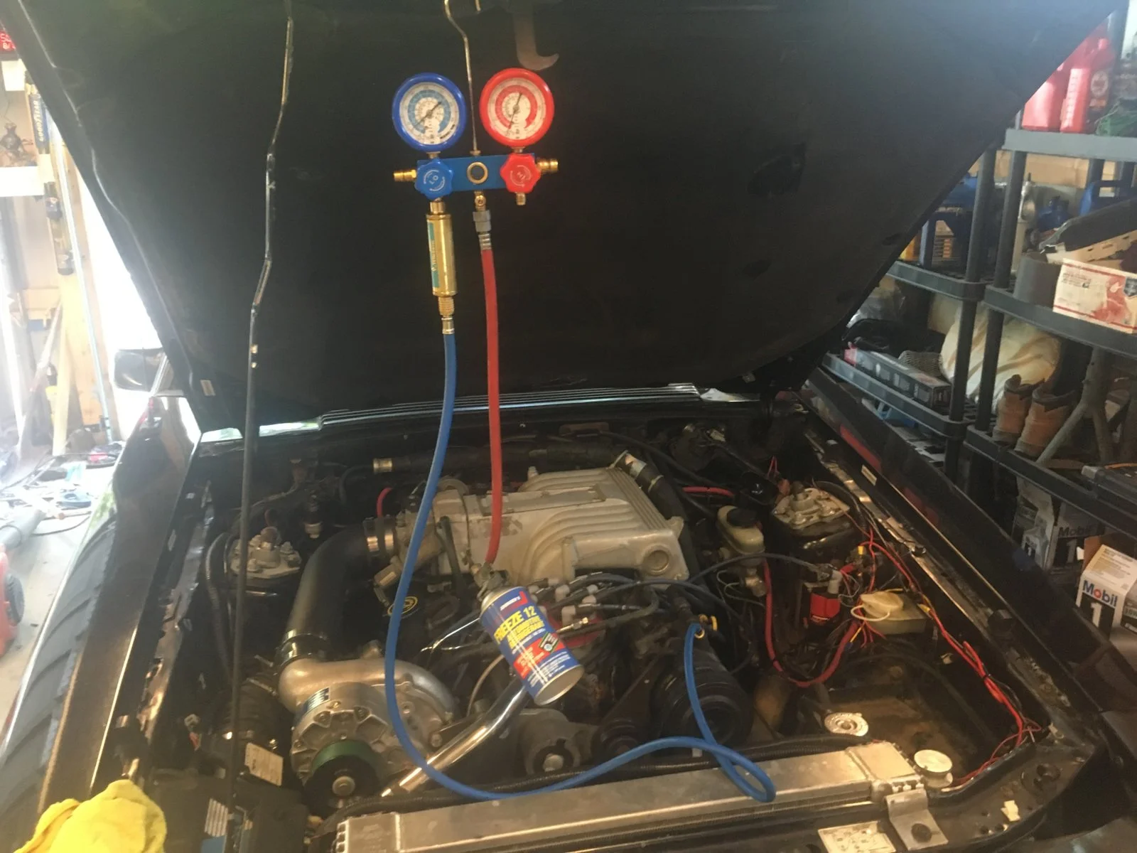

Very hot here today and the lx had recently seemed to get weak in the ac performance. I’m still running r12 in the form of subsitute Freeze 12 of which I just added a 12oz can. I found that the shrader was leaking a bit so tightened it up and looks like it’s stopped.

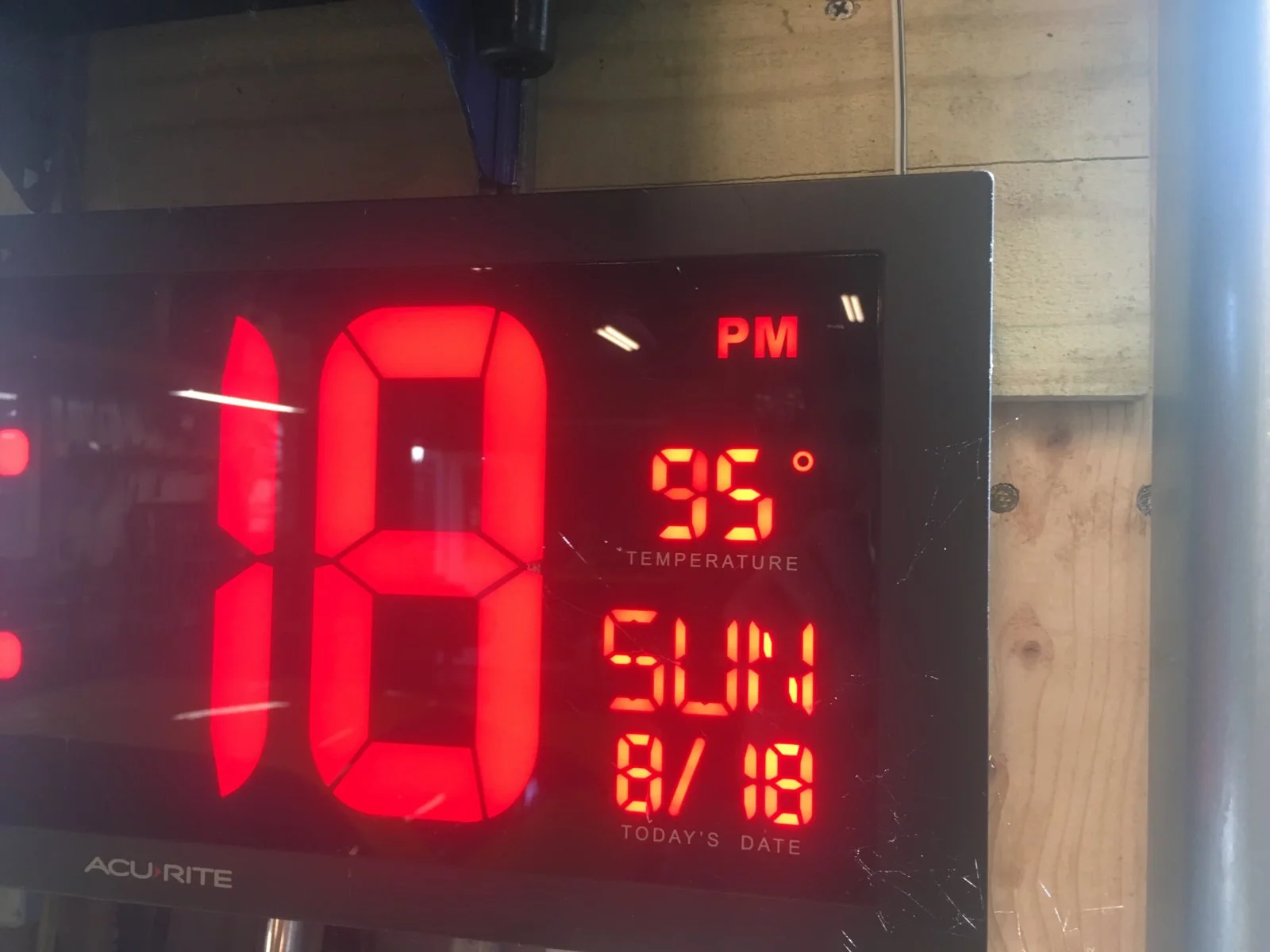

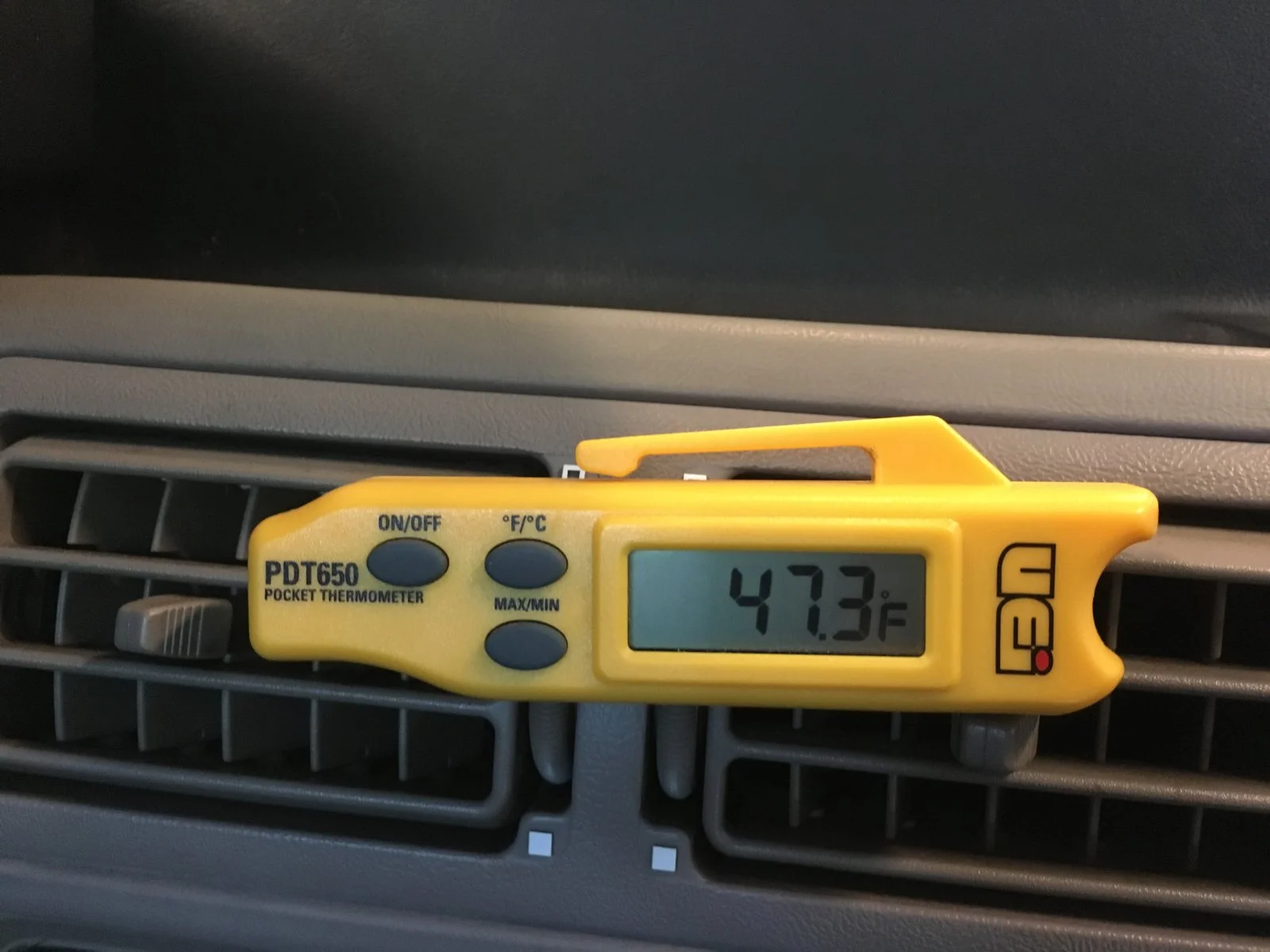

95 degrees ambient and I got the register temp to below 48 degrees. Would probably be lower with the car moving down the road.
