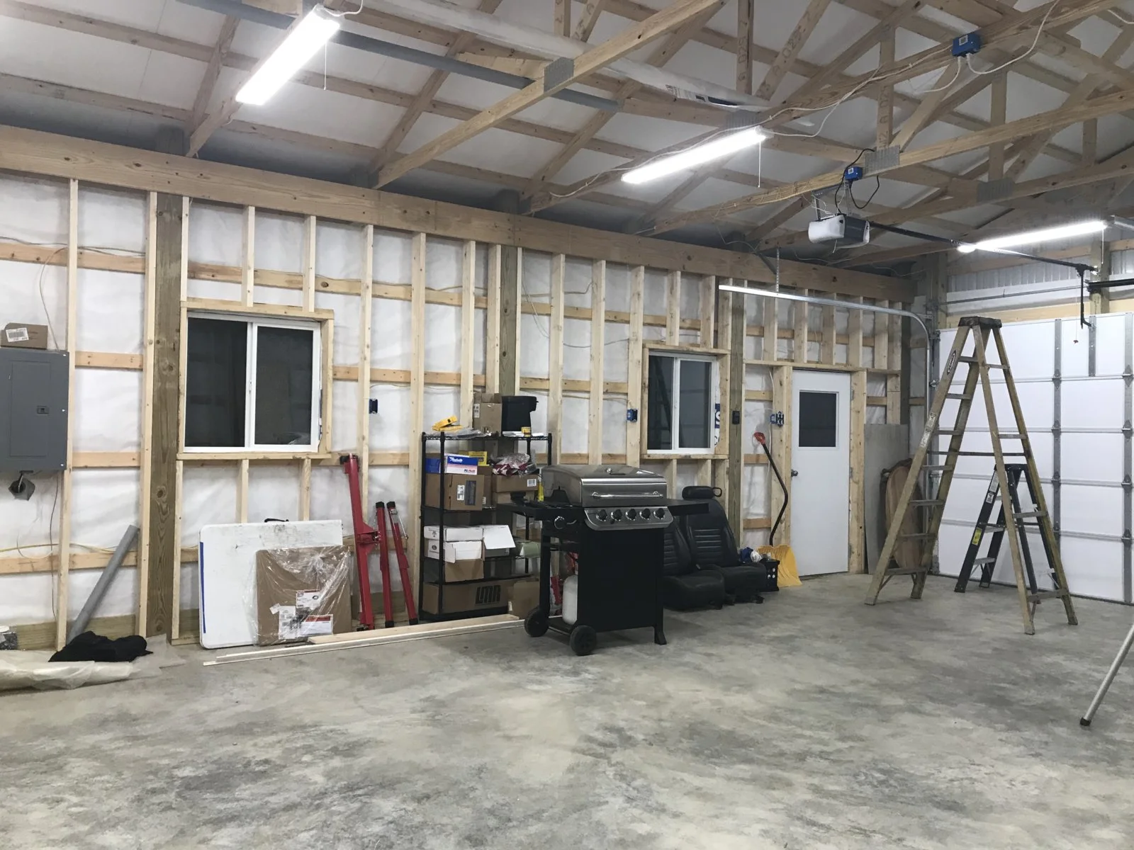

Nice work !Really sorry I haven’t been around. I like the new site so far. Here’s some pics of why I haven’t been online very much lately.
Finished a very long home remodel up a couple weekends ago. What a relief. So I’ve been doing a few hours of work here and there in the garage. Finally have power and lights. Even half the openers are installed. Lol

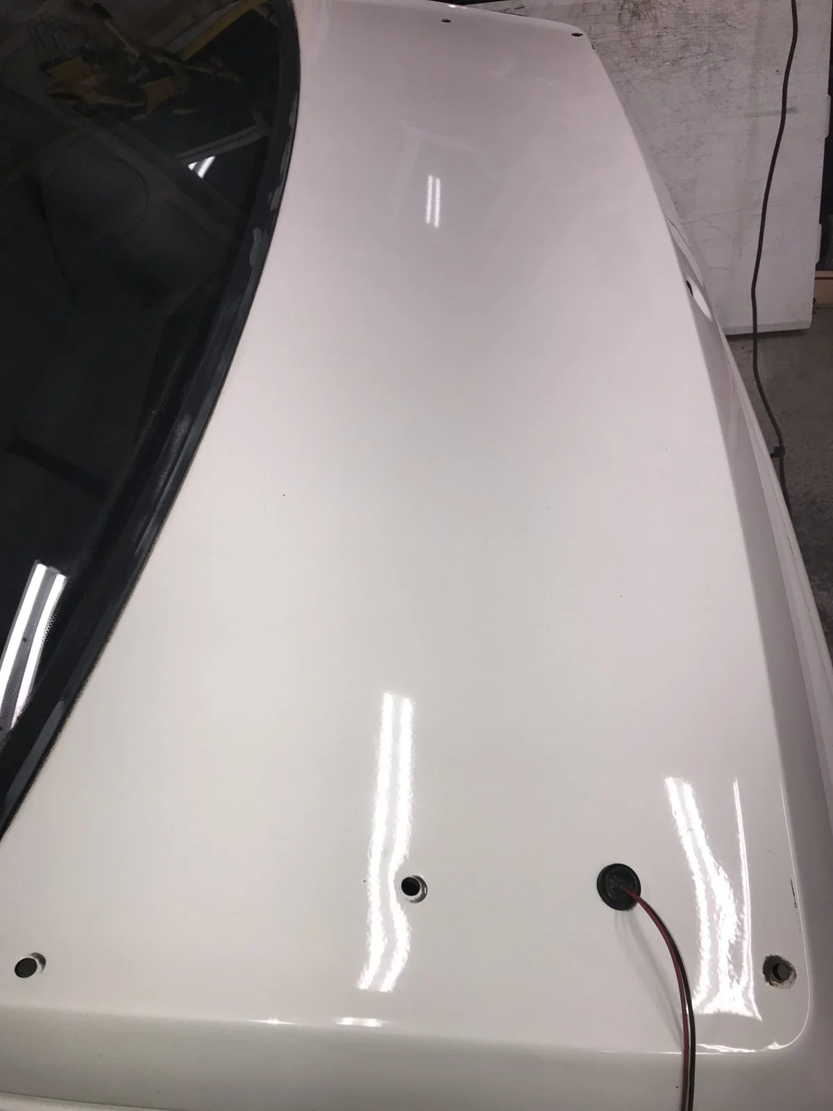

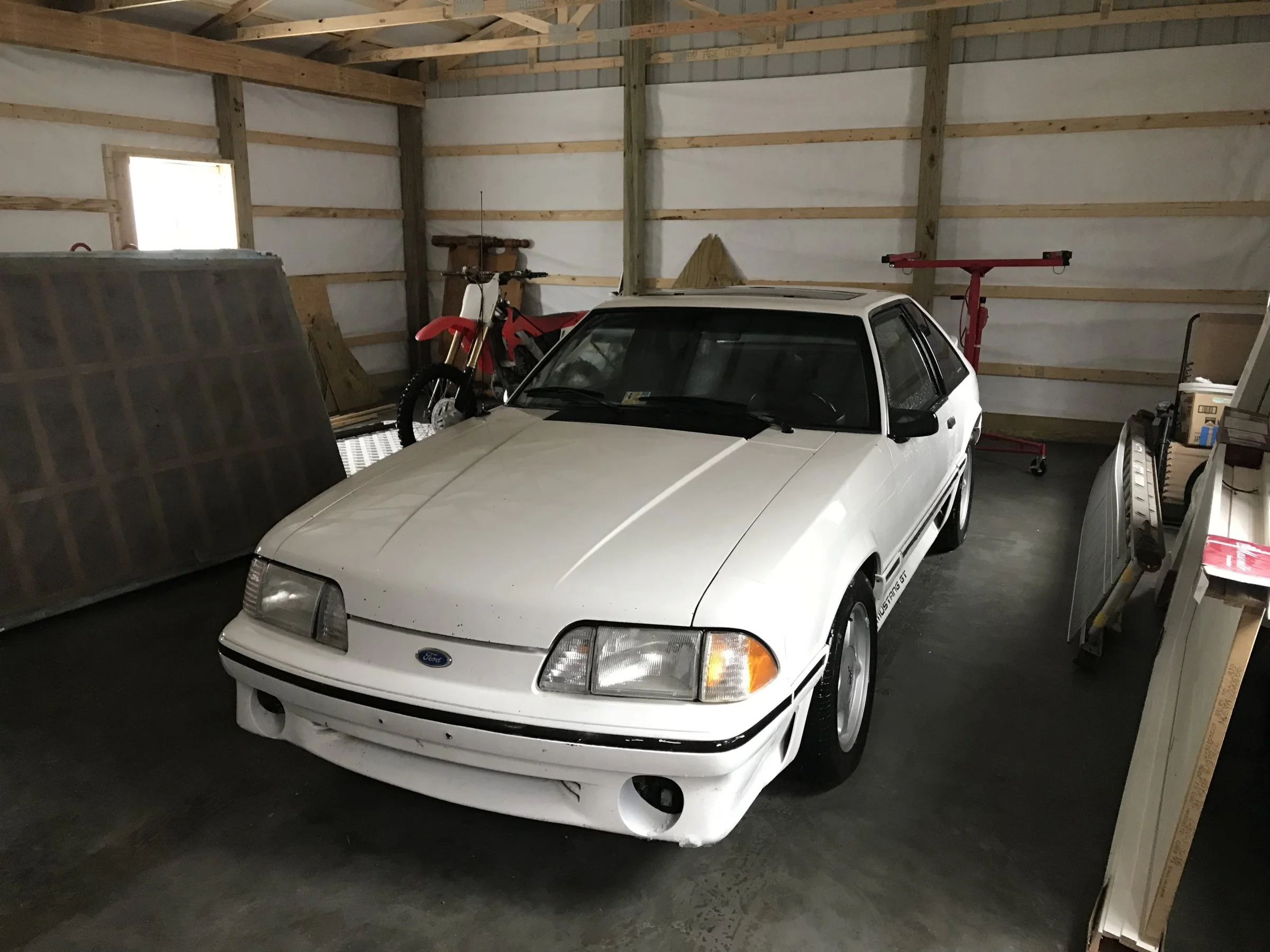

Anyway, yanked the wing off the stang because I knew there was some organic material between the wing and hatch. This car obviously spent some time outside. It was a little messy under there but not bad. I hit the hatch with some ultimate compound on the DA and then followed with some regular carnauba and I think with a lot of elbow grease I could make this thing visually presentable with just my labor. For now anyway. My lift should be here before the end of the month and big things will commence on this car.

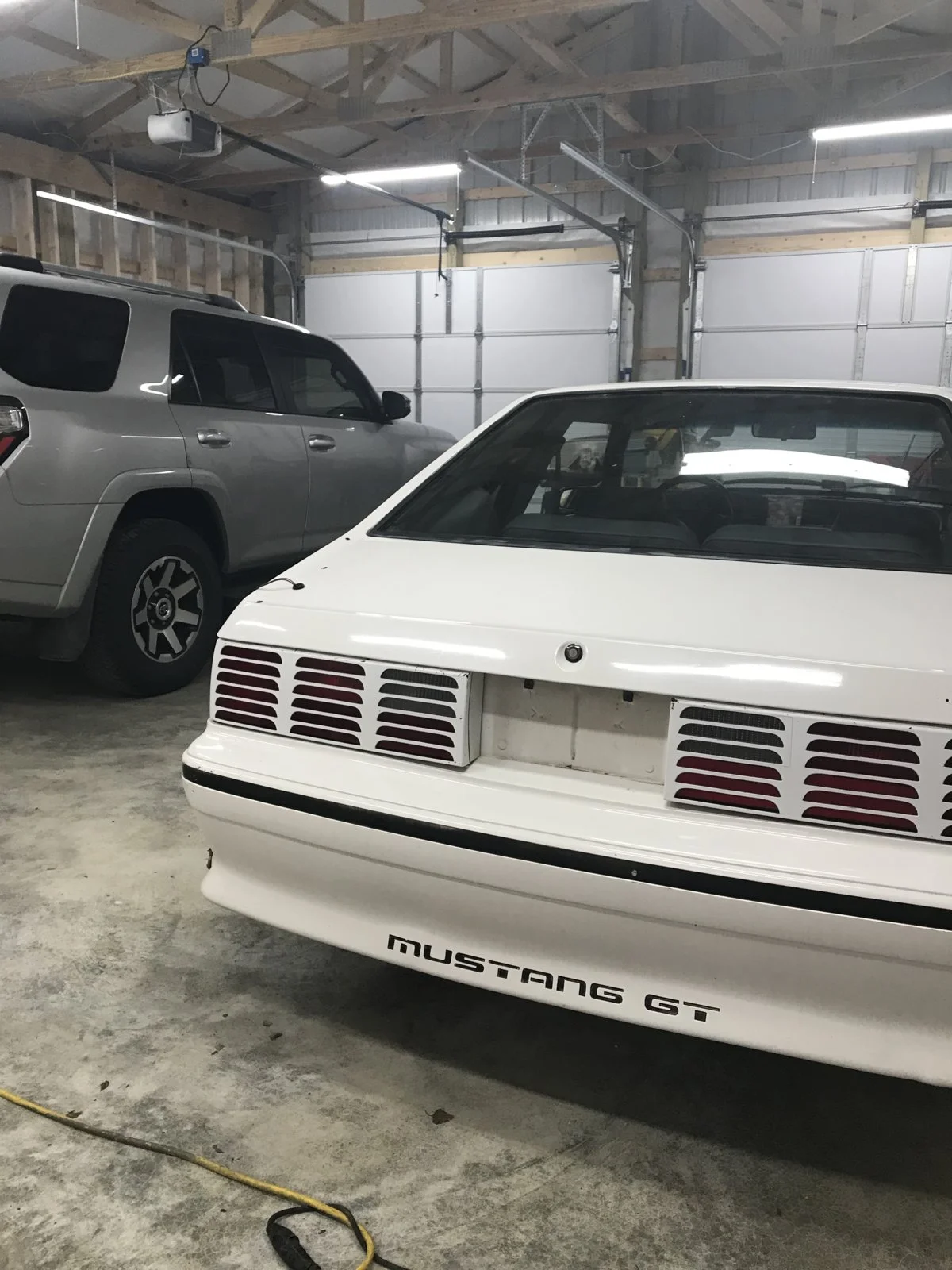

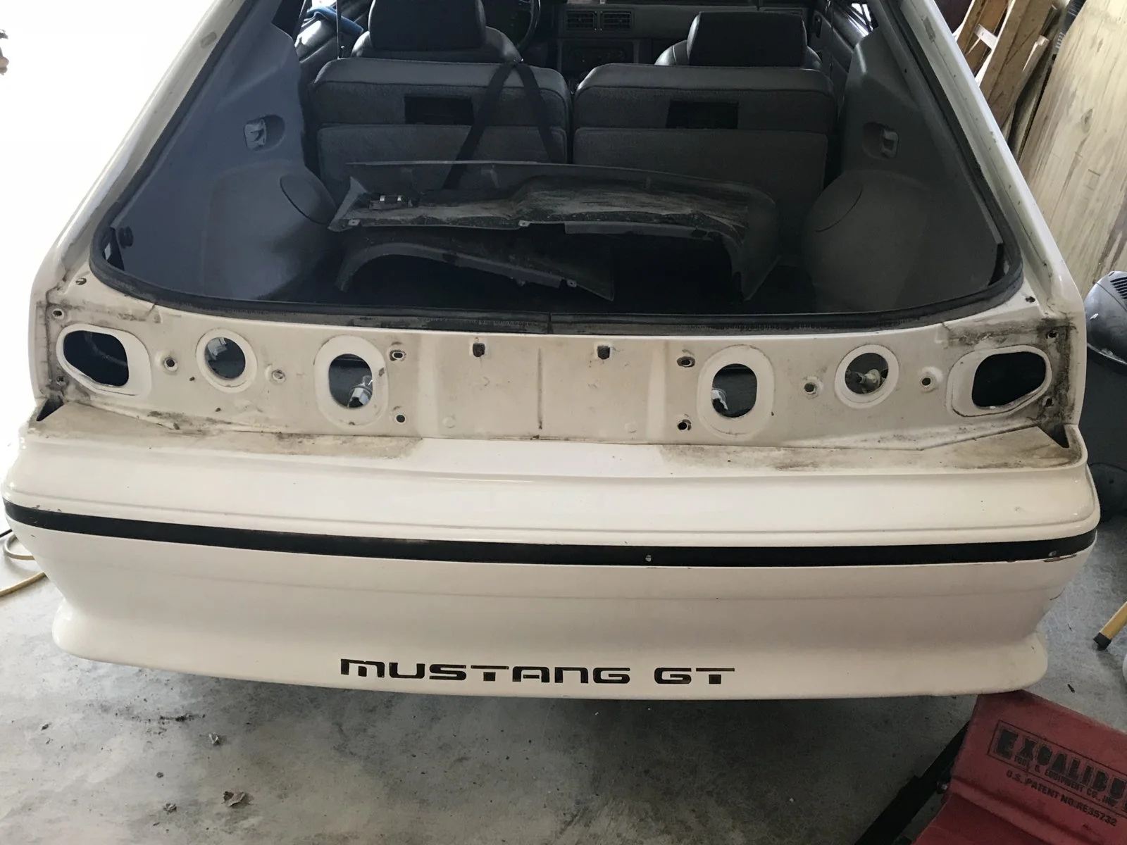

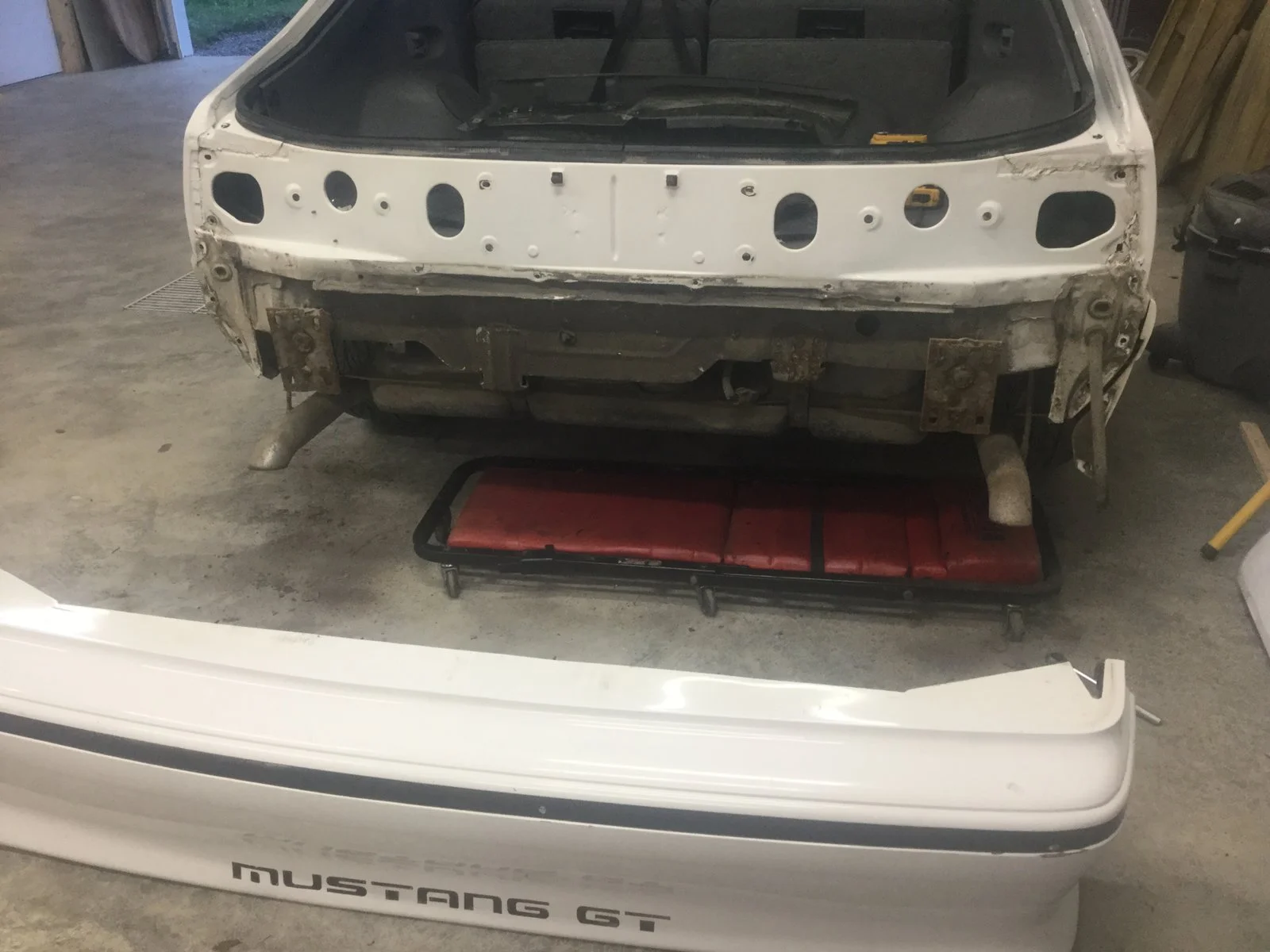

Yep, I think I’m the only one who put LX tails in a GT. Just kiddingJust doing some extremely minor disassembly for cleaning purposes. While the cheese graters are out, I think I will do something that’s never been done before. I think I will be a pioneer and see how a set of LX tails look on my GT. Once you guys see that, everyone will be doing it. lol, anyway, I’ll get all these bulbs swapped over to LED, and I’ve got a pair of lx tails on the way. Just doing tiny projects for now because the garage isn’t ready for anything else for a few more weeks. But having the car inside and room to tinker with it feels real nice.
