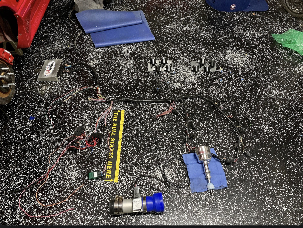

I have pro-m system I haven’t installed yet. Been meaning to but I bought it used and it came with the universal hot rod harness, and was set up for COP which it came with everything. Harness, computer, coils, flow through tube, etc etc. I would need to order the correct harness for my 91 as I’m not a wire guru and would have no idea how to make that universal harness work for my car. I’ve had it for awhile but never gotten around to it. I thought about selling it, maybe going Holley but just got to a point where I want to get my car figured out with some current issues then decide what I want to do ecu wise. As mentioned the group I follow on FB for pro-m seems to like the set up but it does seem to be nit picky unit, but idk much about after market ecu’s or tuning so maybe they all are!!
