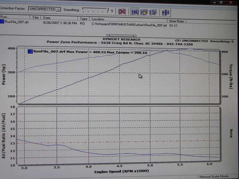

I'll get the chart up as soon as I can
Chart's up.
My low end definitely isn't where I want it....but my top end pulls like a raped ape.
What do yall think?
also, I'm still trying to get this meth injection kit tuned right. you can see at about 5500rpm where it starts to dip down to 10.7 or so....It's a work in progress

Well ... 300#'s@2900 ... 340#'s@3500 and 365#'s by 4K ain't shabby :)
Did you do a dlog during the pull :shrug:
Just a thought :scratch:
If you run the j4j1 ... might the fuel dip at 5500 be around 90mph where
the fuel enrichment function does it thing :shrug:

ya know what?....I'm glad you said something about that...I completely forgot about the high speed enrichment. Right around there would be where that enrichment comes in too...hmmmmm...guess the meth injection is injecting sooner then...
I've really gotta wire up that led that lets me know when its active lol....d'oh.
I did a datalog on my last pull...but for some reason it didn't save to my hard drive..another d'oh.

sorry for the novel here...but looking at the curves...does anyone think there's any kind of a bottle neck anywhere? I'm still trying to learn the ropes of reading a dyno....I'm a newb...

actually, I was doing a gear calc thing..and my high speed starts at around 4400....which means....time to go back and retune it without the high speed enrichment.
about how much of an a/f point would you say the enrichment adds?
I could not say cause I don't know how you got your fuel table and
higher end of your maf curve setup.
The function is a multiplier of that value thus making it fatter after
90mph if you run the j4j1.
Grady
