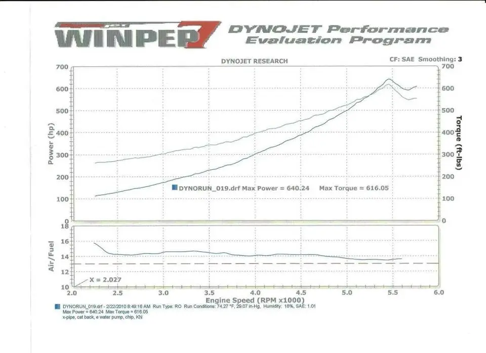

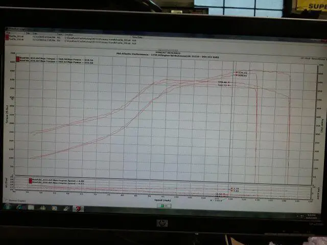

lightblade said:
Found your graphs. You have almost no power band/spool its like you dont get full spooled till 5000 rpms no boost curve though. Looks alot like a centi supercharger graph. Very weak for a twin trubo setup to say the least.
http://www.stangnet.com/mustang-forums/808244-twin-turbo-mustang-dyno-results-yep-its-me-d.html
My car is setup from the highway...and actually a built motor which I do not have yet. I dont care about instant torque on this car...when I want that, I jump in my cobra. Besides, ever hear about a little thing called brake boosting? Also whats with the focus on a twin setup? I can make an almost identical power curve with the right sized single...twins has nothing to do with where my power "should" be.
lightblade said:
So your saying your car is setup for the track? Is it stick or auto? Ever run it down the 1320?
I bet it cant even make full boost in first gear.
You dont have enough motor to spool that setup which is sad since its twin turbos.
That looks like a setup you would see 400+ cube motors or that run 200 shots of no2 down low to get the turbo's spooled.
The lack of back pressure after the turbo's as your piping is so big and free flowing, that combined with .96 ar is why your setup spools so so slow. At your boost/power level a turbine housing swap will not effect peak power at all. I would swap both turbine housings to .68 ar. You will make the same peak power but also increase power band and spool and the car will be alot faster.
Nope it is not...its setup for the highway rollons. Stock 3650 with spec stage 3 clutch...stock rearend. Only took it with my old exhaust setup @ 550RWHP and street tires. 12.0 @ 125 @ 12PSI. I ran it to check the trap....which seems to have bested your 3V when you ran it making 550RWHP @ 12PSI, plus your much uber superior spoolup and torque curve. You make it sound like my car is useless and makes no power. If I wanted to go for an ET, I just need to leave on antilag with slicks and it would stay @ 14PSI the entire run...but my trans and rear will not hold up to that...thus I baby it at the track.

BTW to the op its not all about peak numbers its about power under the curve. This is how a turbo graph should look full spool/boost low in the rpm range and hp/tq that holds up top.
Whos graph is this? Hmm how much did all the extra power help you at the track? 3 tenths faster than mine..but wait I had a 2.0 60 vs your 1.8....all that ET was simply from my purposfully weak launch and resulting 60'. Very little was from power under the curve.
To the op sorry to gunk up your thread, that new manifold and tb/elbow should peform nicely. I love to see custom turbo setups, it just seems to me your leaving alot on the table right now.
Thanks...the system will perform as planned once I throw in the built motor. Its designed for 1000+RWHP...im simply running it as is to do things noone else has done. Before I buy the motor, I wanted to prove that the whole "stock motors blow past 450RWHP" theory was not accurate. I run around @ 509RWHP and thats my lowest setpoint.

tank_567 said:
Hey All I asked is how he was making that much HP on a stock engine over a built one, I did not need a lesson on a turbo from hotmustang331,Plus I just started to get into my turbos power band around 15lbs of boost b/c it was unable to hold 12.5lbs and always dropped below that after hitting peak boost @ 4000+rpm. Good luck with the eddy intake im leaving the thread alone enjoy.
You asked a question and I answered it. You asked how I made more than your stock motor and a whole list of other cars with built motors with all their turbo specs. Please dont try and act as if your asking how my engine is handling the power...you were trying to figure out why I was making more at a given boost.
If you dont want to learn, thats fine, if you dont have anything to add to the topic, thats fine, but dont ask a question and then bail without even a thanks, while acting like you didnt need the answer in the first place.

Ha thats funny how im running low 11s on street tires(that was on stock rear ) w/ 100 less hp(450rwhp)and only 3mph slower...hmmmm So if you want I just got another stock bottom end from a friend really cheap and installing in the next two weeks. You want to meet up down at mustang week and run them and see whos turbo kit is "efficient"? OH and I will be on stock heads/cams as well. BTW you will be running a VERTon a stock t45 as well. I love to crash cars w/ 100-200 more hp than me its fun good luck with the built THANKS of the lesson!
