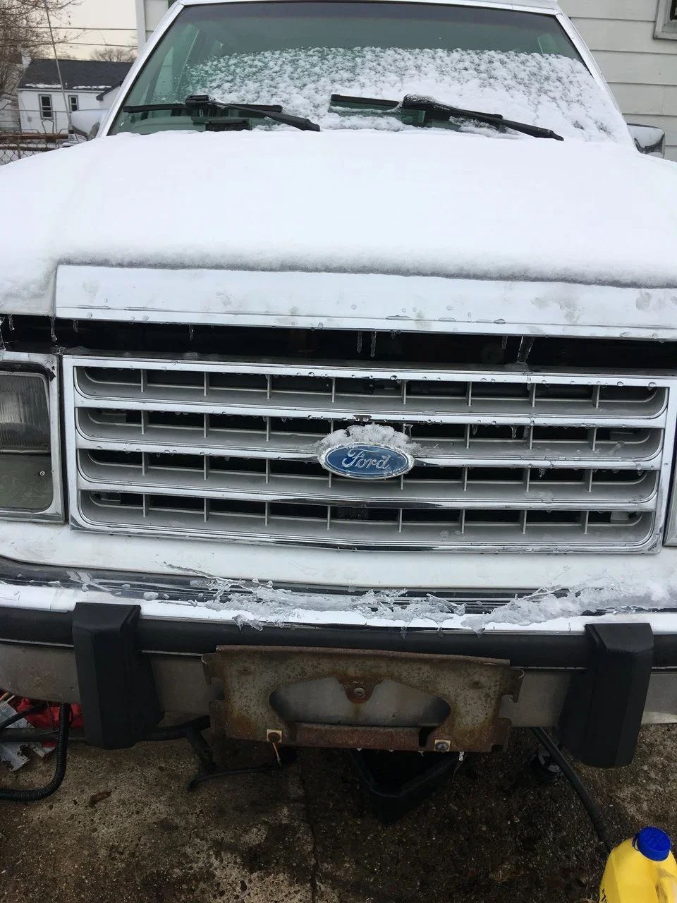

I was completely wrong about the weather. It is freezing outside and there is snow and ice everywhere here in the Philadelphia area. Daddy doesn’t have a garage and cannot work on the Daddywagon. But I can do little things like buy oil and coolant, and finish hoses on the fuel rails. Above 30* and I will be right back out there! Haha!

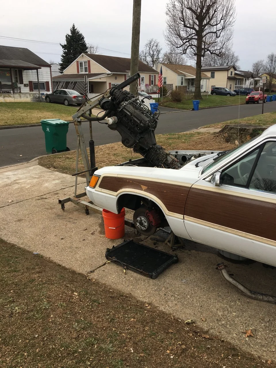

I did bring my flowmaster catback to work and used the company chop saw to cut the tips off. The 302 that was in the car has an oil control problem which means lots of smoke. Exhaust tips were pointed straight at the rear bumper, so I cut them off and will replace them with turndowns.

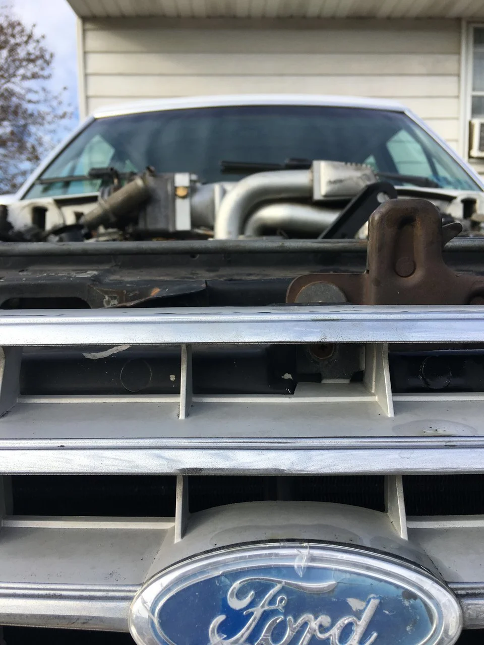

Alright. I have issues. I have an exhaust leak between r/s header and h-pipe. I can hear the valvetrain. They are cobra roller rockers and I’ve read about similar issues. I had no idea where to start with timing so I am at 12–13 btdc. It runs and idles ok even with the exhaust leak. My biggest issue is coolant leak between water pump and timing cover. Maybe between pump and that stupid plate. I disassembled and regasketed and tightened everything and it is STILL leaking heavy. I am going to have to take the whole thing apart again!!
