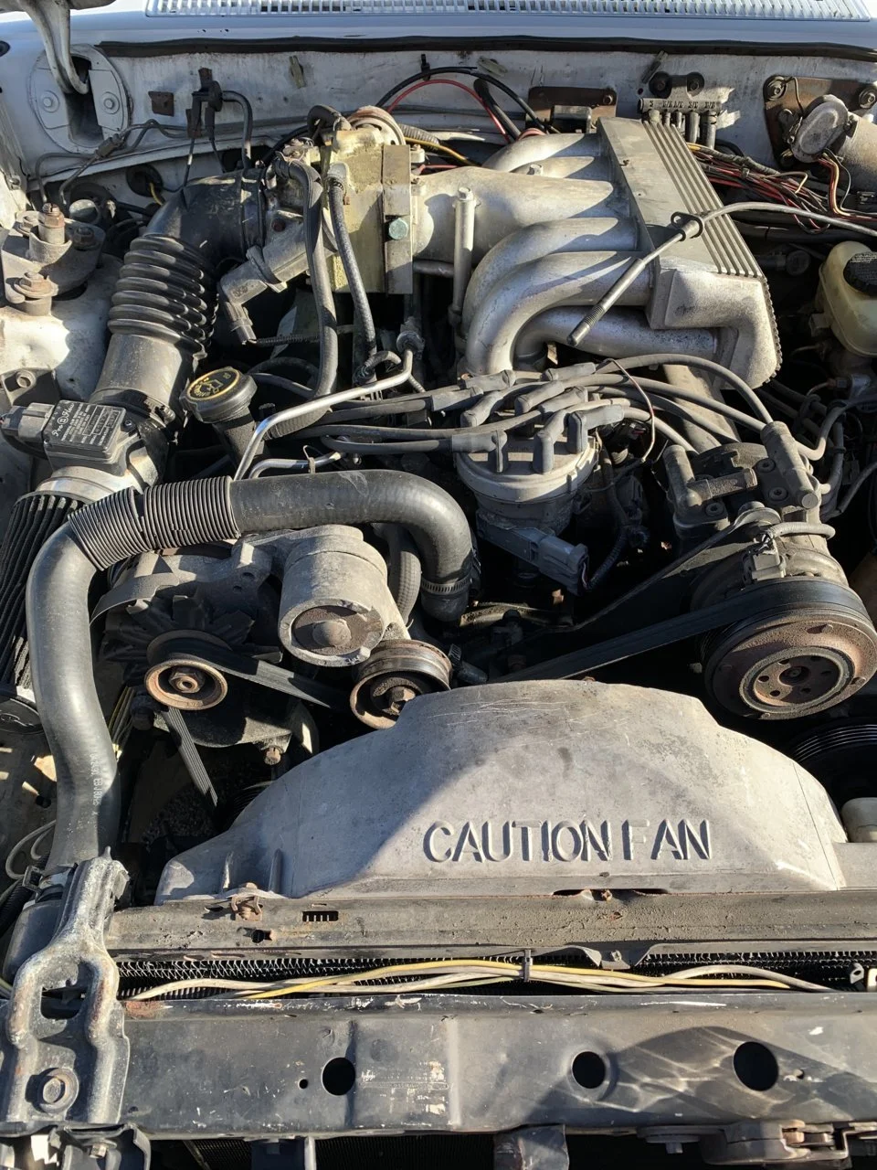

Well it’s almost a year ago that I posted that. Gonna scratch off 2 and 4. I really want 1, 3, and 5 now. If I can find a t56 that would be awesome. A higher compression shortblock that I can still run 87 octane in would be fantastic. And clean new paint on a straight body would be the cherry on top!! I’m gonna put a new list up.My list tentatively is
1. 6 speed
2. cobra r brakes
3. long rod 351w (I don’t care, I’m gonna try it.)
4. hood scoop (the engine is currently rubbing against the banged up hood)
5. overall cosmetic restoration

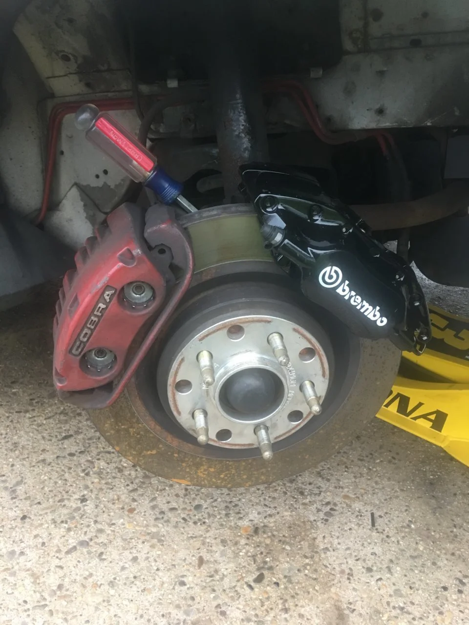

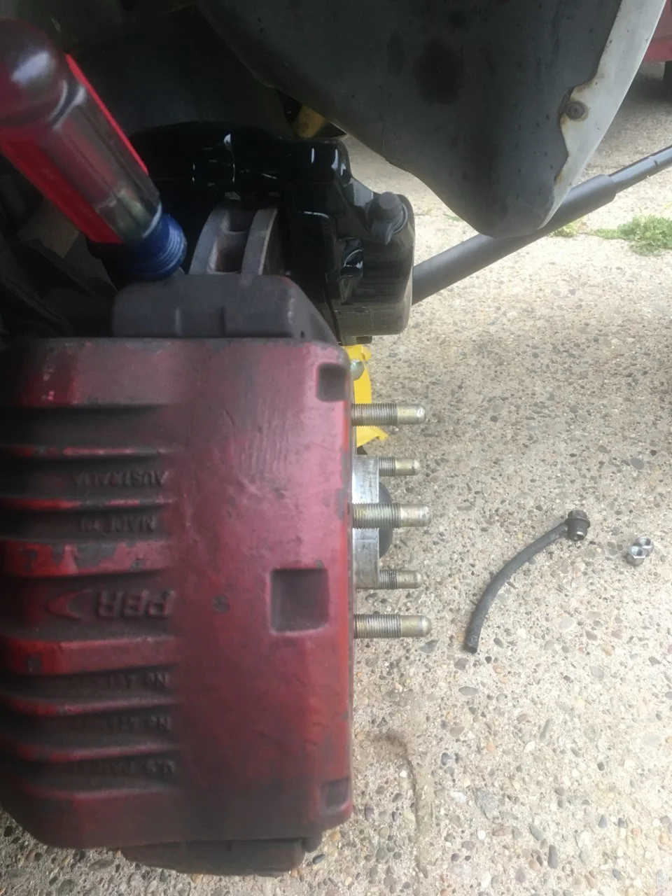

Where are you located. I know a place that has f4te blocks for $150Assuming the 3/4 spacer does the trick for my brembo brakes here are my current wants. I have some of what I want on my list but I have yet to install.

I am located in Levittown, Pa. but at this moment I do not need a block. I have most of what I need for that engine build already. I have block, crank, rods, and pistons, and camshaft. I just have to get all the machine work done then assemble.Where are you located. I know a place that has f4te blocks for $150
