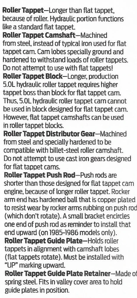

Always be mindful of the pitfall regarding oil pump/distributor drive gears. Roller cam equipped uses steel gears, plain tappet cam uses cast gears. Slipping a non-roller cam distributor in a flat tappet cam engine will result in the distributor gear being "eaten". imp
I would think by 96 all 5.0's would have roller lifters,
Trucks w/5.0 used non-HO camshafts, flat tappet. Where the "breakpoint" came in them, if at all, would need verifying. The gear problem is documented in Ford Motorsports Catalog, which I'll try to find and copy. imp
My searching has only roller lifters used in 96 f150 5.0
It is non ho but it is a roller lifter engine
Here is an excerpt from Ford Racing: (see Roller Tappet distributor gear heading)
It was scanned from:
