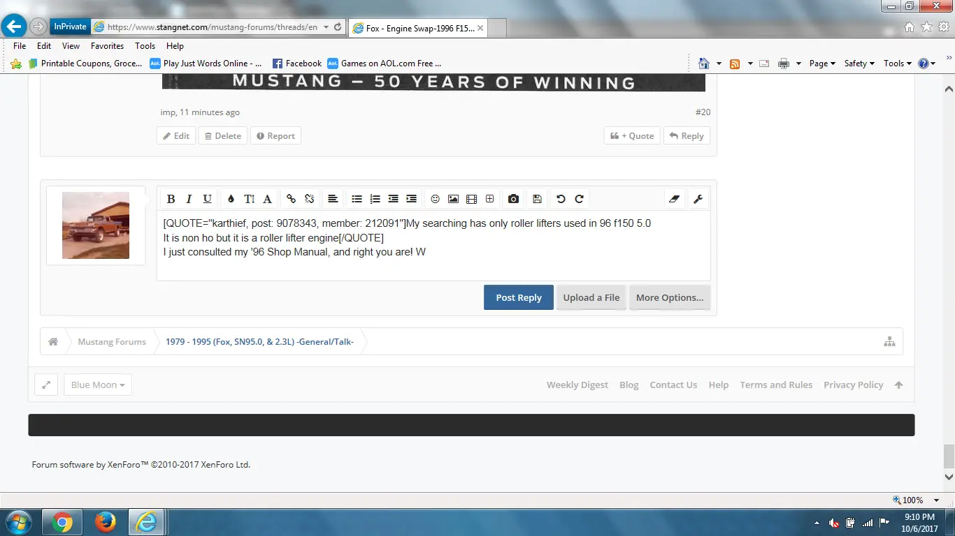

Something weird just happened to my post, where I pasted comment copied from afar. Sorry. Just trying to help others avoid the heartbreak of distributor gear failure.
@karthief
To clarify my mis-posting:

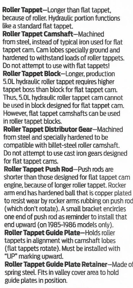

"Starting in 1988, the F series 302 engines were assembled in the Cleveland Engine Plant, right next to the Mustang's 5.0 H.O. engine, and in fact used the exact same (roller) block. However, even though the trucks started using the 302 roller block in 1988, they were still equipped with flat-tappet non-roller cams and lifters through 1991." Quote from: https://www.f150online.com/forums/pre-1997-models/76897-info-5-0-roller-block-usage-trucks.html
See Roller Tappet Distributor Gear below:
Quote from: Ford Racing Catalog, 2014 edition.
