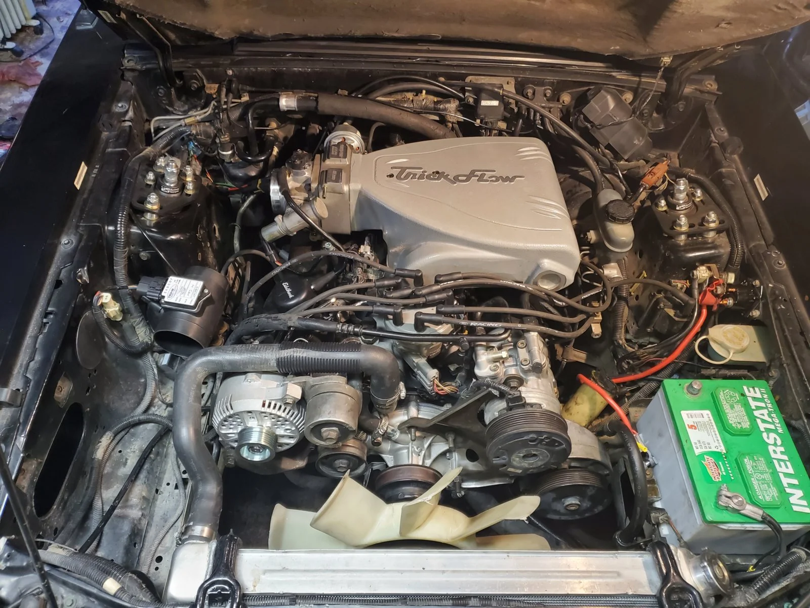

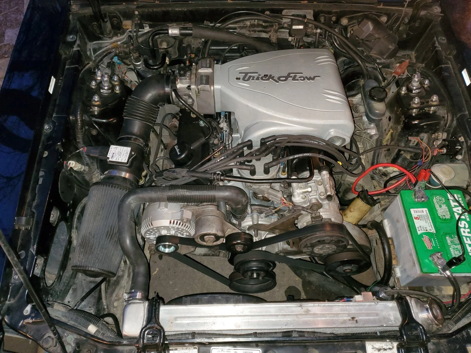

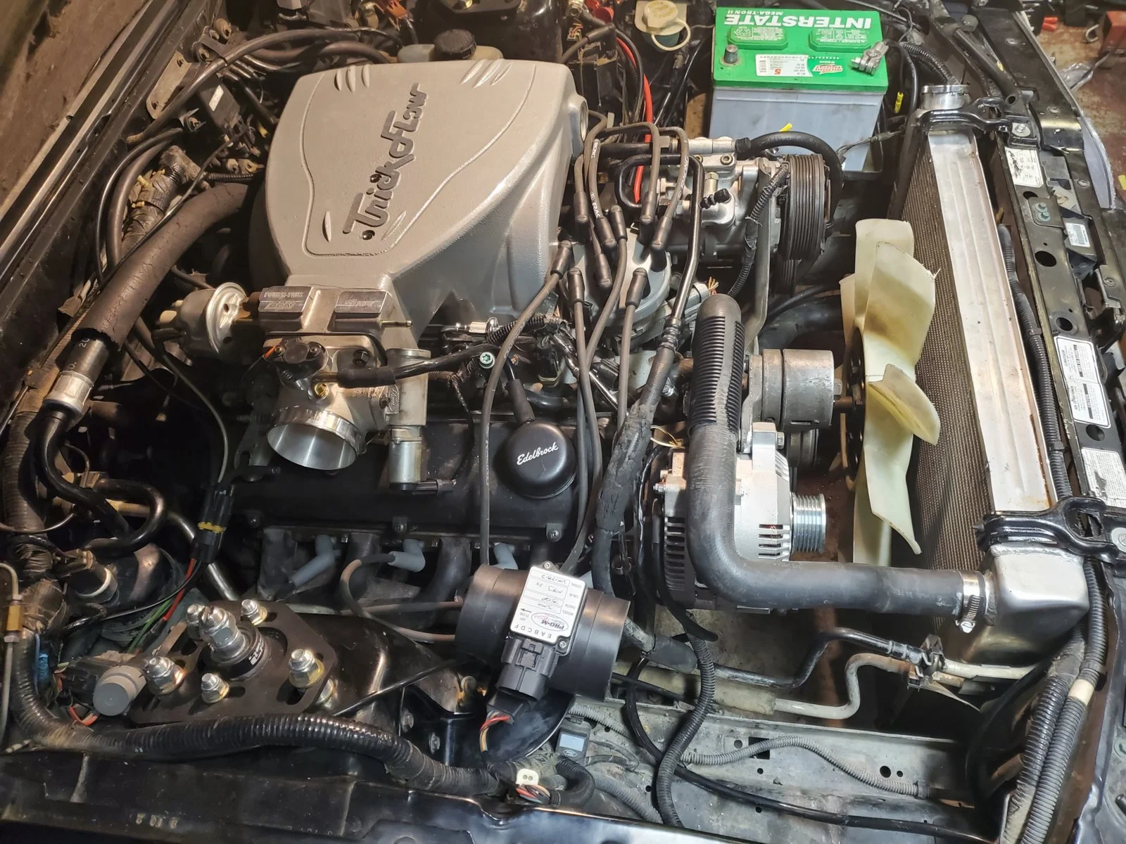

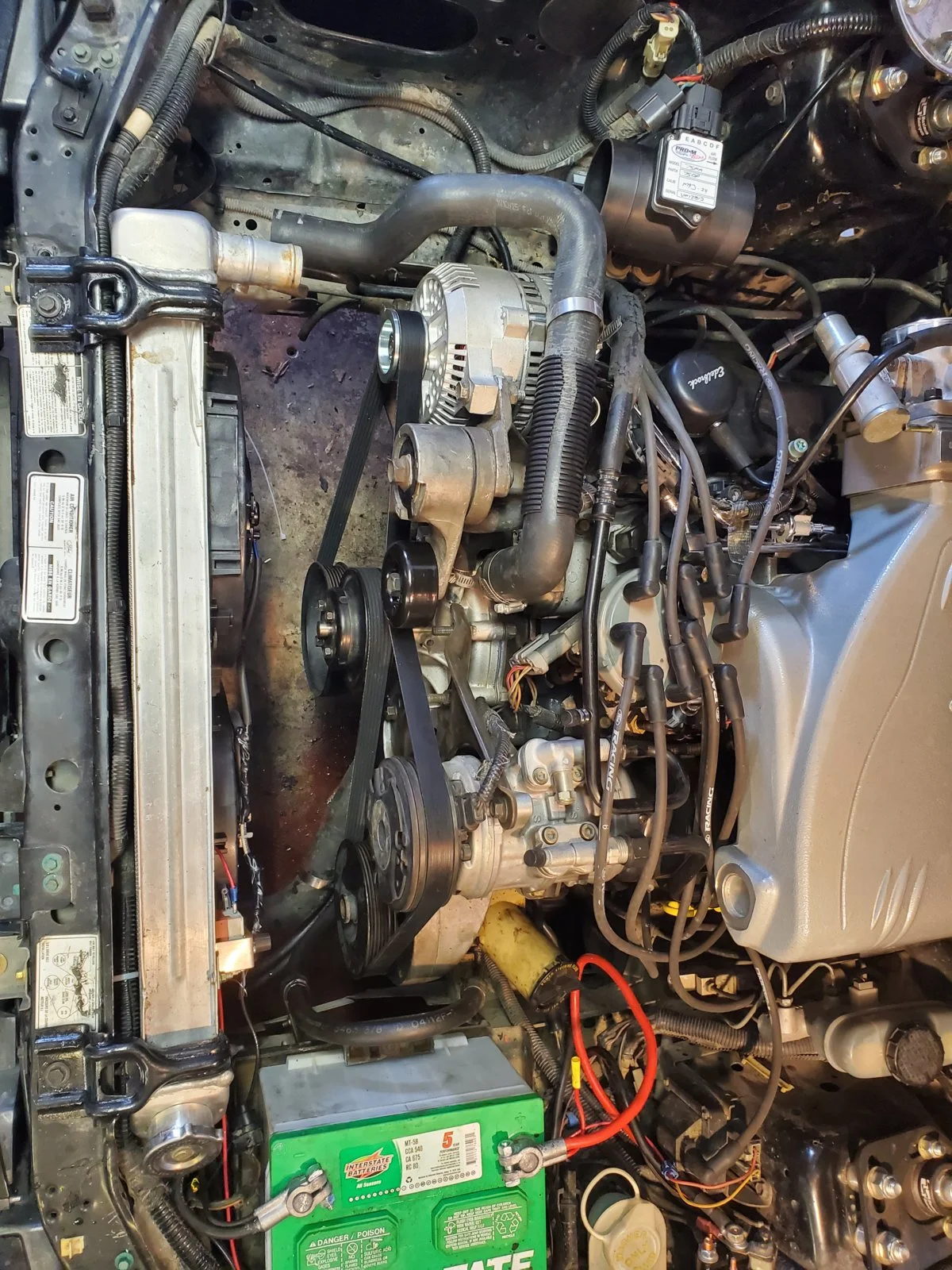

I will have to get some current ones when I get home. Here are some in progress pics. I have the TB and EGR off it and may pull the upper intake off again and re run the rockers one more time while I am this far in.

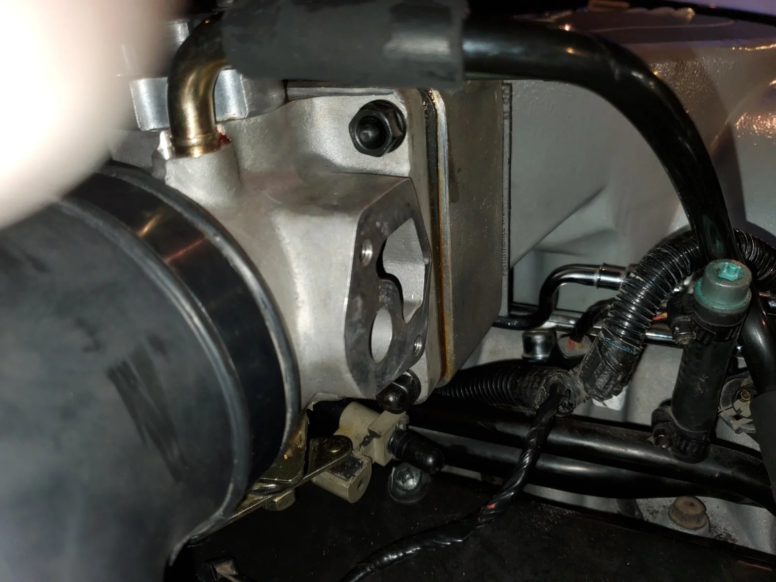

I did get some current pics last night. Also took one of the view that shows why the IAC does not fit right. Most of the aftermarket throttle bodies I looked at on google look like the IAC pad is spaced out away further but the pro products one is sunk in more. It needs the other style IAC that doesnt have the part sticking off the end. Not sure if ones of different styles work on the fox or not but I do have one from a explorer 5.0L that does fit but the plug is straight out the end and makes the wiring hard to get on. I did not try to use it though. Will try to clearance the stock one. Also see how pinched the stock intake elbow looks just behind the MAF. That is where I am worried it is bottle necking the airflow. I also had to take a razor blade and really shave down the inside of the factory rubber elbow up where it goes onto the TB to get it to slip up on there and it is still a fight to get it on.

That distributor still looks wonky and I would add about 4 to 6 inches of straight pipe between the filter and the maf, turbulence inside the filter will mess with maf readings, needs some distance to straighten out. JMO
I will look at it but it is timed correctly. The rotor is pointing at #1 at TDC and the timing marks line up at TDC. I can re index it and make the Module point wherever i want. As long as the rotor still points at 1 it should be good. I will look at it. And as far as the Filter that is how ProM's documentation suggests but I am looking at buying a stock airbox to put on it but need to verify that the exit hole on it is as big or bigger than the MAF opening. If not I cant use it.
