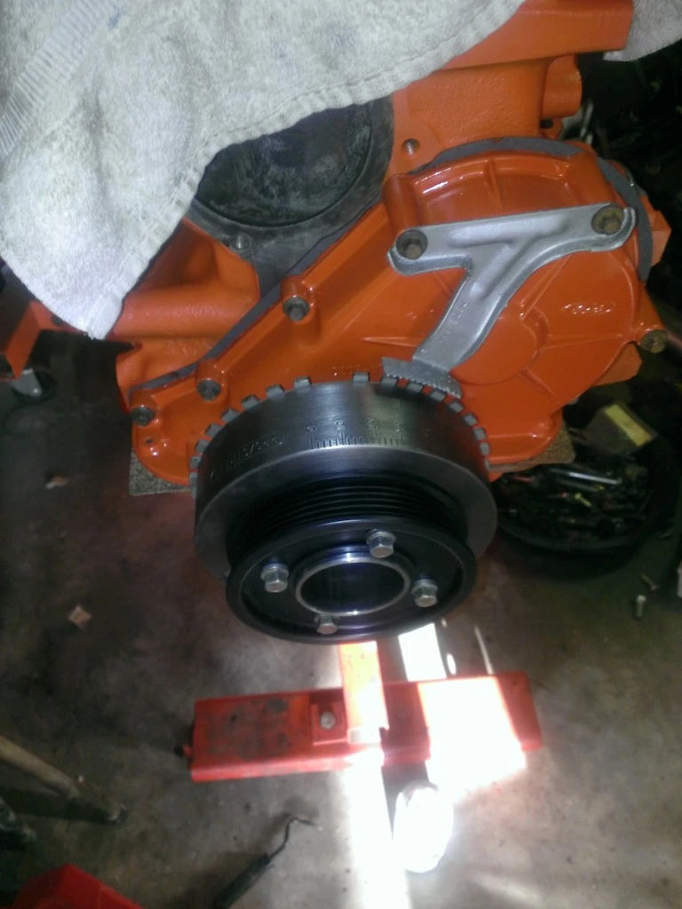

I called the shop I dropped my pulley and trigger wheel off at. He was apologetic but told me he can't get the trigger wheel chocked into the lathe.... something to do with the teeth on the wheel.
Now what? How the hell am I gonna get this done, he said he could cut the pulley down and then I can weld my trigger wheel to it, bit let's be honest here how am I going to make sure it all ends up correct? I don't have the equipment to make something this precise work. I wish I had a shop full of tools.......
maybe asp can make me one......
my guy made a fixture to cut the center out of my trigger wheel.. Hell, if you have the same DIY piece that I have, YOU can cut the center out of it w/ a jig saw.
It's the mounting, and truing part that requires a machinist.
So,..You do what I did.
Take that wheel and get it to sit on the pulley so that you can weld it. Drill holes through the pulley and the trigger wheel that will allow you to use machine screws that will allow you to move the thing around a little while you get the thing close. My trigger wheel overhung my balancer, so it was just a matter of measuring how far each tooth over hung while I shifted the thing around as I tightened the screws that hold mine to the back of my balancer. Once I got it as close as I could get it, I backed out each screw one at a time and red loctited them back in.
(this would be the part where you either replace the screws or not w/ some sort of permanent fastener,..whether that be locnutted screws, or welding,..whatever trips your trigger)
Then I took that assembly to my machinist where he chucked it up, and trued the circumference. ( I was .030 out of round)

I like it.
Now how about the balance? Did it throw it off at all?
I know a guy in FL with a plasma table. Maybe he can help? I still need mine done.
if he can't figure out how to clamp on that, you didn't want him messing with it anyway.
Take some individual pictures of the balancer back side and the timing wheel . The timing wheel should be laying flat side up and the camera perfectly vertical to the timing wheel.
With those pictures, we may be able to make some suggestions to help you find a workable solution.
