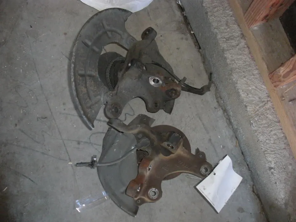

-94-95 Mustang spindles=$100 (used @ the wrecking yard)

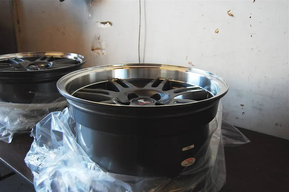

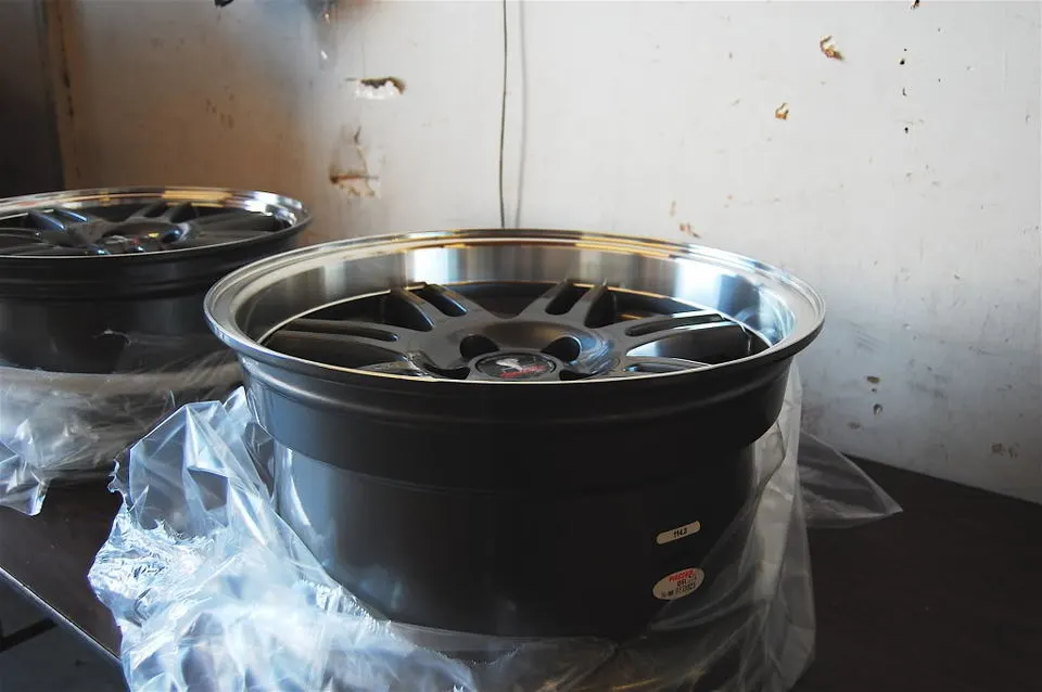

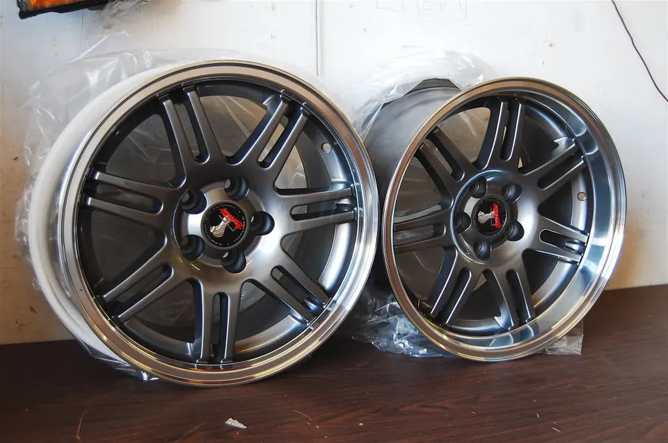

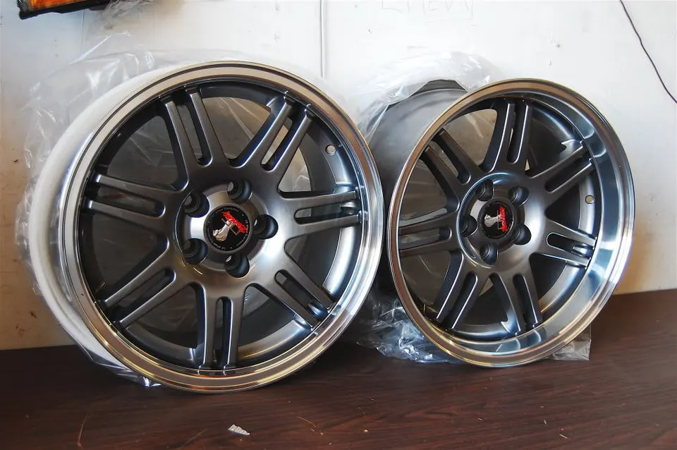

Deep dish 10th anniversary Cobra replica wheels....

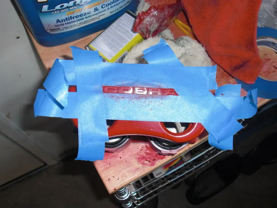

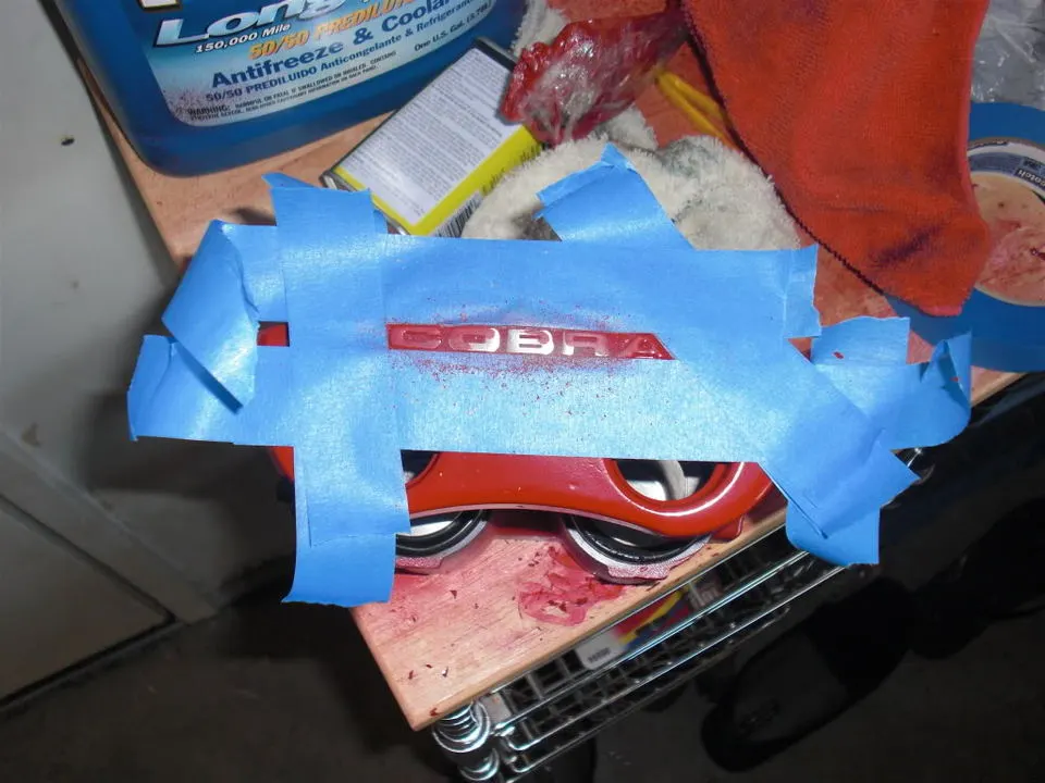

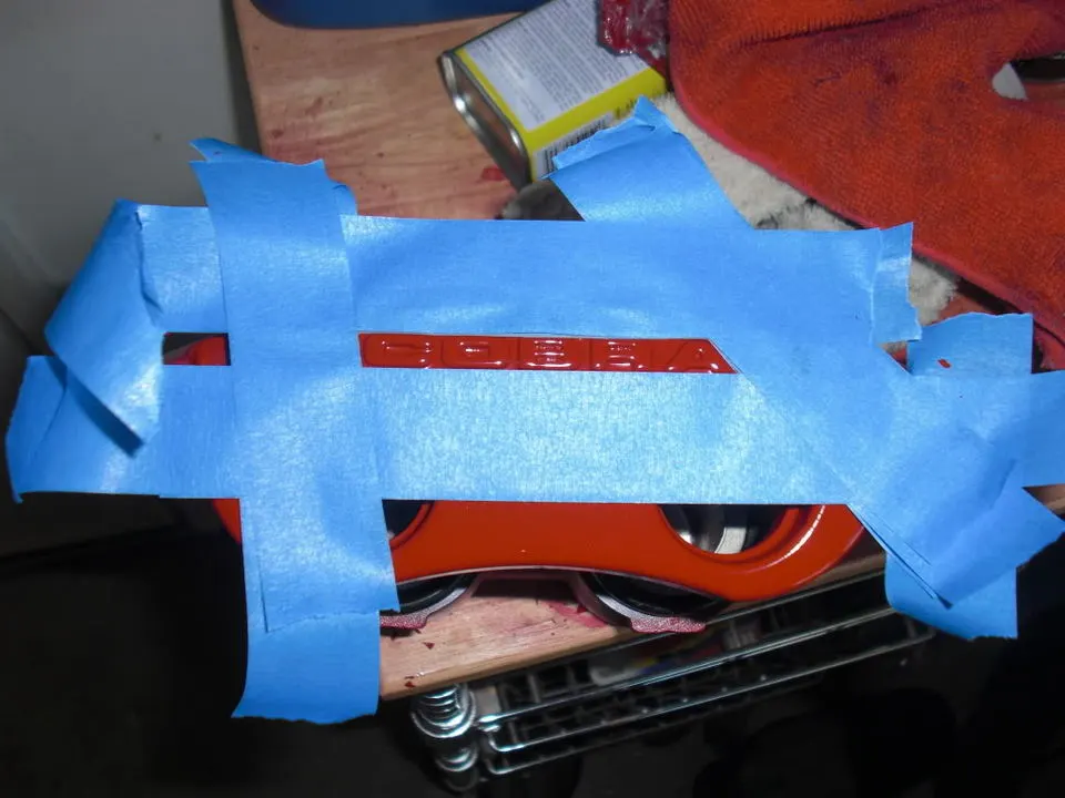

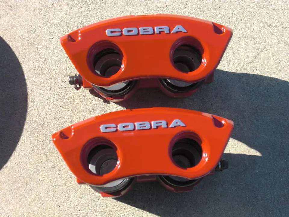

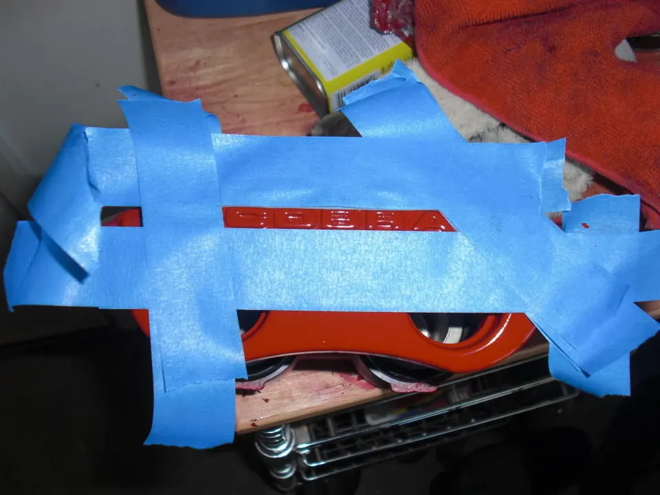

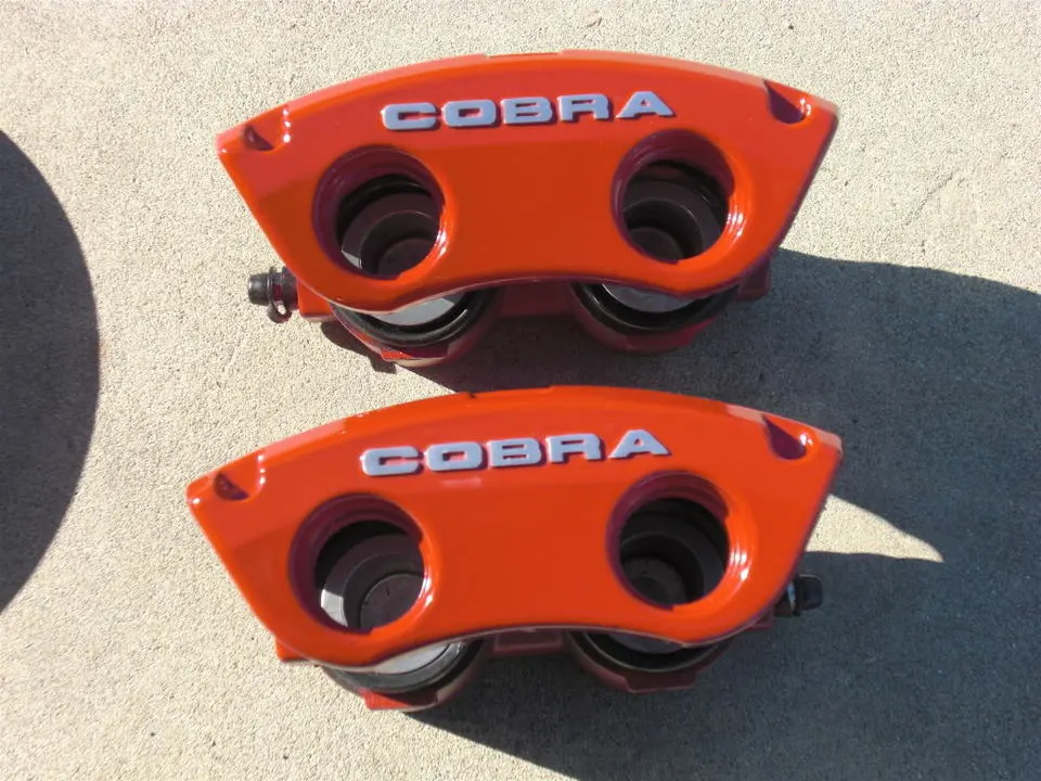

Cobra calipers. These came black, but I painted them with red Duplicolor caliper spray paint & then sanded the paint off of the Cobra lettering...Looks just as good as the 10th anniversary calipers....

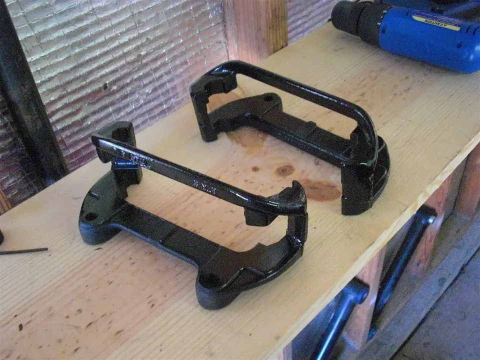

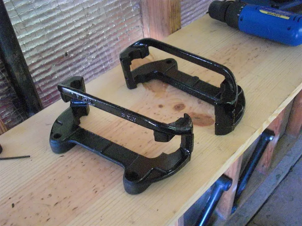

Caliper brackets after I painted them semi gloss black...

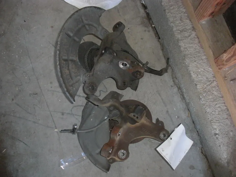

Used 94-95 spindles & hubs. Still need to clean these up & paint em...

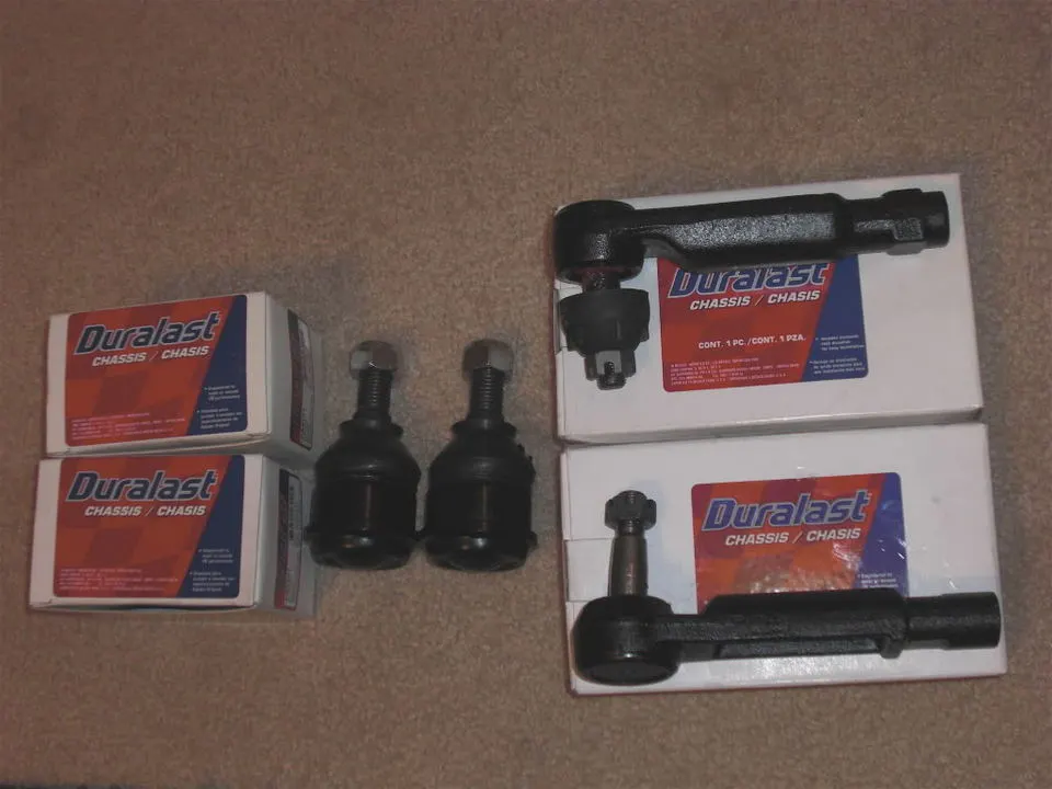

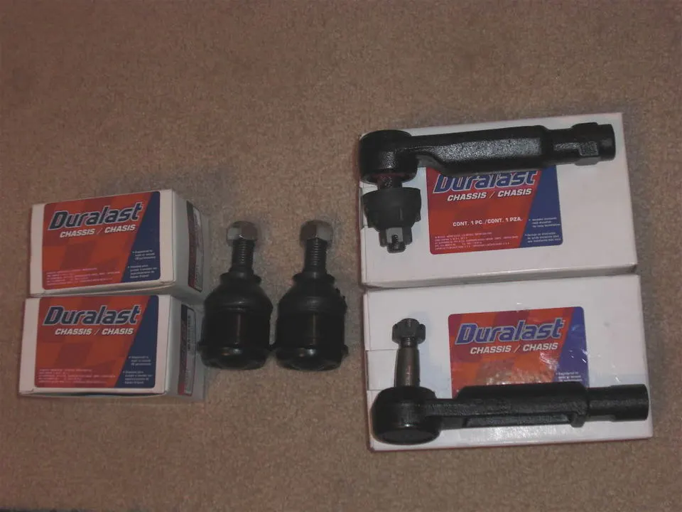

New SN95 ball joints & Fox tie rods...Figured I might as well do em' since Im in there & my chassis has 172k miles & who knows if the previous owners ever changed em....

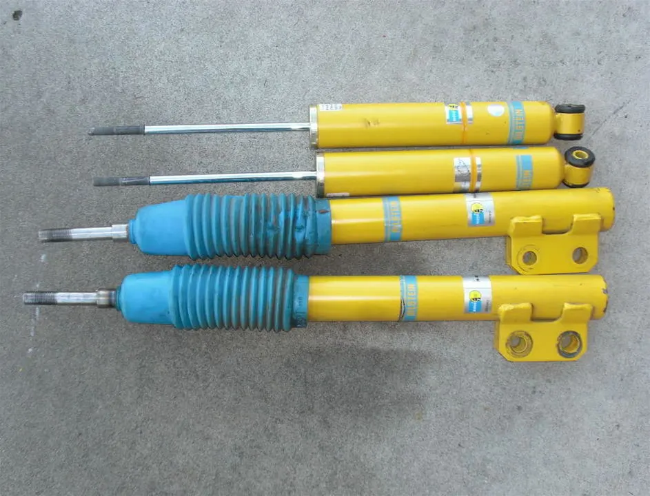

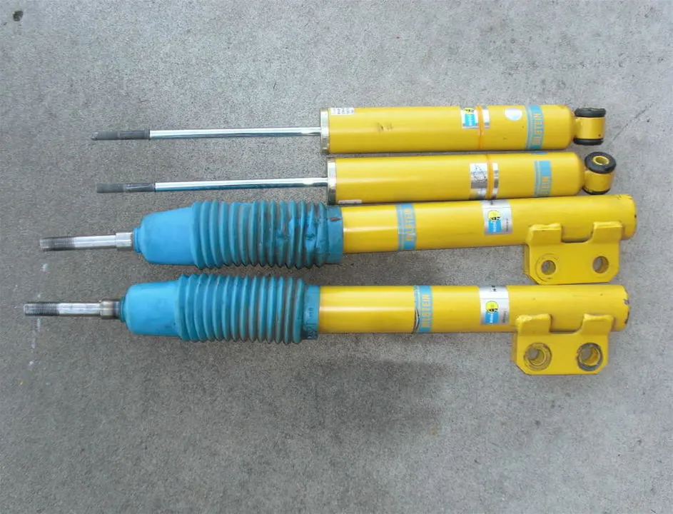

Bilstein HD shocks & struts....

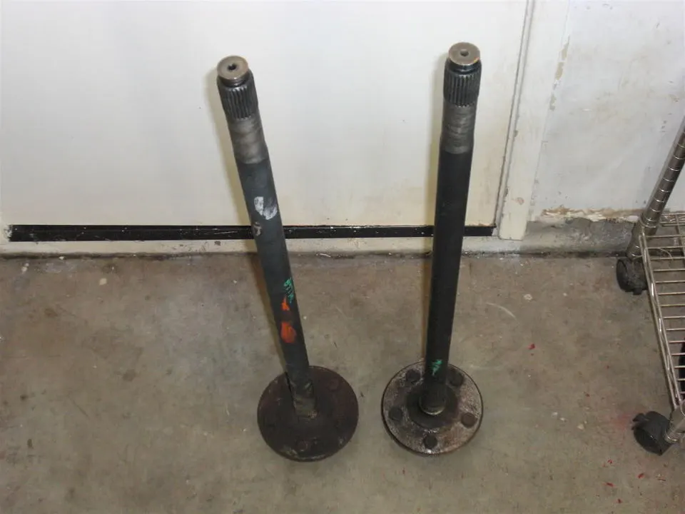

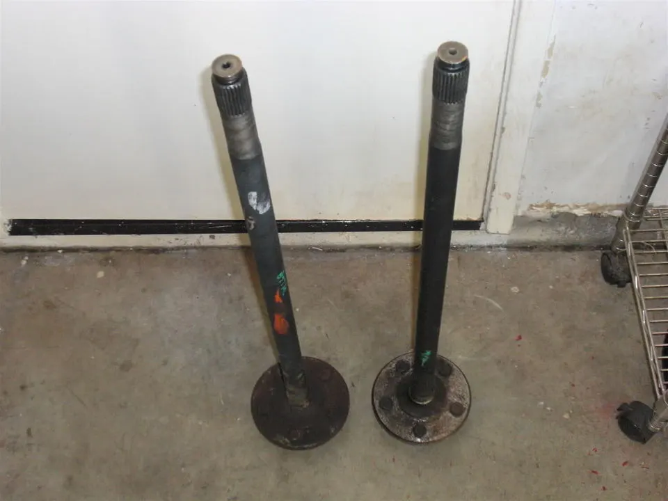

Ranger 5 lug axles....

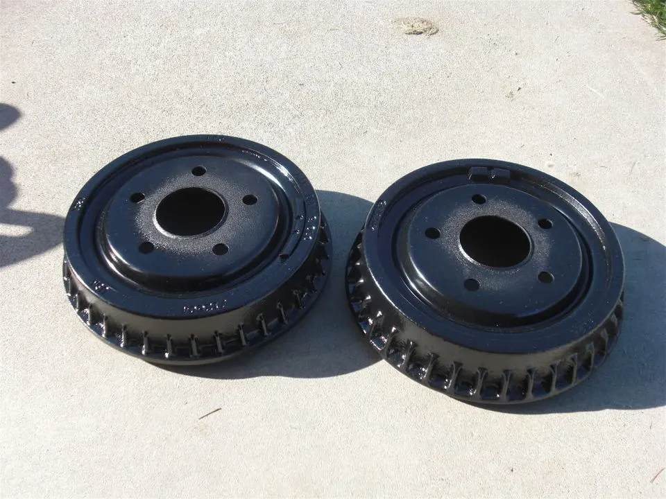

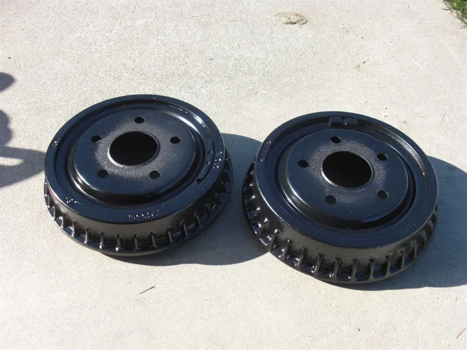

Ranger 5 lug drums Freshly painted with Duplicolor semi gloss black High temp engine paint...Yes I know discs are better & it will have them one day...

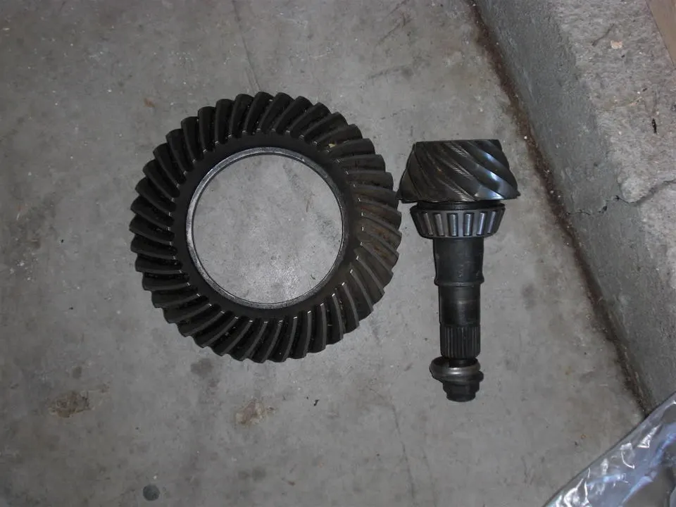

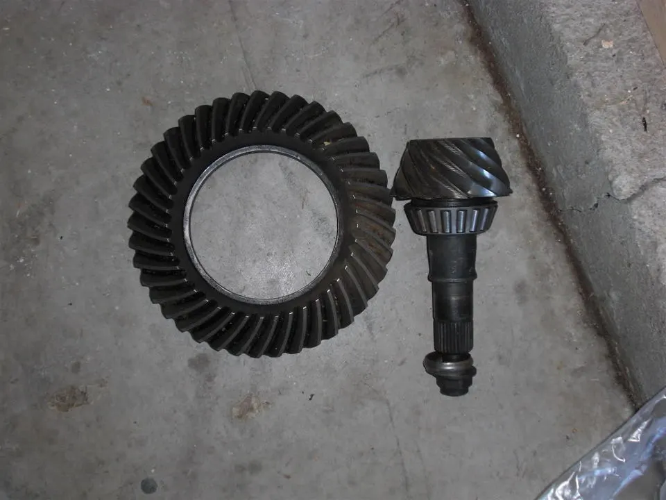

FRPP 3.73 gears...

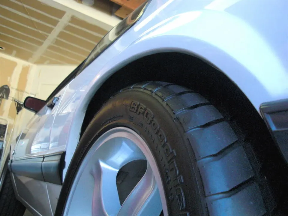

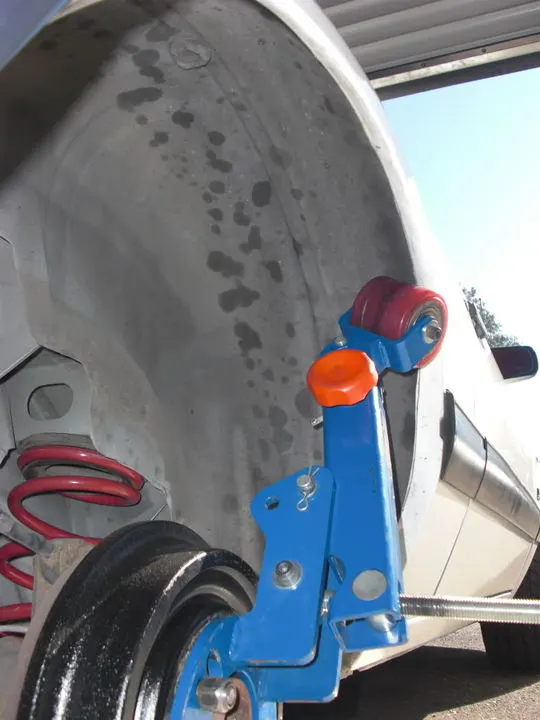

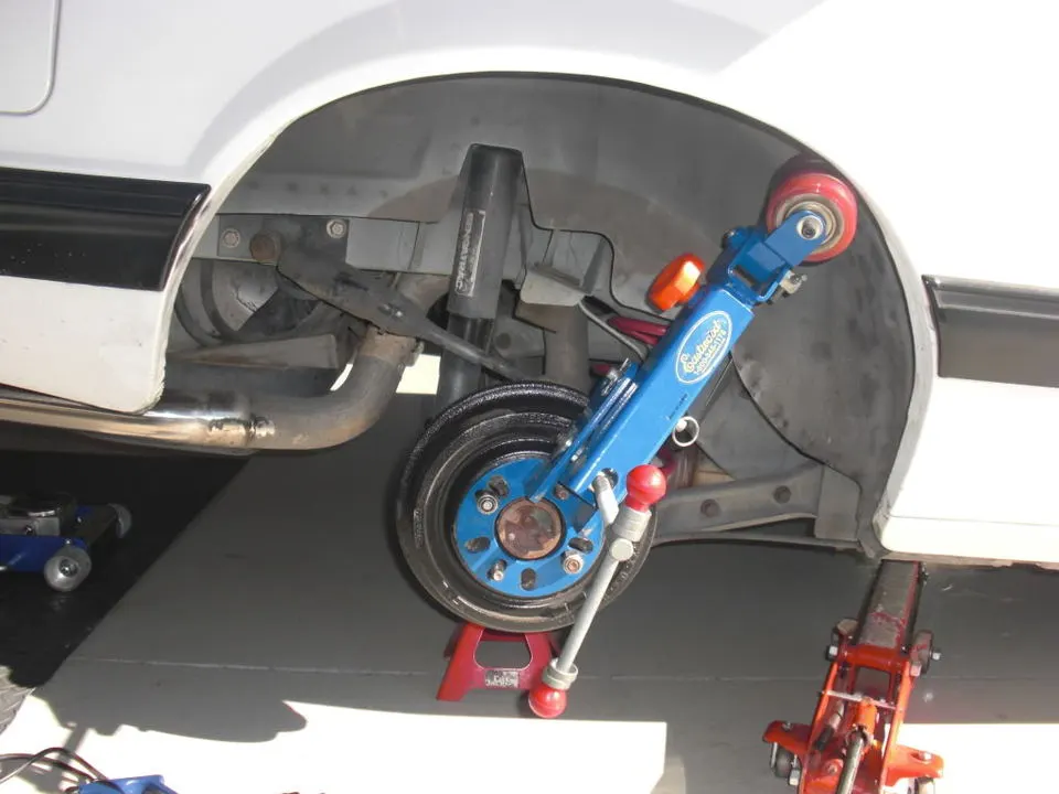

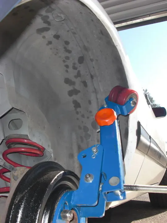

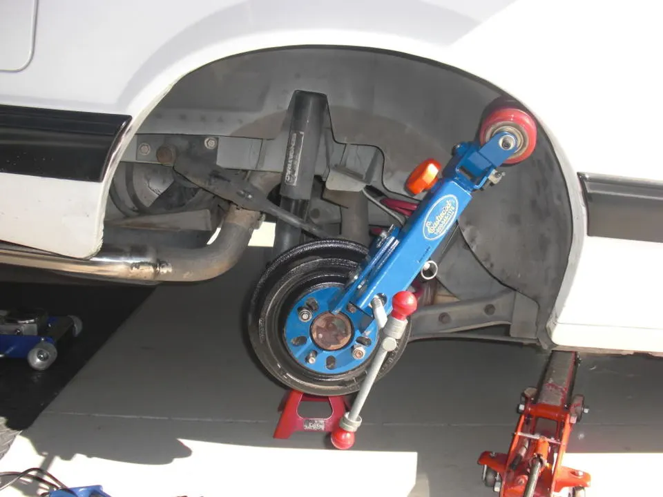

Fenders getting rolled....

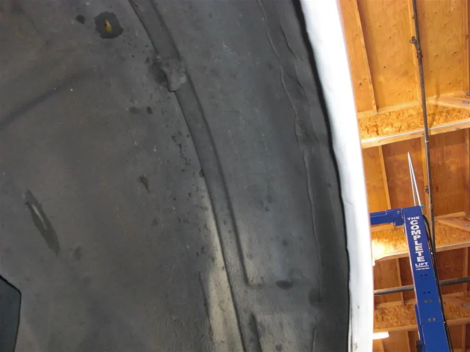

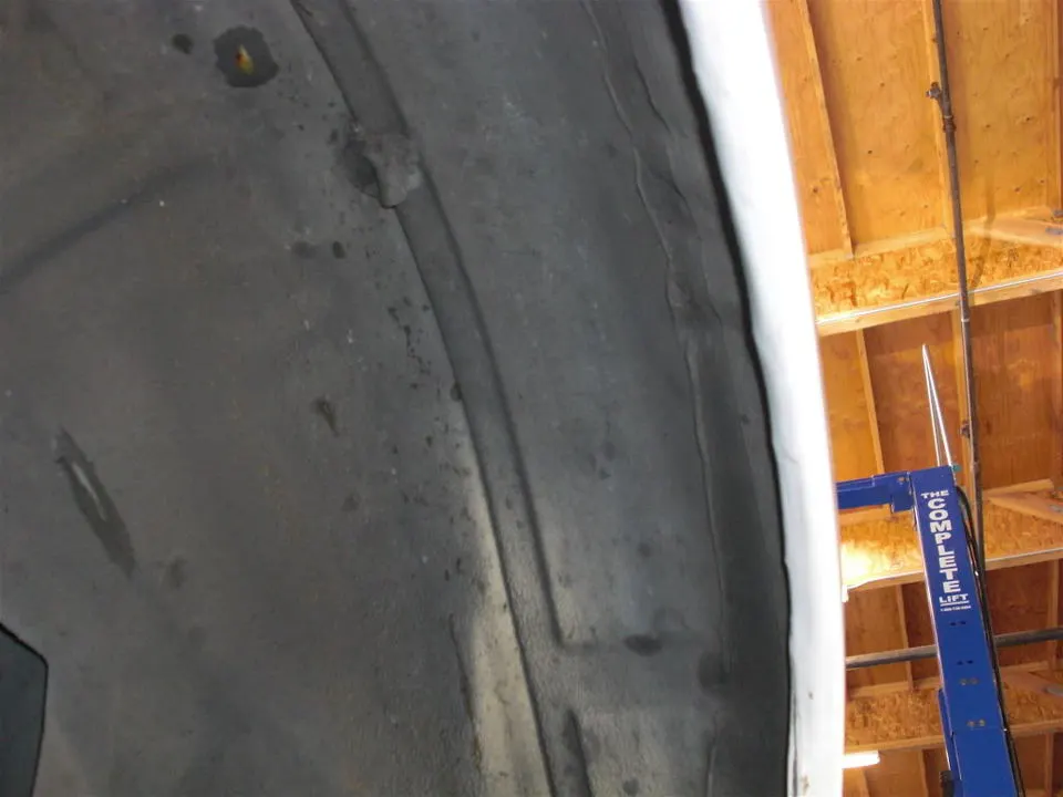

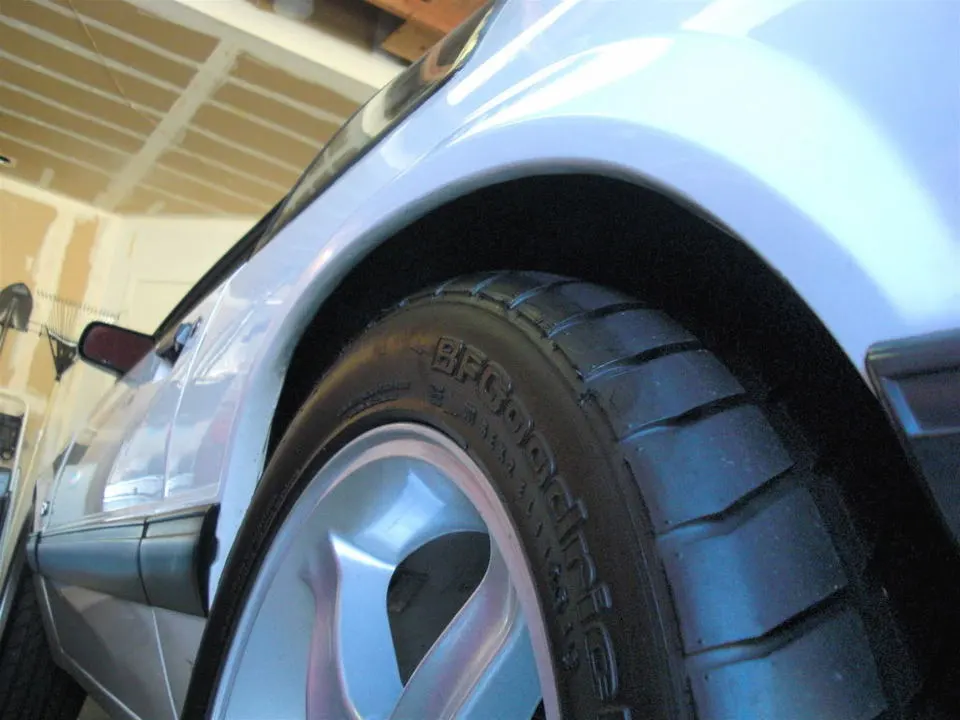

Final results of the fender rolling....

EPIK--That is a nice set of mods you are putting on the car. Did you buy that Eastwood fender roller? It looks like it works very well. Was it hard to crank around ane get the rolled? You are a guy who knows how to take some pictures man! Good job. Can't wait to see more!:D

Thanks man... I didnt buy the eastwood, I had it done by a local shop. I couldve bought the tool, but I would be afraid to use it on my own car... It didnt look too hard at all, but he did mention that Foxes are harder to roll than SN95's....

Looking good. Make sure those axles are straight.
I will check em out... I guess I really didnt think of that???
I just rolled mine this weekend. Used a rubber mallet and it came out the same :shrug:
Thats too risky for me.

Although your car looks good with the new wheels, that swap is very limited for wheel selection, & u dont get upgraded spindles or front brakes when u do it that way..
Where did you find DD 10th's?????????? Ive wanted a set for a while, but wouldnt since I couldnt get DD. Where, where, where????????? And do they make them in 18's ?
I got em from OE wheels on Ebay & they are only available in 17's currently....
