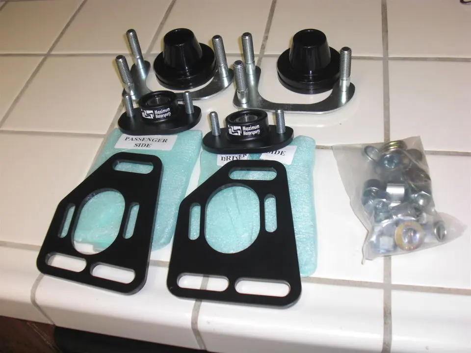

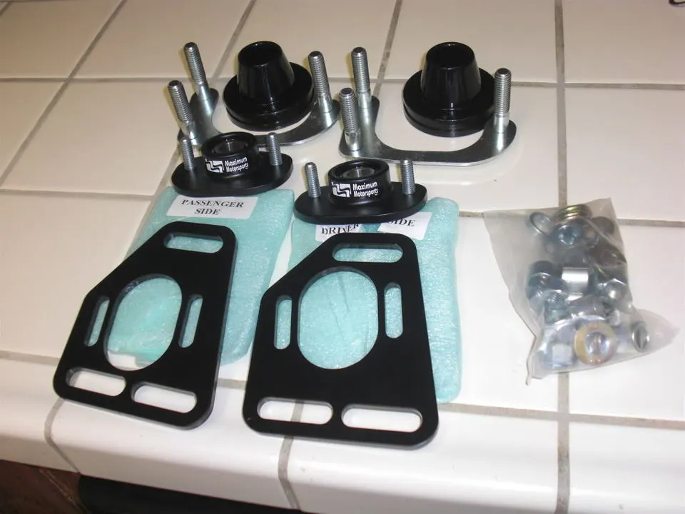

More parts arrived today!!!:D
Maximum Motorsports Caster camber plates....

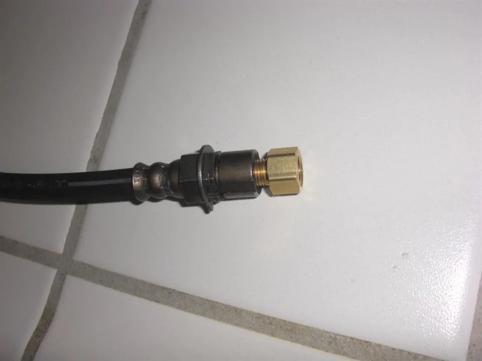

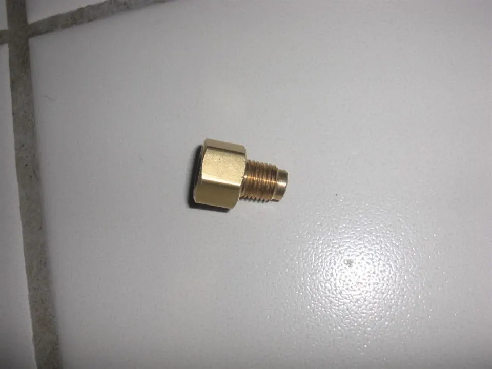

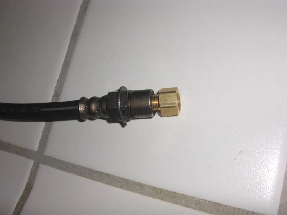

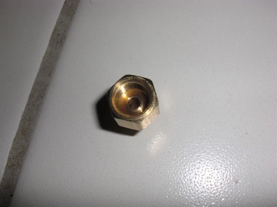

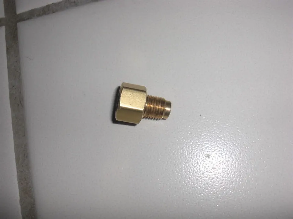

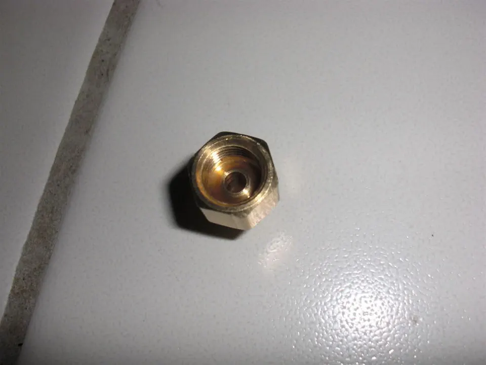

Another part that most dont mention when talking about SN95 front brake swaps is the Weather Head brake line adapter. It is for the passenger side brake line. The drivers side soft-line to hard-line attaches directly while the passenger side requires a Weatherhead 7828 fitting. I bought mine at NAPA for about $8.00 & it is a must have & something that will most likely be overlooked....
Weatherhead Fitting bolted up to the Cobra passenger brake line.....

I just found that out yesterday when I was hooking up the lines on an 82 GT Im putting the Cobra R brake package on. I cant wait to see your car with those wheels on it!!! When you think you'll be done?

I see you have brake lines. I was going to tell you to buy a quality flare tool if you have to modify any lines. Well worth the money....trust me.
