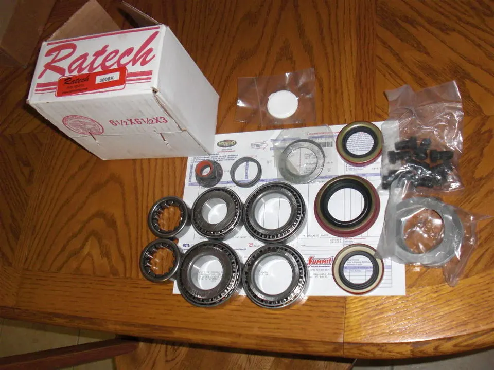

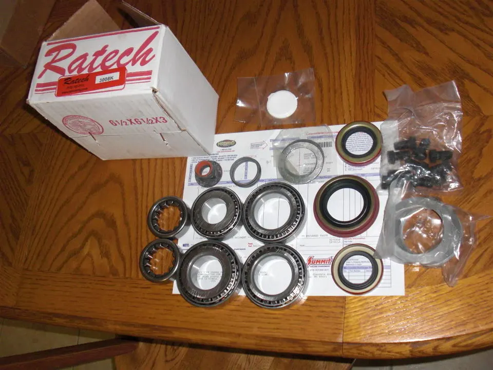

More parts arrived today...YAAAY!!!!:D
Ratech deluxe gear install kit from Summit Racing... It includes Pinion Shims, carrier shims, CrushSleeve, PinionSeal, Pinion Nut, Ring Gear Bolts, Head Bearing, Tail Bearing, Carrier Bearings, Axle Seals, & Axle Bearings...... basically everything u need to install new axles & gears. I might try to spring for the track loc rebuild kit as well if I have the cash after I do some Xmas shopping (not for myself btw)....
The part # is Ratech 3800k if anyone is interested. Here is the link...
Ratech 3008K - Ratech Deluxe Ring and Pinion Kits - summitracing.com

Good call on the install kit. I would definitely spring for track loc kit as well. Now is the time.
The track loc should be shimmed so that the new clutches and spider gears are very difficult to install. If not, even with new clutches, the track loc will not function very well.
Mine was pretty difficult to install. I knew I had it right during assembly of the cross pin...moderate resistance.

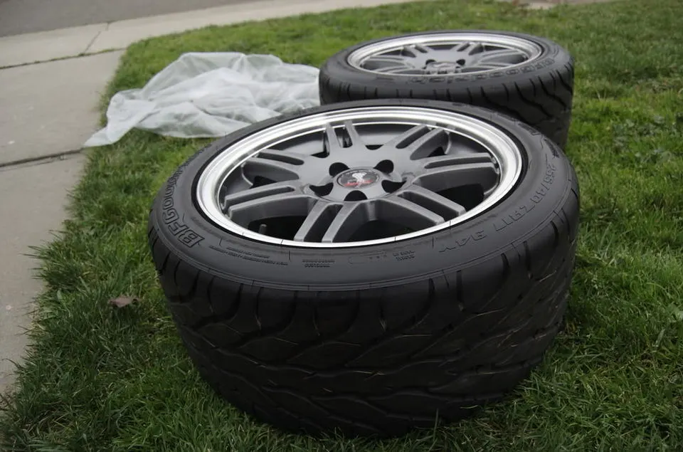

Well I know its been months since I have updated this thread, & the progress came to a halt for a while, but I just haven't had the funds, or time lately. BUT today, I finally made some small progress.

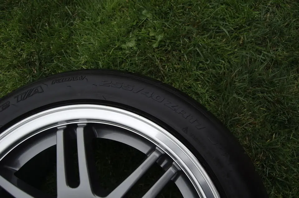

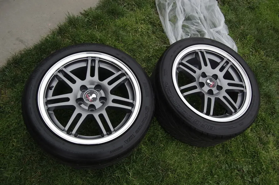

Its just baby steps, but I got my front tires mounted today....
I bought these tires a while back from a buddy of mine. They are slightly used 255/40/17 BFG KDW2's... I have been running the KDW2's on my Mach for 2+ years, & I love em'... Although they get noisy with wear, they handle great, they grip like crazy for a street tire, they last long, & they are great in the rain as well...

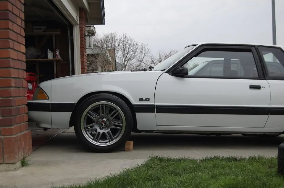

Here is a pic of what they should look like on the car....:D

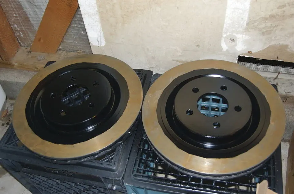

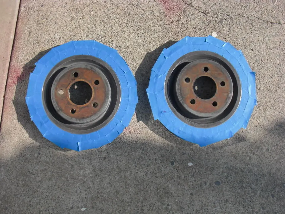

I also painted my front rotor hats not too long ago....
Before....
Masked up for paint.... I make sure I leave a little of the surface exposed, that way once the use the brakes once, it will rub off the excess & leave a nice clean line...
Painted semi gloss black... I know it looks jagged, but it will get scrubbed off the 1st time I use the brakes. Its always best to paint a little more than you need, that way you know that you wont leave any exposed which will end up rusting later....
