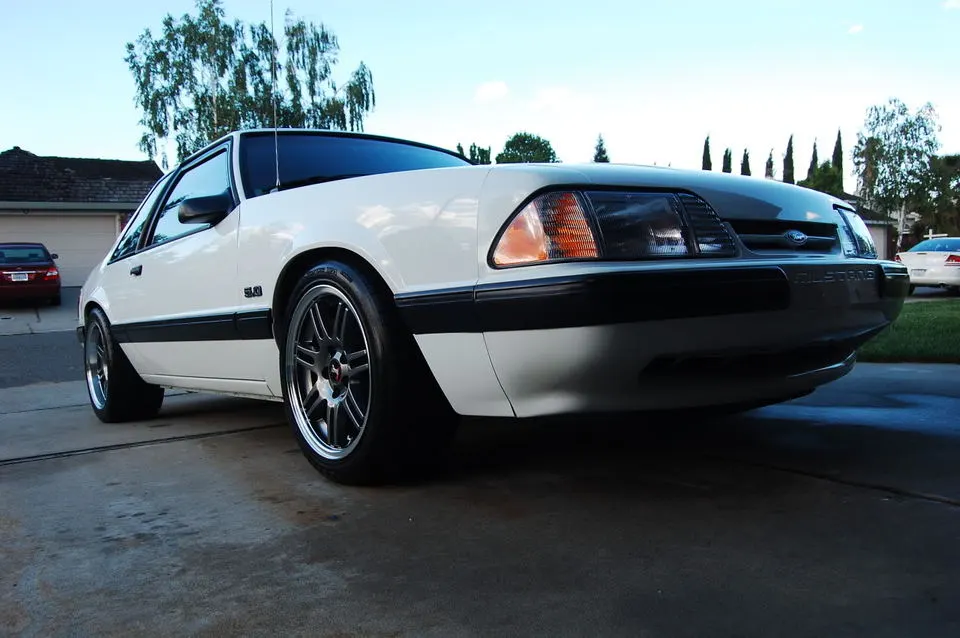

Last week I got the car ready for a 400+ mile cruise & a HUGE car show...

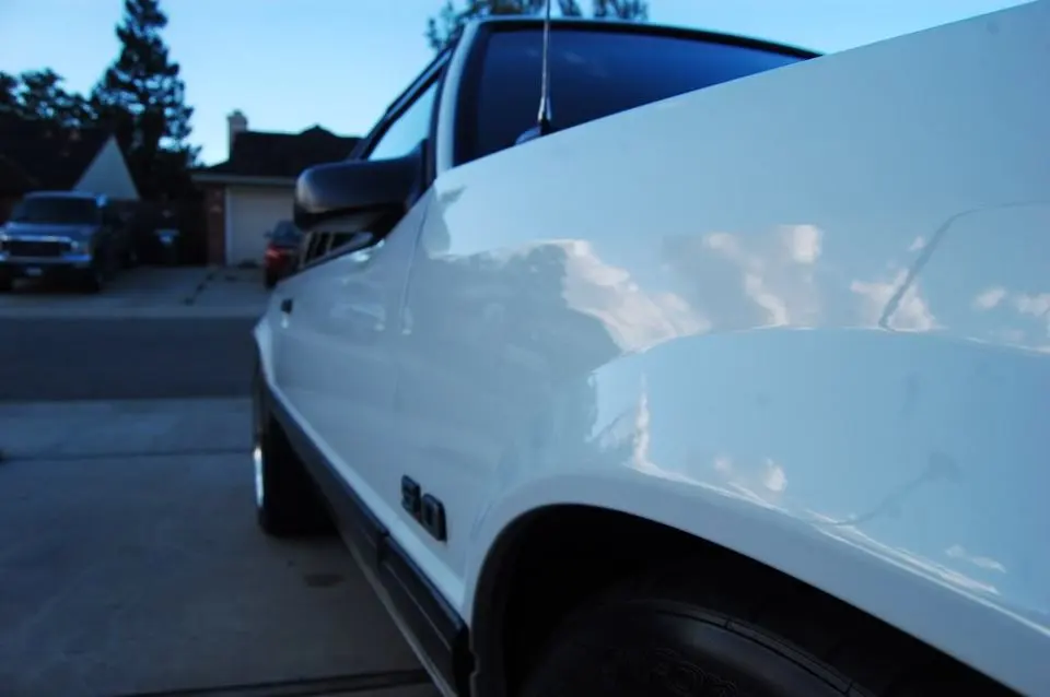

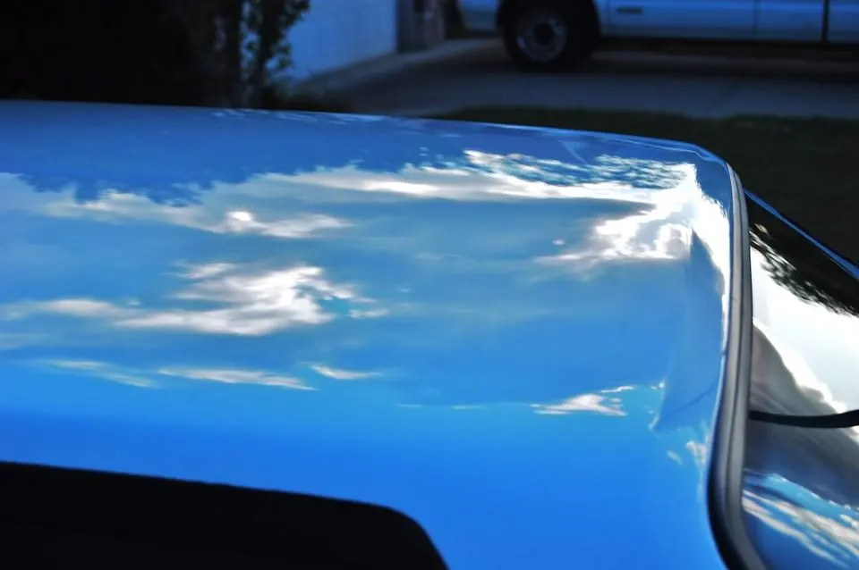

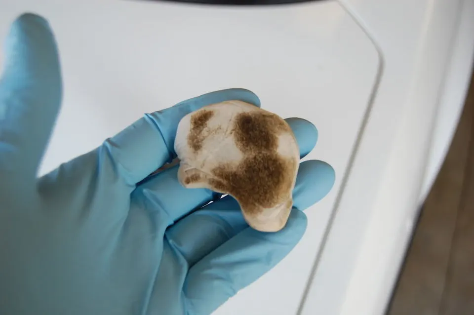

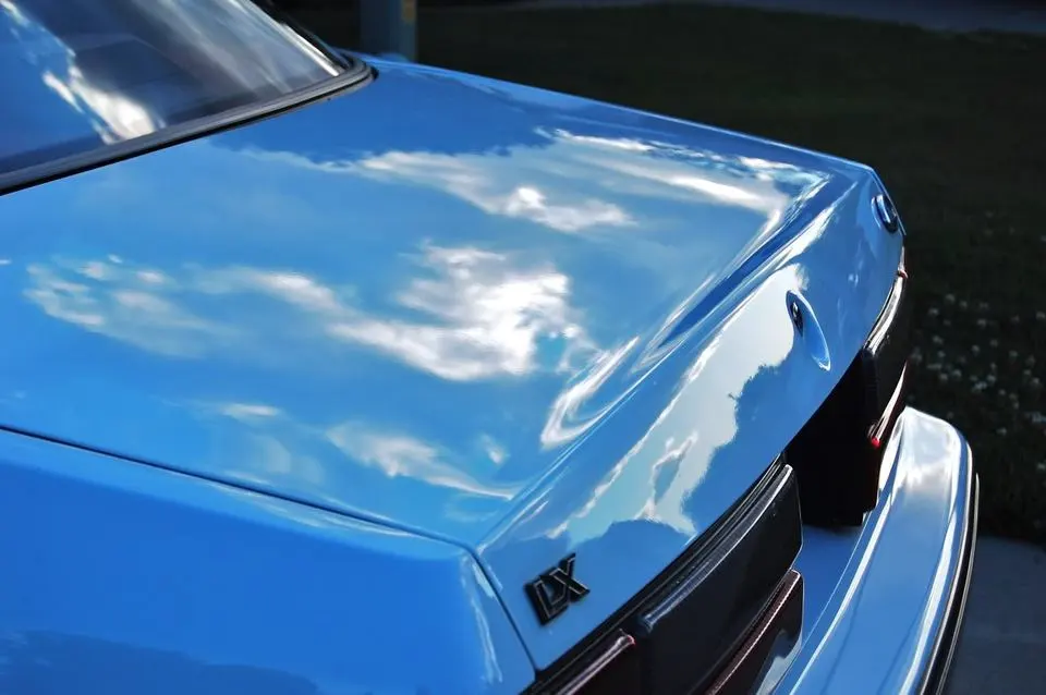

1st up was a full detail with Meguiars products. Yeah, I know its not high end stuff, but I have had great success with it. The process was clay bar, paint cleaner, polish, carnuba wax, & then I followed that up with Meguiars "ultimate" quick wax... I hate to say it, but I have owned the car for 2 years now, & this was the 1st time I detailed it... It needed a claybar BAD!!!
This was how the clay looked after doing the top part of the rear bumper only:eek:
Being that I was super busy all week getting ready for my trip, unfortunately I didn't get any finished pics other than some VERY bright outdoor pics, but I will get some nice pics this week....

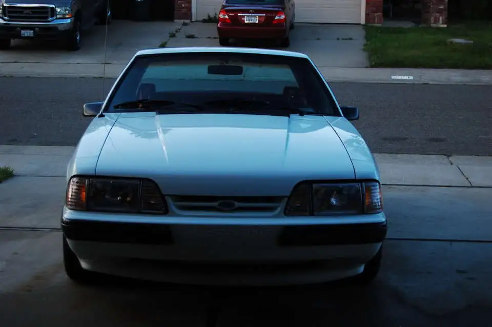

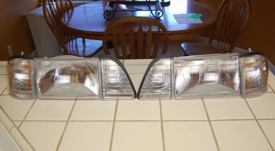

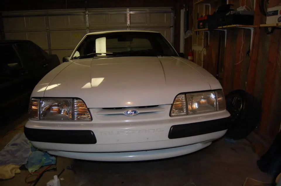

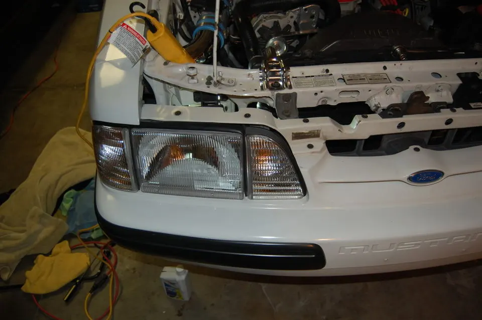

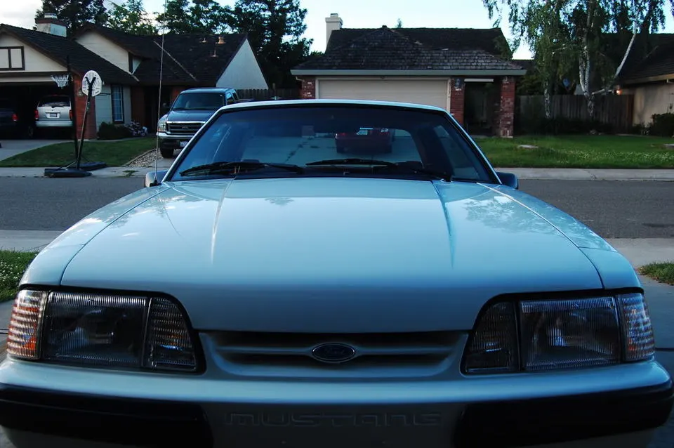

Next up was a new 6 piece headlight kit froim 50 resto to replace my yellowed originals. This was their 'budget" kit, but the quality was pretty decent IMO...
Old headlights...
New headlights...
New on the passenger side & old on the driver side... You can see my shiny freshly waxed hood too:D

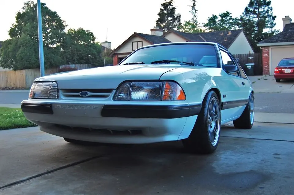

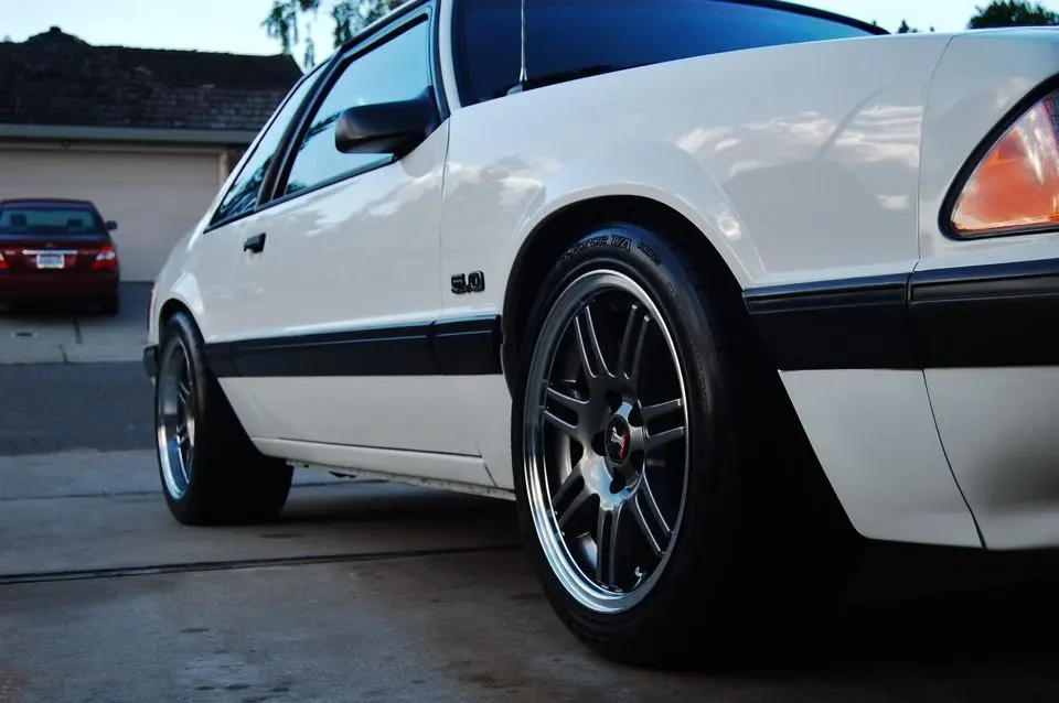

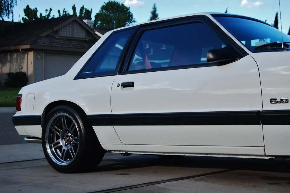

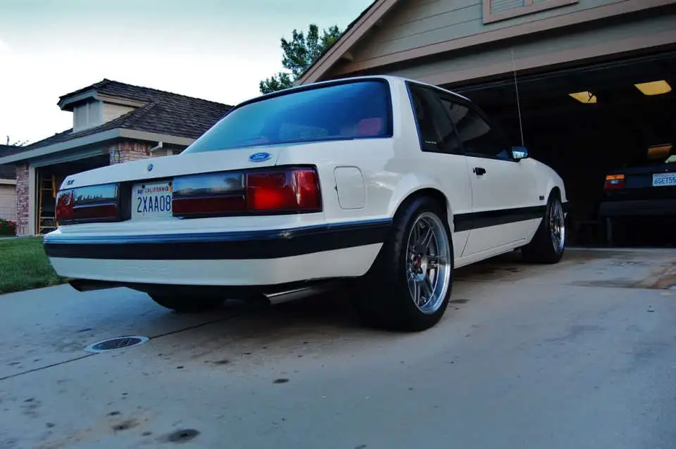

Here is the car all cleaned up @ the Fabulous Fords Forever car show @ Knott's Berry Farm in L.A....

Also, I know this is kind of a Noob question, but how & the heck do you adjust Fox headlamps???
Dude ive been spending the last week trying to adjust my headlights, there are 3 thread jamb nut type things that you have to swap over from the old ones to the new ones, just takes time and a 6mm socket and you'll get it
oh and BTW you wear gloves to claybar a car? cough wuss cough :rlaugh: :D oh and i moved the mounting tab for the clutch cable forward a bit and it keeps it from contacting the headers
I basically swapped over all the old stuff from the old headlights to the new ones, but I didn't see any jamb nuts?

headlights look good. the little jam nuts adjust the caster of the headlight essentially. tightening the TOP nut, will push the headlight housing downward. loosening it will pull the housing back, raising your light beam.

Anybody have a pic of these Jam nuts, because I dont see them on my headlights?

you know those threaded rods you had to remove by popping those small clips out, there were 3 of them, that were attached to the black adjustment plate, the two right above and below each other is for up and down adjustment the lone one on the other end of the light is for left to right adjustment
Ok, I know what threaded rods you mean...

WOW!!!!! The car looks insane Dustin! Wanna fly to NY and do mine? :D
LOL... Thanks Bro, buy me a ticket, I would love to see NY...
Really though, the paint looks good for what it is. Its very shiny, but still does have a lot of fine scratches, knicks, chips, etc, but its MUCH better than it was 2 weeks ago...
