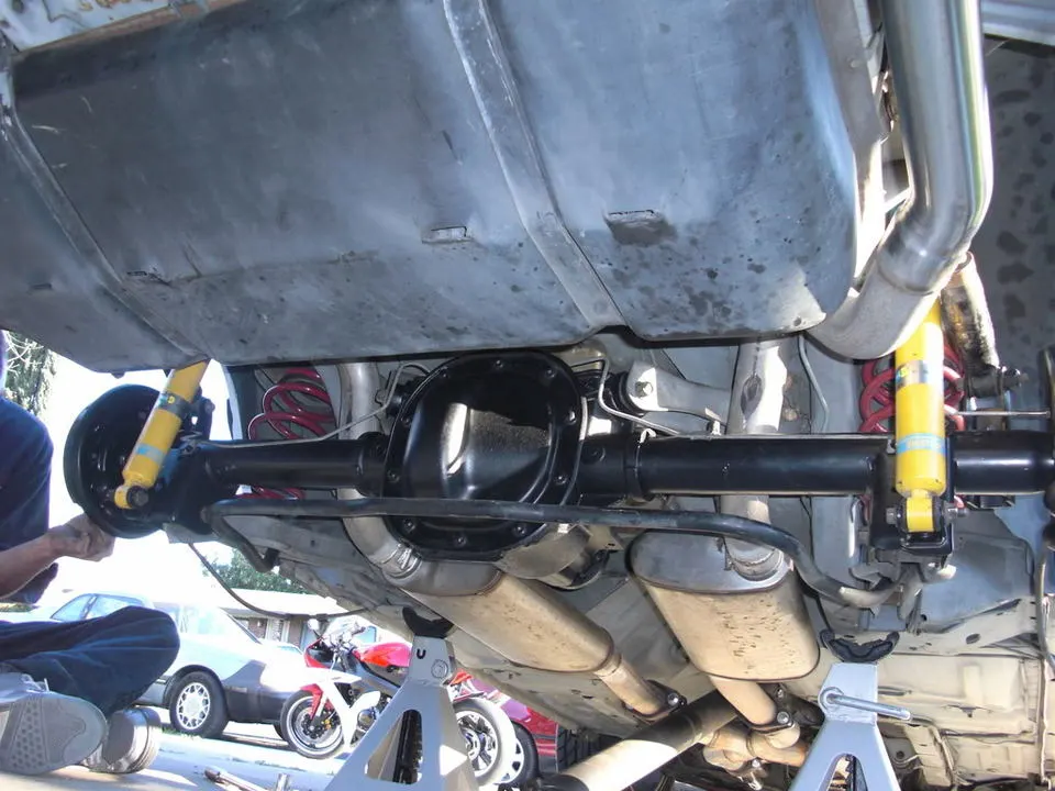

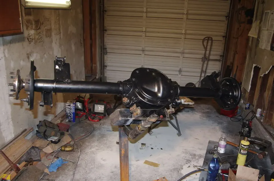

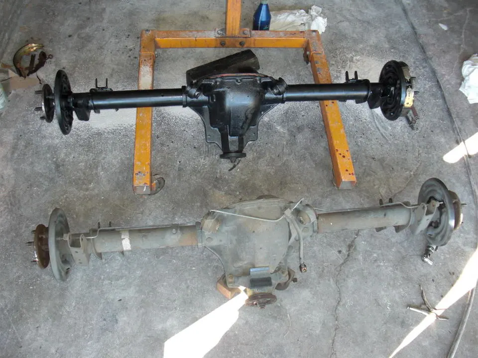

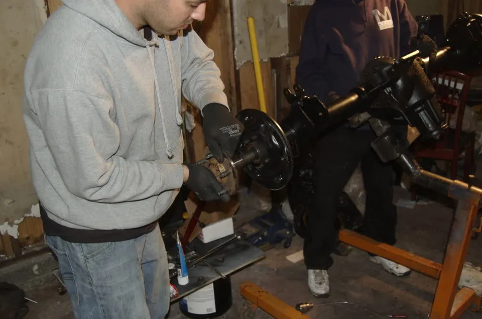

REAL progress today. Since I wanted to paint my rear end before installing the gears & axles, I used a lower mileage core that my buddy had in his backyard to make things easier.... I painted it satin black last week & today finally started getting down & dirty....

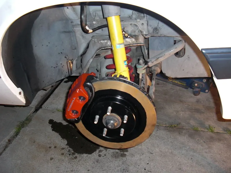

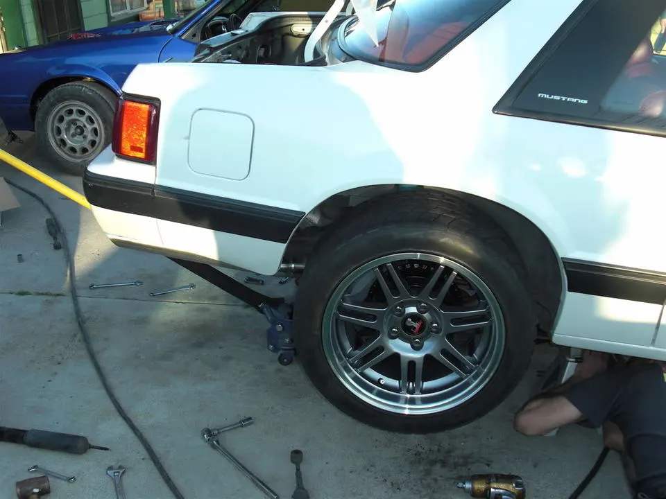

We installed the 3.73 gears & 5 lug ranger axles today... I really want to thank my buddy StreakMatt & his dad Jerry for helping out big time... I learned a lot today since this is the 1st time I have ever installed gears.
Here are some pics taken during the process. I know that most wouldn't include this many pics of the process, but I am proud that I actually helped install my own gears rather than paying a shop to do it....

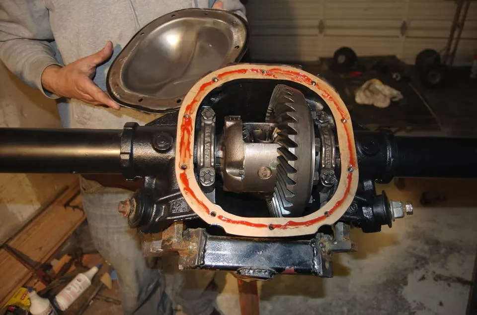

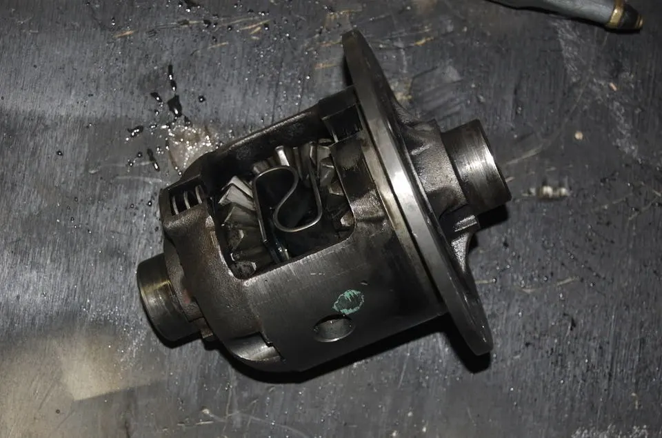

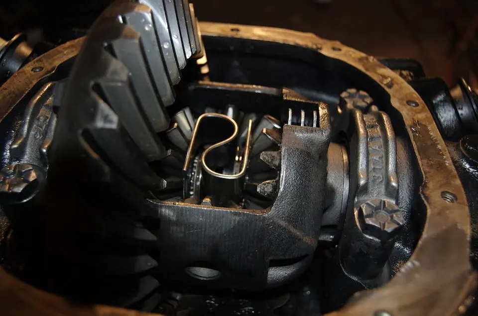

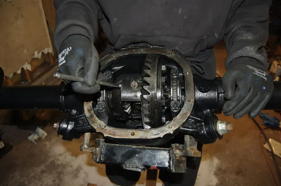

Diff opened up & inspecting the clutches etc... Everything looks good & tight & didnt need a rebuild....

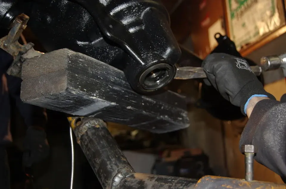

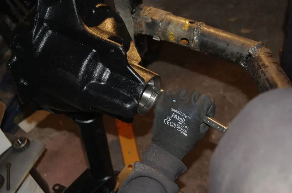

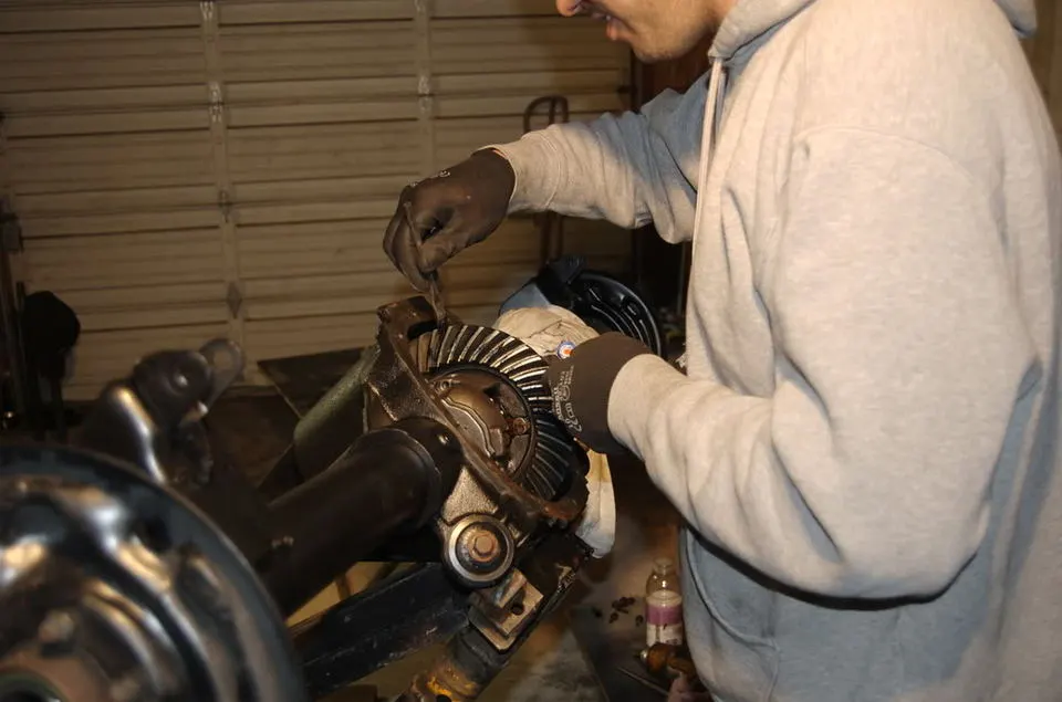

Knocking out the old seals & bearings....

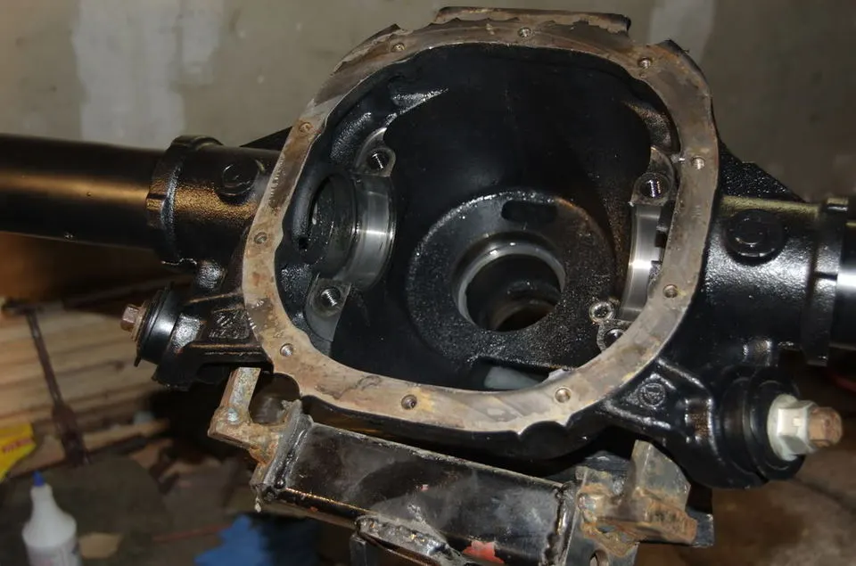

All cleaned out & ready for the new parts...
Knocking in the new bearing race....

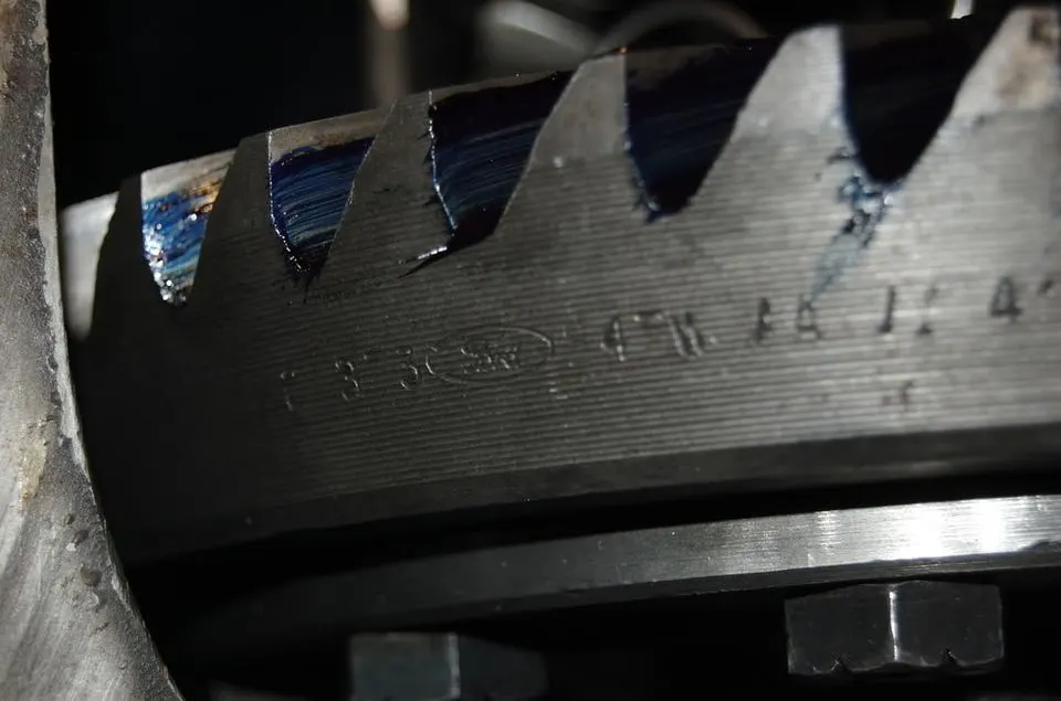

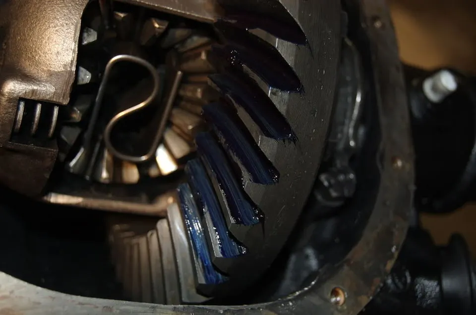

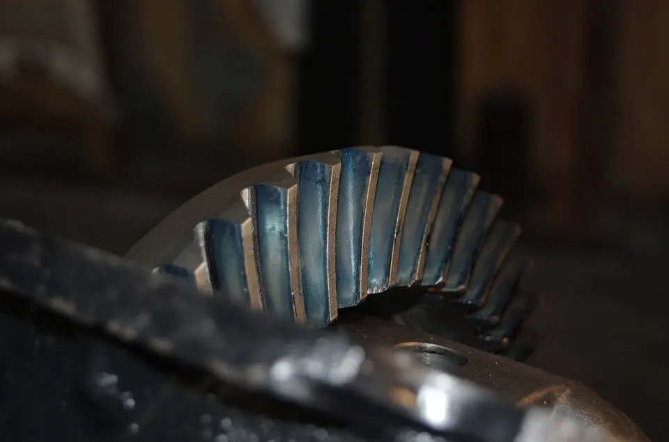

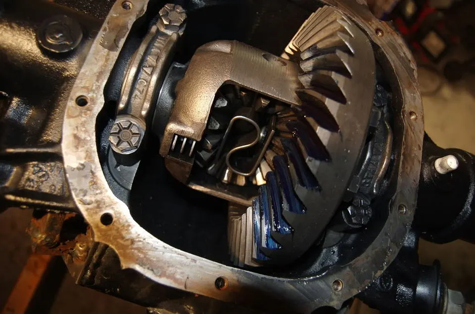

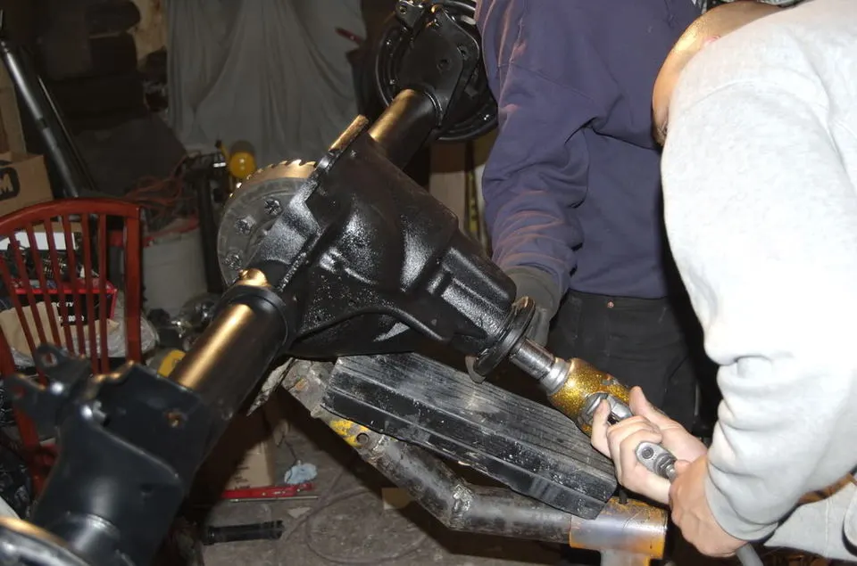

Carrier installed with the 3.73's & new bearings... Im spreading blue paint on the gears to check the wear pattern to make sure everything is nice & tight....
Wear pattern looks good to go...
Tightening down the pinion nut...

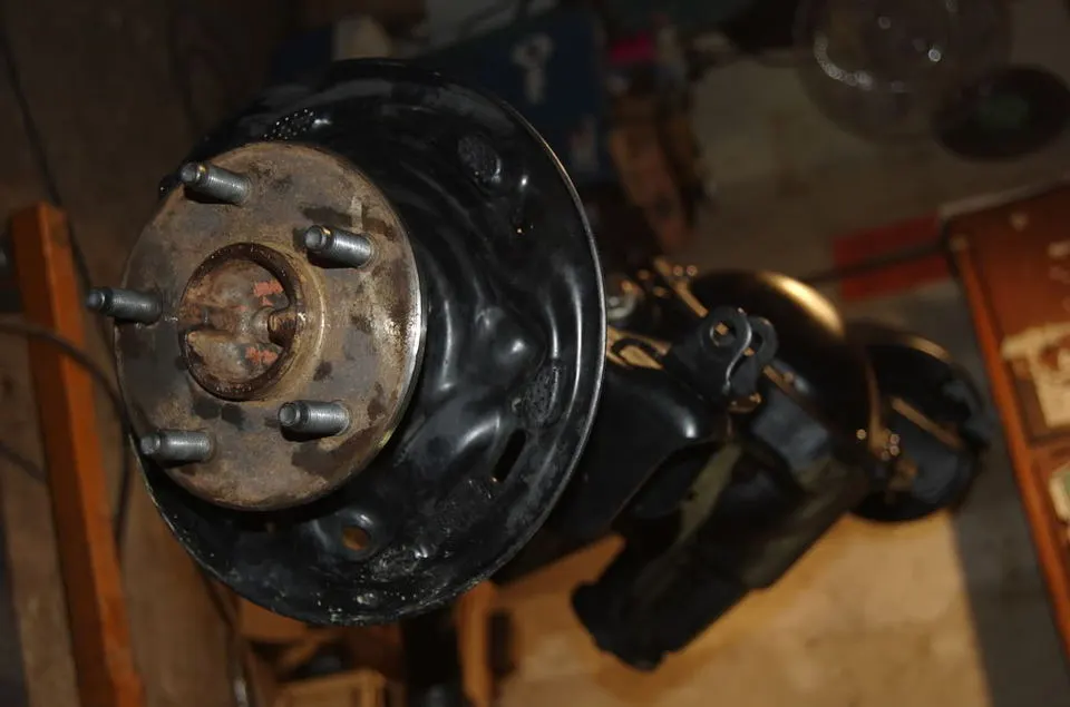

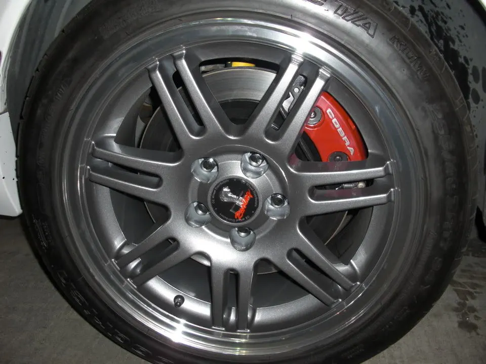

Slipping the 5 lug axles into their new home...
Diff cover ready to go back on...
All buttoned up....5 lug axles & 3.73's FTW!!!
