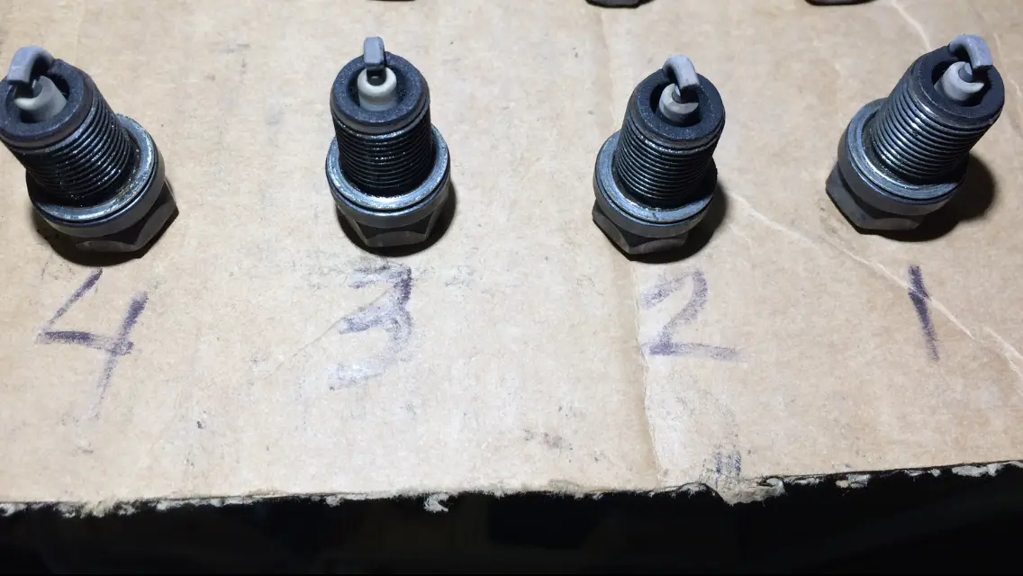

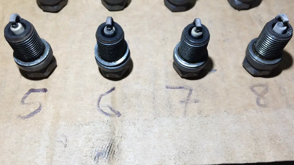

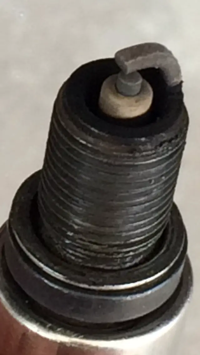

I just pulled plug No 1 and this is how it looks, I see black carbon dust like running rich...
That plug doesn't look too bad to me. Usually rich Plug would be darker on the ceramic portion.

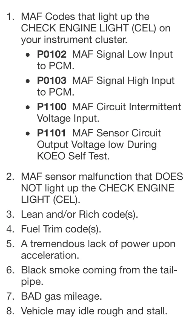

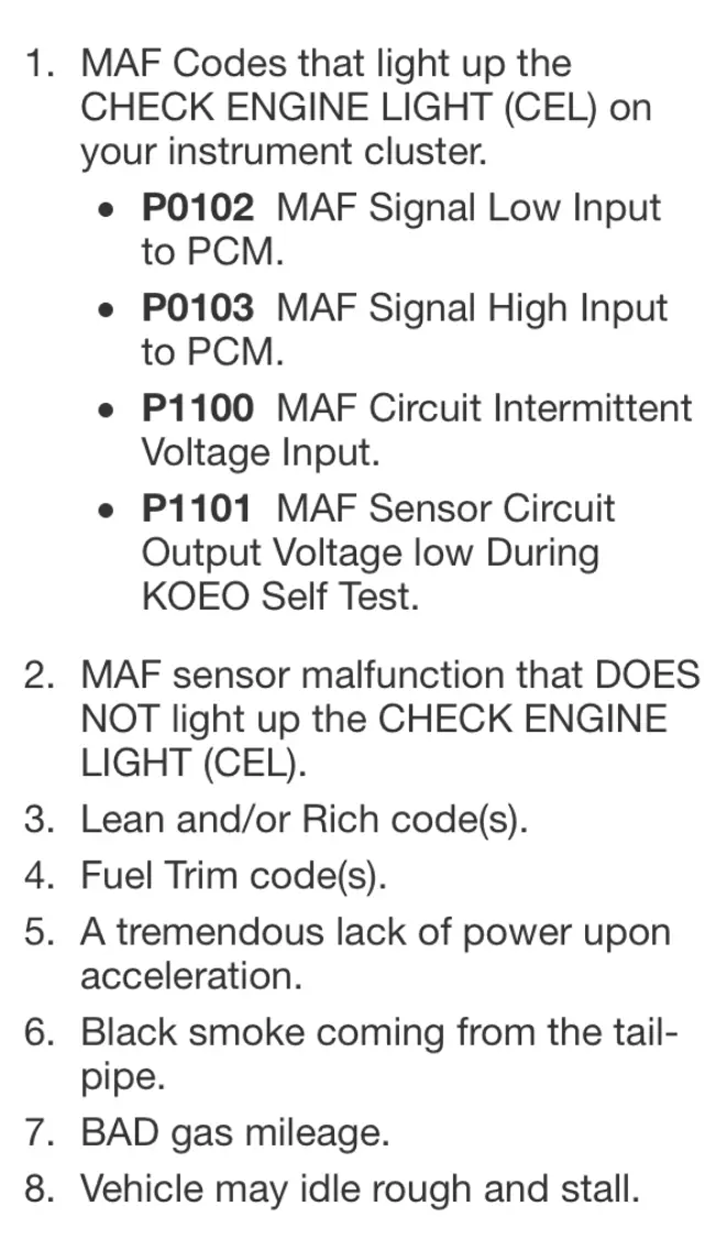

There is one posiblibity, that some of the sensors failures don't get registered in the computer memory until the sensor is completely broken. For instance here are some statistics of a MAF performance I found
Could there be similar list of failures on O2 sensors???

Those are mostly OBD2 codes. Uncertain to if the primitive OBD1 system we have has the capability of registering that beyond voltage ranges being out of spec. A bad MAF would in fact cause the car to run rich, but you've tried two now correct?
