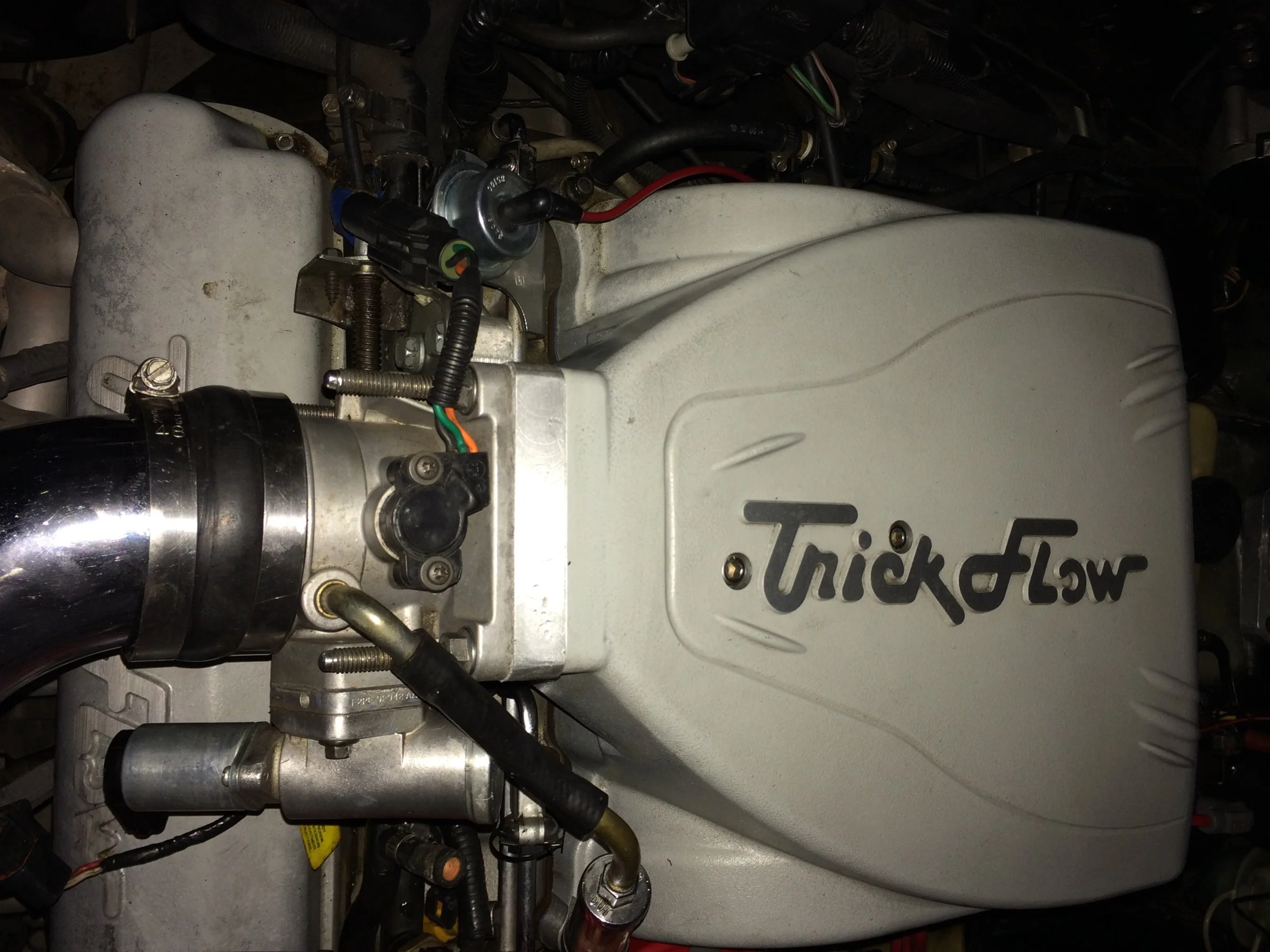

... No EGR...

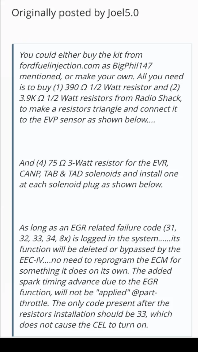

Mustang5L5 I was going thru your old postings on this and foundthis statement, not sure if there has been any corrections based on more research and results:
Thank you!!!
