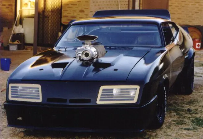

It is a "scott injection" setup on the madmax car which used some decent sized wheel flares too.
http://www.madmaxmovies.com/ I made my own version for my blower engine.

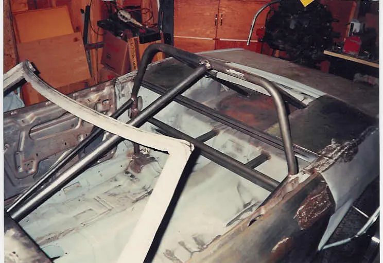

Anyway, when I first started the roadster, I had built flares along the lines that your talking about Joey. Built out of tubing and sheetmetal (piecut pieces) along with reworking the inner fender for clearance. After I had them both done and the mud work was done, I cut them off. I felt they didn't flow well with the II's bodylines. My new flares are all sheet metal and don't hang out there as far so now the rearend will need to be narrowed. Attached is a early picture of the roadster with the tube frame (sorry about the little bit you see of it, but you get the idea).
If I was to do it over again I'd buy some new back quarters and build the flare on them off the car, rework the inner fenders once the old quarter's off then attach the new quarters in one piece. It would be easier to weld the inners this way amoung other things.

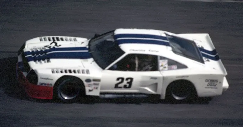

The "Handler" kit was available through Maier Racing for about $1300 last time I heard. Its a race weight set, so you have to ask for thicker fiberglass if you're going to drive on the street (and want it to survive :) ).

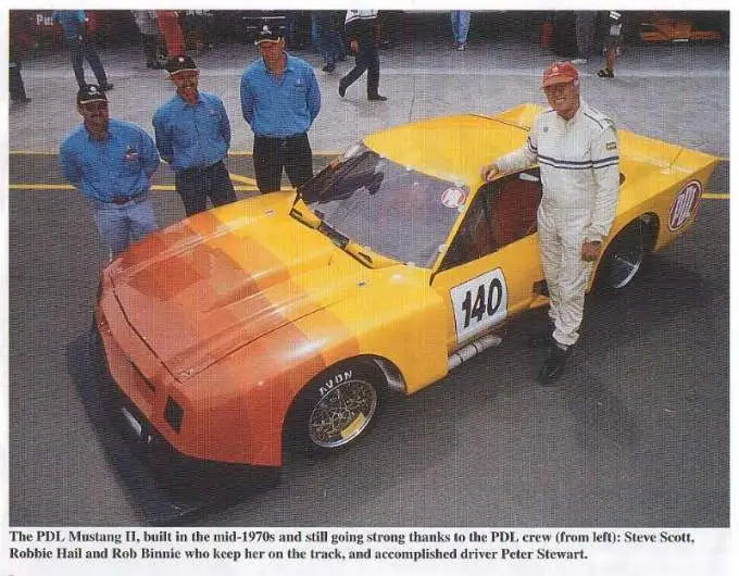

That Firebird kit is in the IMSA style which was real popular in the late 70's/early 80's. I think it still looks pretty good on the II. The PDL race car looks so much like Charlie Kemp's MII IMSA racer that its hard to imagine they weren't related in some way.

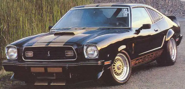

This has got to be my favorite "stock-looking" Cobra II. Aside from the fiberglass hood and fender flares and BBS wheels, it looks almost factory. :D
The rear flares look like something that Maier or MAS sells.
It would be really cool to reproduce the Kemp Cobra II look with a street MII rather than dropping MII sheetmetal over a racecar frame. The street car wouldn't sit as low, but it would still look pretty good.
Reproducing the Kemp street "GT" protptype would be cool too.
