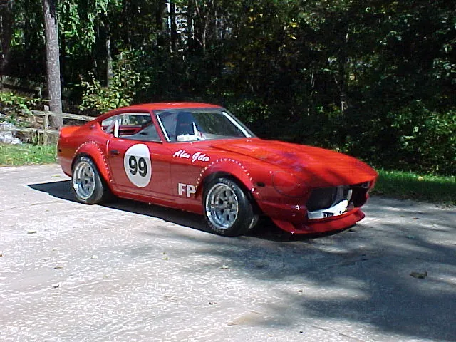

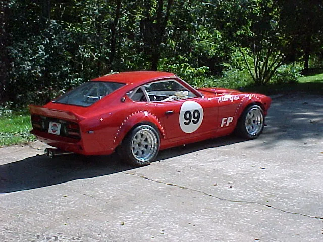

i would love to put the bubble style fender flair on my II. i hear that MAS has a type of bubble flair that way you can use some pop rivets to hold them on. i like the look of the bubble flairs with exposed rivets and a small cowl induction hood, old day road racing. please ask MAS if they have this type of flair for the II. i'm so close to pulling my motor and selling the body, but if MAS has the flairs then maybe no. how about some flairs, a fuel cell out back, a small aluminum rear spoiler, front spoiler and the cowl hood. just like the 1965 mustang that maier shows on there site but with a II. i think there bubble flairs are like 75 dollars for the pair:shrug: .hey 393boss let use know what MAS has to say about there bubble universal flair.:nice:

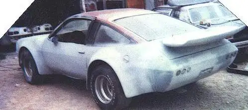

Well I got the flares from MAS today, I ordered the wrong ones (stage I flares) LOL:D, I already phone them and got another set coming. They don't have any updated catalogs yet. These ones are not bad and I could use them but I want the bigger stage IIIones. Here are some quick pics for now, I am a bit short on time right now.
I want to lift the flares up for 30+ tall slicks
You can see the simular body curve from the camaro and mustang body.

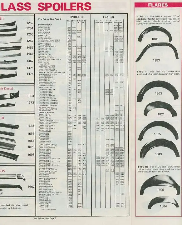

this is what the stage III ones look like
And again MAS lists parts for 74-78 mustang II's
Type I front/rear mustang II flares

hey 393BOSS could you possibly tape on a front fender flair and show a pic of that view also? they do look sweetttttttttt. if thats stage 1 i could'nt imagine what stage 3 looks like.that is exactly the look i'm looking for, thanks so much for all of the pics:nice:
I will take more pics next week, the car has got junk all over it, a bit busy with work to fart around right now. I will take more pics of the new flares when they come too.

I am expecting to get the new flares by the end of the week and I will post some pics. honestly I don't think what I want to do will work for you, I am planning on using a 30" tall 18.50 wide tire with a 14" wide wheel. I would suggest buying the stage I 3" flares listed that are molded for the mustang II that should work for most 8" to 10" wheels.

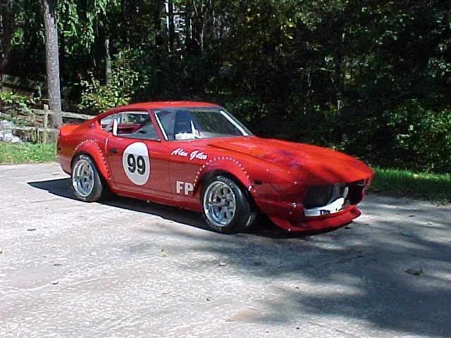

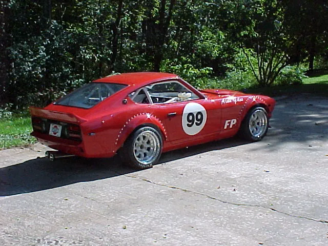

i plan on putting on the rear a N50-15 tire on a 15x10 wheel and up front a G70-15 tire and a 15x7 wheel.with some type of flair not only to make it wider but also to add some radius to the wheel well. on the maier racing site they have a picture of a 1965 mustang with competion style flairs that looks so cool:nice: .

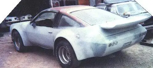

OK, now I got flares on the brain again lol... I started to think about the body shapes and remembered back when I bought that imsa camaro/firebird kit to try on the mustang II That I was also looking at trying the imsa monza kit also, the company just did not have any stock at that time so I got the other one. The body shape is also simular (maybe more so) to the mustang II.
http://monza.homestead.com/impics.html
They made bubble flares for it too.
