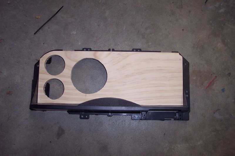

The problem became how to back them up. I wanted to do something "different" (that's not in my character, is it?)

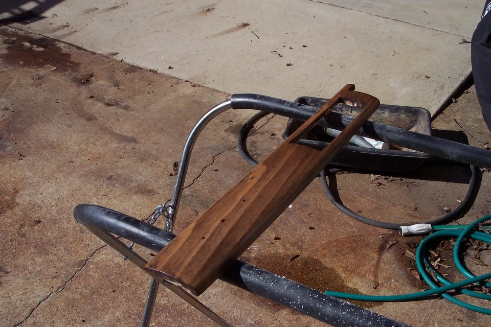

I chose to build a wood backer, stained and lacquered to cater to my theme.
Now I'll tell you, I know it's not gonna be for everybody, as most of you guys are trying to "tech-up" your interiors. I, on the other hand am going the other way. I'm going for the Barney Rubble look instead.

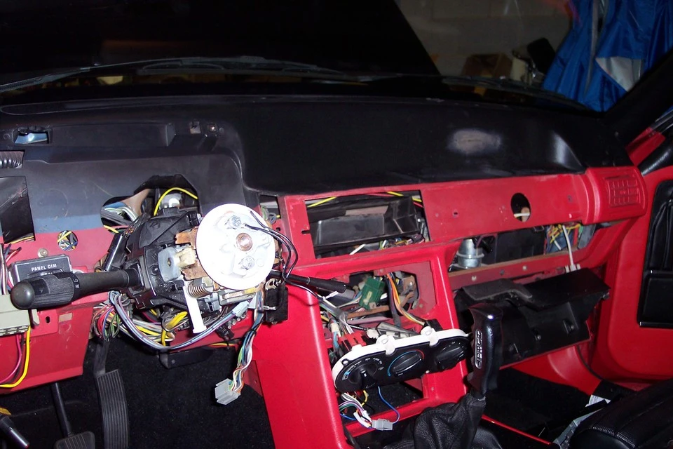

So here we go, the gutting of the relevant interior parts:
I went w/ a pine board. Lowes has a bunch of different woods to choose from, but not knowing on whether or not this will work, the 3.50 it cost was "expendable"
The passenger side had to be laminated, as there had to be "hidden" screws to allow me to mount it.
I have to wire them, and get them in the dash. I'll post up some better, completed pictures when I can get back at it.

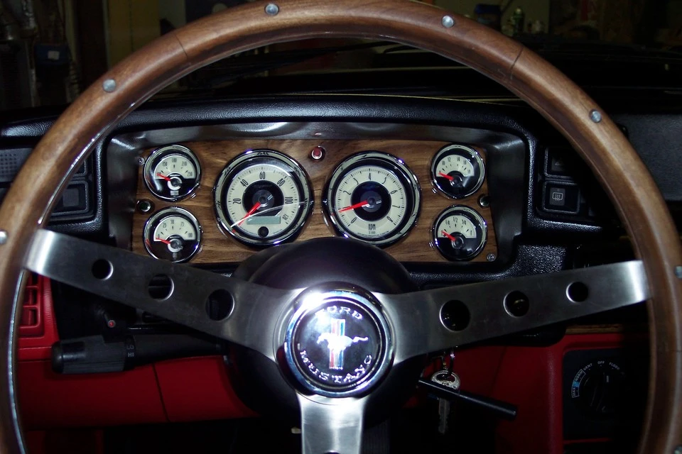

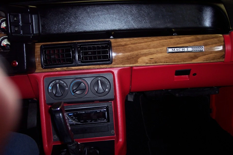

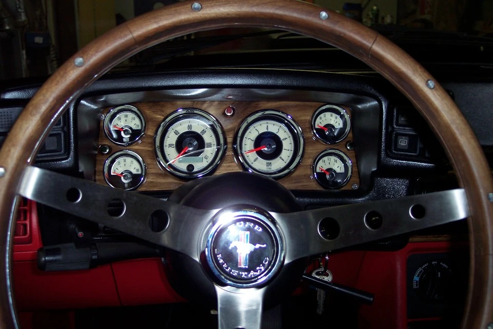

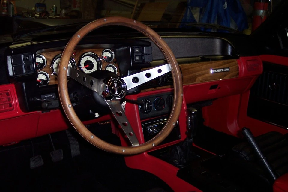

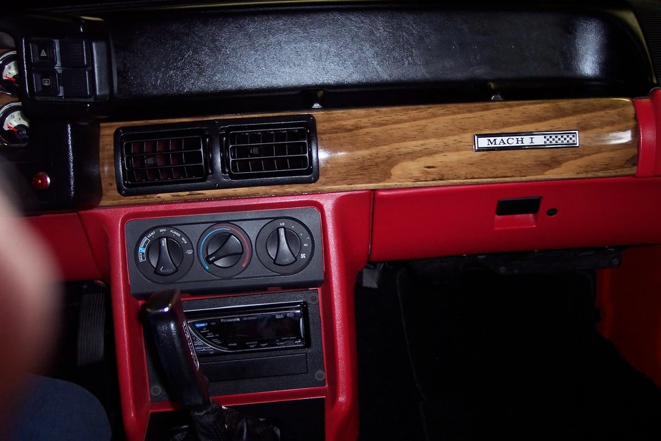

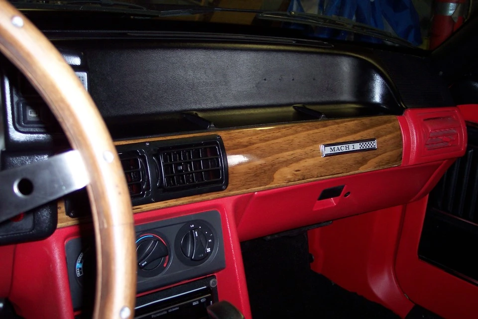

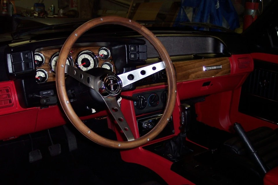

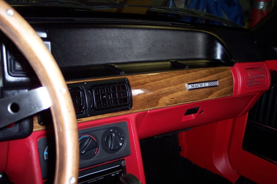

Finally! This little"mod" seemed to take forever. The gauges are MUCH better than the old Nordskog pieces. Fuel level reads instant, The Tach doesn't require the stupid Dakota Digital adapter the old one did, and the speedo reads 70 @ 70 (not 314)
For your perusal:
I don't know what's up w/ the crack looking thing in the picture, they're NOT cracked. Honest!
You can see the holes where the mach 1 emblem used to be in the upper dash either I gotta find something to cover these or it's gonna piss me off.
I think it turned out pretty good. and I'll definitely keep the look. there were a couple of things that I had to do to make it work. the center dash vent is "screwed in" as the wood is too thin to hold it tight, and the entire Gauge housing cover had to be "Persuaded" back into place because the wood is too thick holding the gauges.
But it's all back together, and I'm happy. All I gotta do is clean it up and I'm ready for Foxtoberfest.
