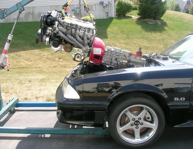

The engine swap was the very first thing I did to this car, and at the time, had no idea that it would end up like it did. So, needless to say I did not spend alot of time detailing the engine compartment. I spent a fair amount modifying the K member to accommodate the swap, and I filled some of the holes, but other than that I just whipped out the rattle can, and sprayed the whole thing in gloss black engine enamel.Then I stuffed the engine in it, and that was that.
It has always been a sore spot ever since. So despite the fact that the heads were off, and I had a pretty good amount of access to the bay, I decided that the extra hour to finish pulling the engine to get a better end result was warranted. I'll also be able to get a better result when installing the heads out of the car, so there's that too.

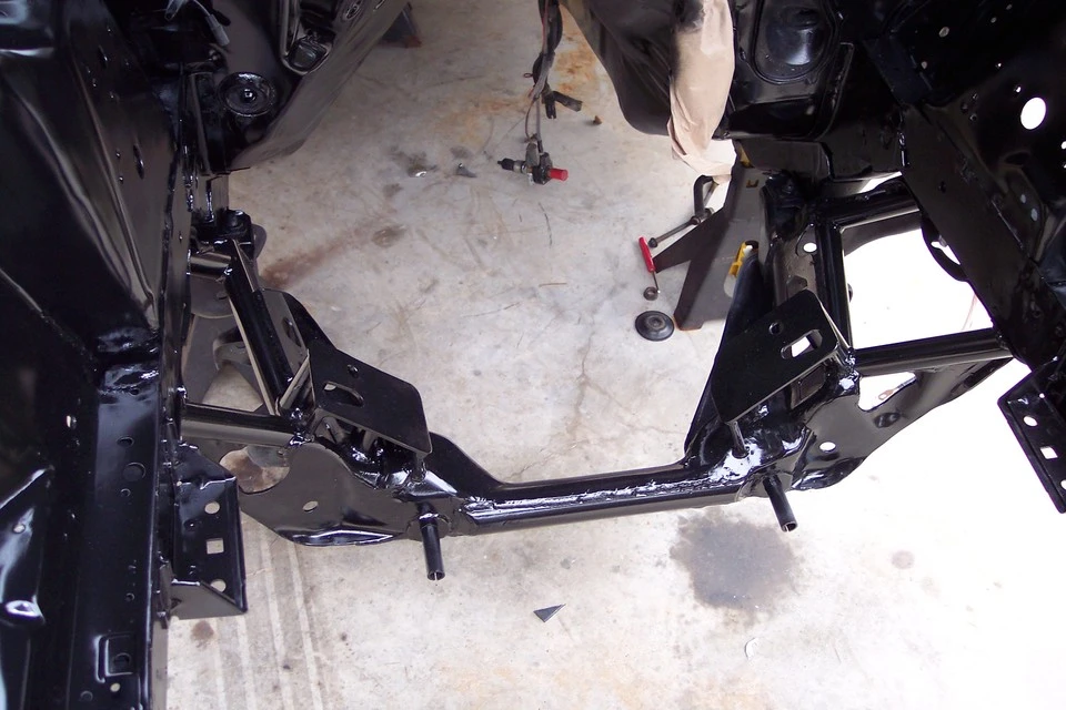

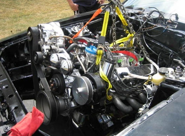

Almost waited too long to fix this:
You can kinda make out the goofy "tubular K member" I made, so as to have access to the stupid under the tube header bolts. It works, kinda.

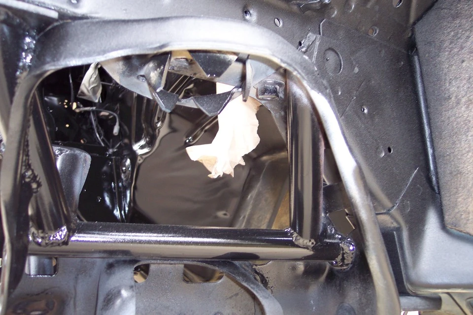

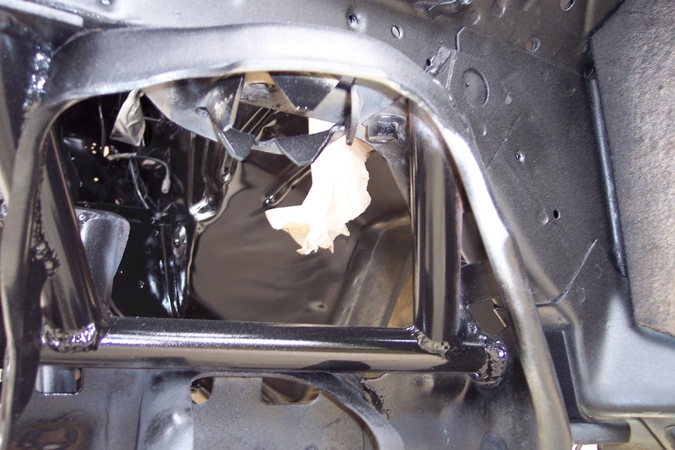

Also, you can see that I've filled the A/C evap hole in the firewall. Don't need it, my A/C system will be in the trunk.
I've already ordered the adapters that will allow me to change over the heater core to AN. I'll use braided -10 for my heater hoses. I think I'll have a pretty clean overall solution to dealing w/ damn hoses to keep me cool in the summer and warm in the cold months.
* On a side note: I have never done it before, as I've always had automatics, but can you reinstall the engine w/ the 5 speed trans in place? If its not the thing to do, I don't wanna take a chance of bending something.
Maybe somebody can clue me in.

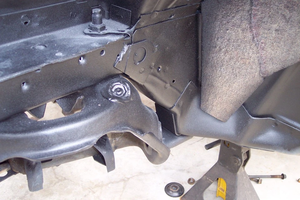

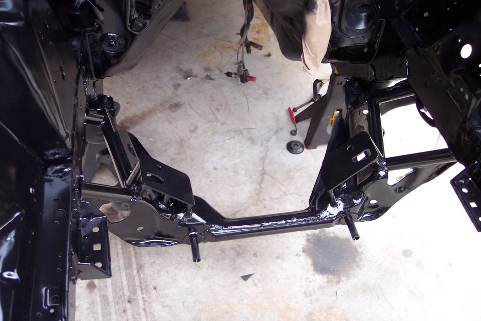

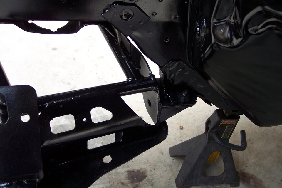

I'll have to post more detailed pictures so that you can sleep tonight.

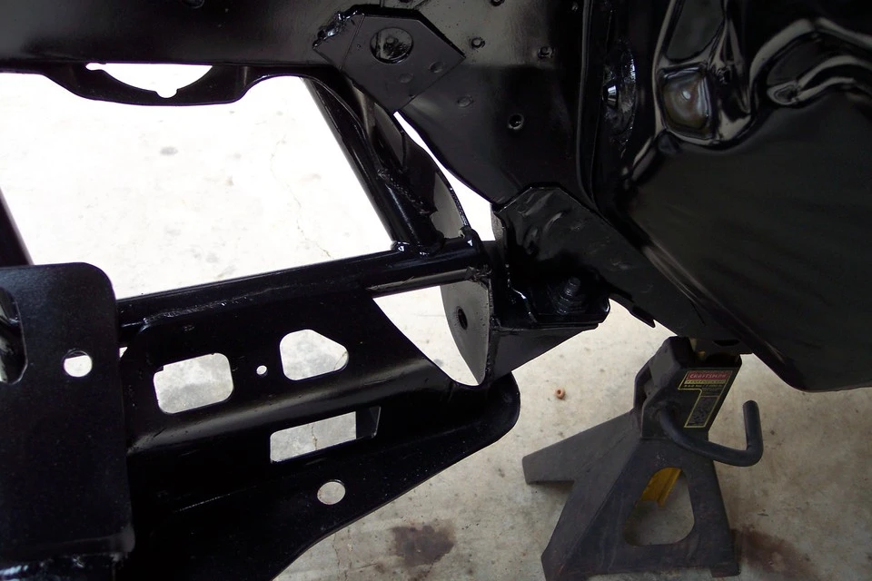

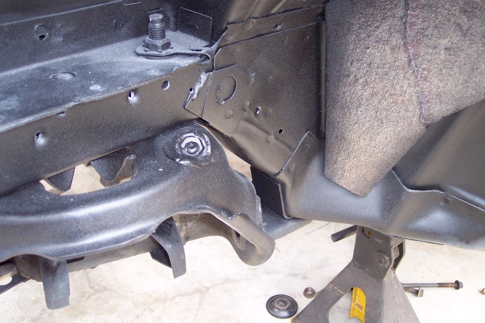

There is nothing "frightening" about my K member. Three pieces of 1.250"
.125 wall mild steel tubing triangulated starting just above the factory LCA pivot point.
Tied into the factory upper and plug welded:
The central span is a piece of 1.750" .134 wall tubing.
If I planned to do what you do, then No Crane, I probably would want some more reinforcement for keeping everything bolstered even better. But for going straight through traffic to the local grocery store, I don't see any reason it wont work just fine.

I have never tried it but, since you pulled the eng out without first droping the trans out of the car, I would guess you could but it back the same way if you are careful. I have always pulled the trans off first. I wish I would have tried it your way now. Are you going to paint the whole eng red or just the block? Looking forward to seeing how it turns out though so, keep up the good work Mike.
You sure can. Did it last time I put the engine back in the car.
attachment.php
attachment.php
It helps if the front of the car is raised up a bit. I remember taking the shifter base (still pictured) off once I realize it would be easier with it not there.

Mike, if I were pulling the engine out, I almost always pull the trans too. It's just been easier in my experience to get the pilot bushing and clutch splines all jiving together out of the car. I've pulled many transmissions for repair or clutch jobs, and it's hard enough stabbing them under the car, I can't imagine trying to hit the trans with an engine on a one arm bandit at the correct angle. However, I'm sure it can be done, and there are more than a few ways to skin a cat...:shrug:
