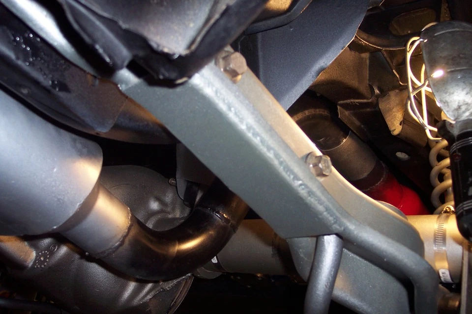

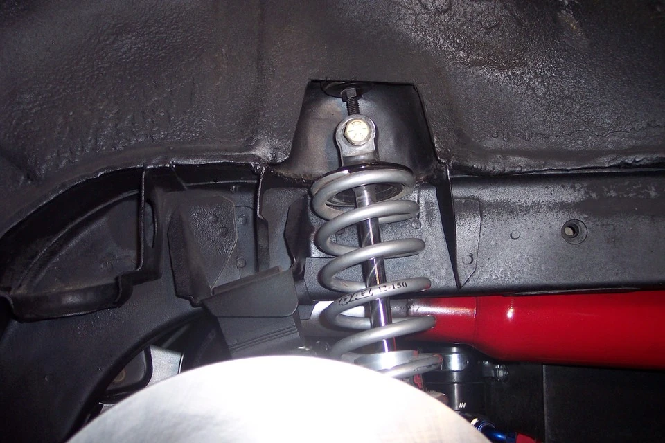

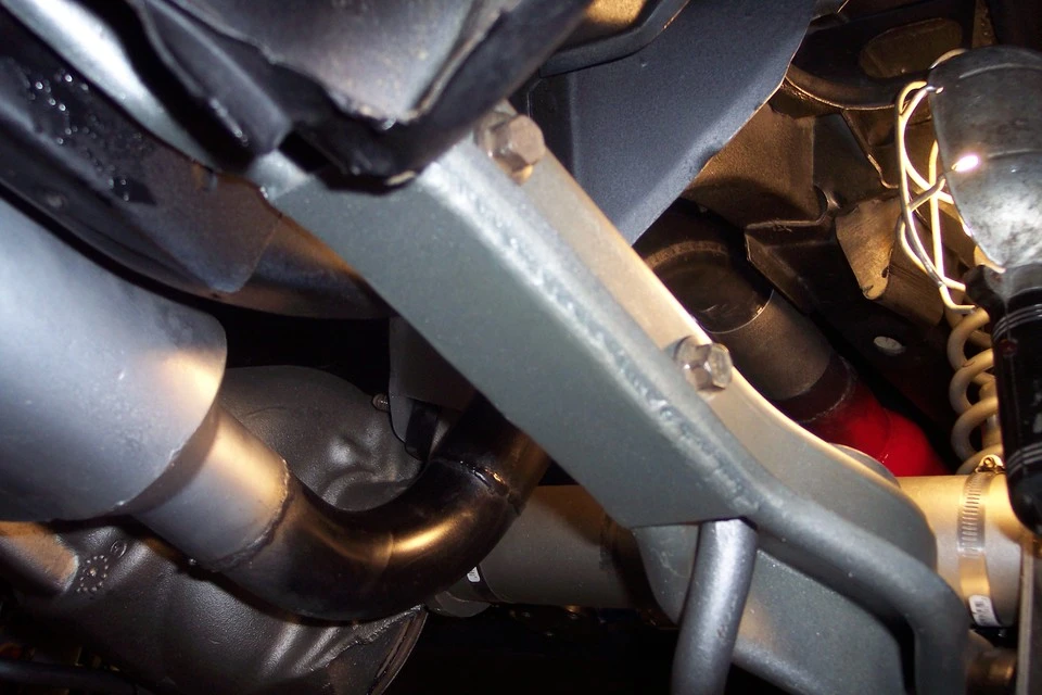

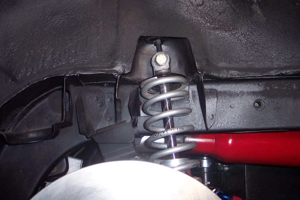

The 5 lug conversion is complete. The rear suspension was installed yesterday, and the 8.8 has received a refresh. (new bearings, gears (3.73 gears Up from the 3.55's that were in there) T-lock rebuild, new Ranger axles, and of course, the Cobra conversion kit from North Race Cars.) The control arms are reinforced, w/ new Steeda bushings. It's all been cleaned and painted under there.
Next will be the wheels and tires, put on for good. I still have a few things to do while it's up in the air, and I'll post those up then.

Nice job of boxing the stock control arms. I've not seen many people do it, but it is certainly an improvement over the stock setup.
Thanks. I see now why nobody does it. The bushings ended up costing 100.00 and the time, mess, and hassle of getting everything prepped and ready to install makes a 299.00 set seem like a bargain.
