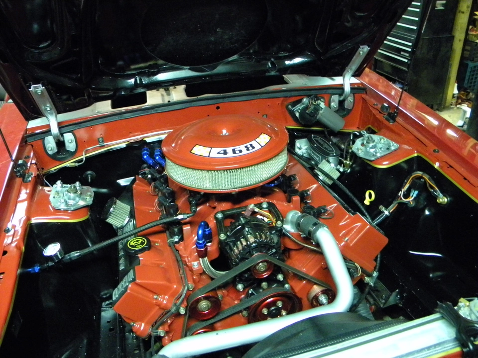

It took forever to rewire the engine. I relocated the ignition controller wire grommet, and it meant that about 2o wires had to be cut, lengthened, and soldered back together. The engine compartment is finally done. Save for some mega-piddly ass details, it's full of oil and water, and I should be able to start it next week sometime.

I should be able to back it out next weekend, and finish up what's left. It's going in our local "World of Wheels" auto show the second week end of Feb. I'll take some real pictures of the finished product out in the sunlight.:nice:

Looks awesome. Is that relay on the driver side of the engine bay your starter "solenoid"?
No,Scott a 4.6 has the solenoid built onto the starter. That relay is to "amp up" the current from the stock relay wire to kick the starter drive. The stock wire going to the old solenoid didn't have the balls to engage it.

Man, I can't believe how amazing that engine looks in there. I bet that fools a lot of people, including a good amount of "car guys". Can't wait to see more pics!
It does. I have argued w/ several "car guys" last year that it's only "281 cubic inches" and that it only makes about (then)265 FWHP. They walk away,... sarcastically laughing going..."281 cubic inches,...yeah right!"
So, instead of arguing w/ them this Feb, I'll pander to their disbelief and just let them thing it's a 468.:cool:
