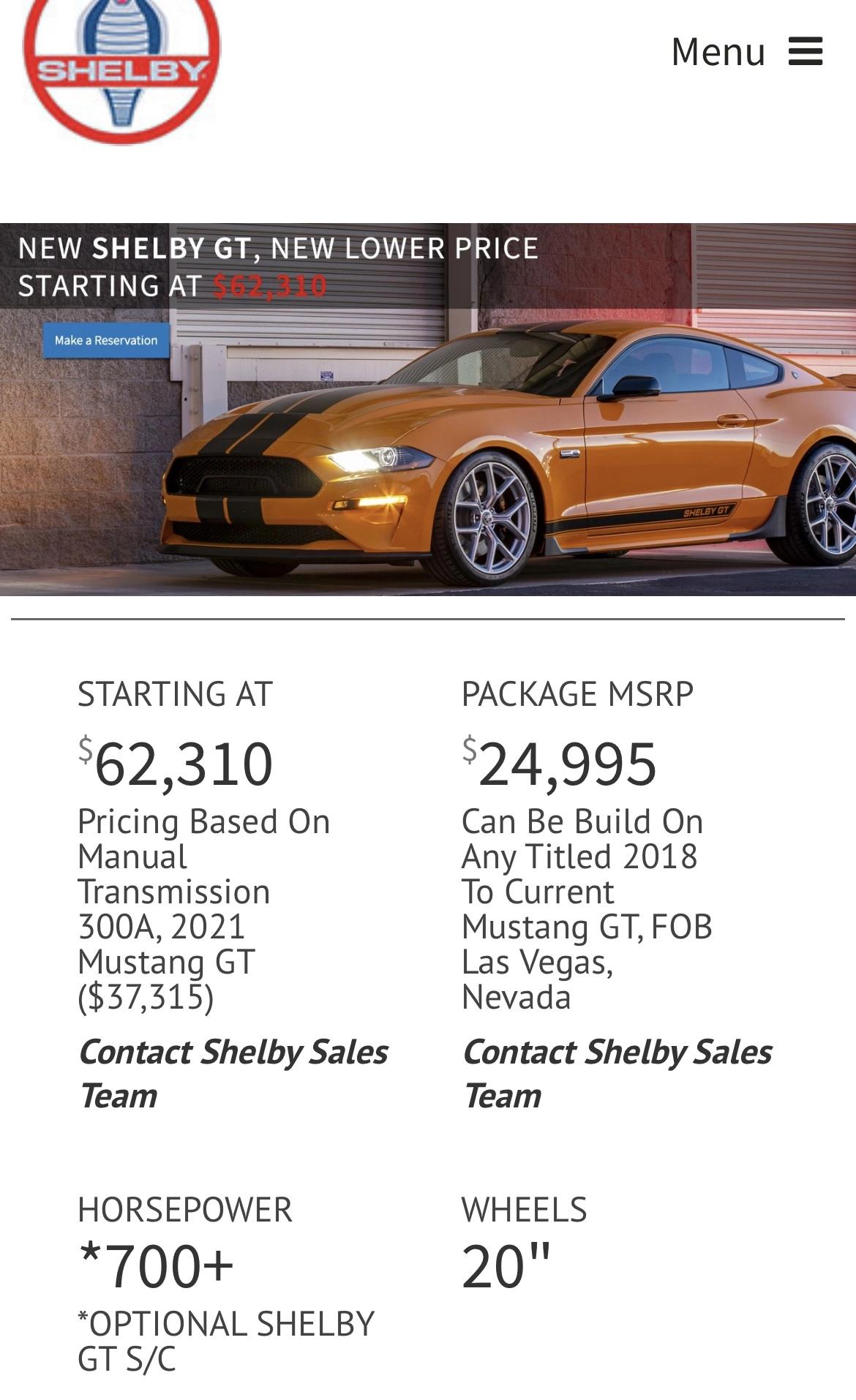

For $90k I’m getting this. Not a Shelby GT
(Me in the drivers seat)
Reactions: Blueinfan and DudeStang
DudeStang
Nuts fell off while driving
5 Year Member
Apr 30, 2017
659
373
83
Feb 4, 2022
#962
  • Feb 4, 2022
  • #962
Oh yeah I mean, no question…but thats assuming you could get one for close to MSRP these days. -.-
Seems that Shelby GT can be had with a supercharger too, good for 700+ horsepower.
I guess this would be one option if one was determined to have a manual.

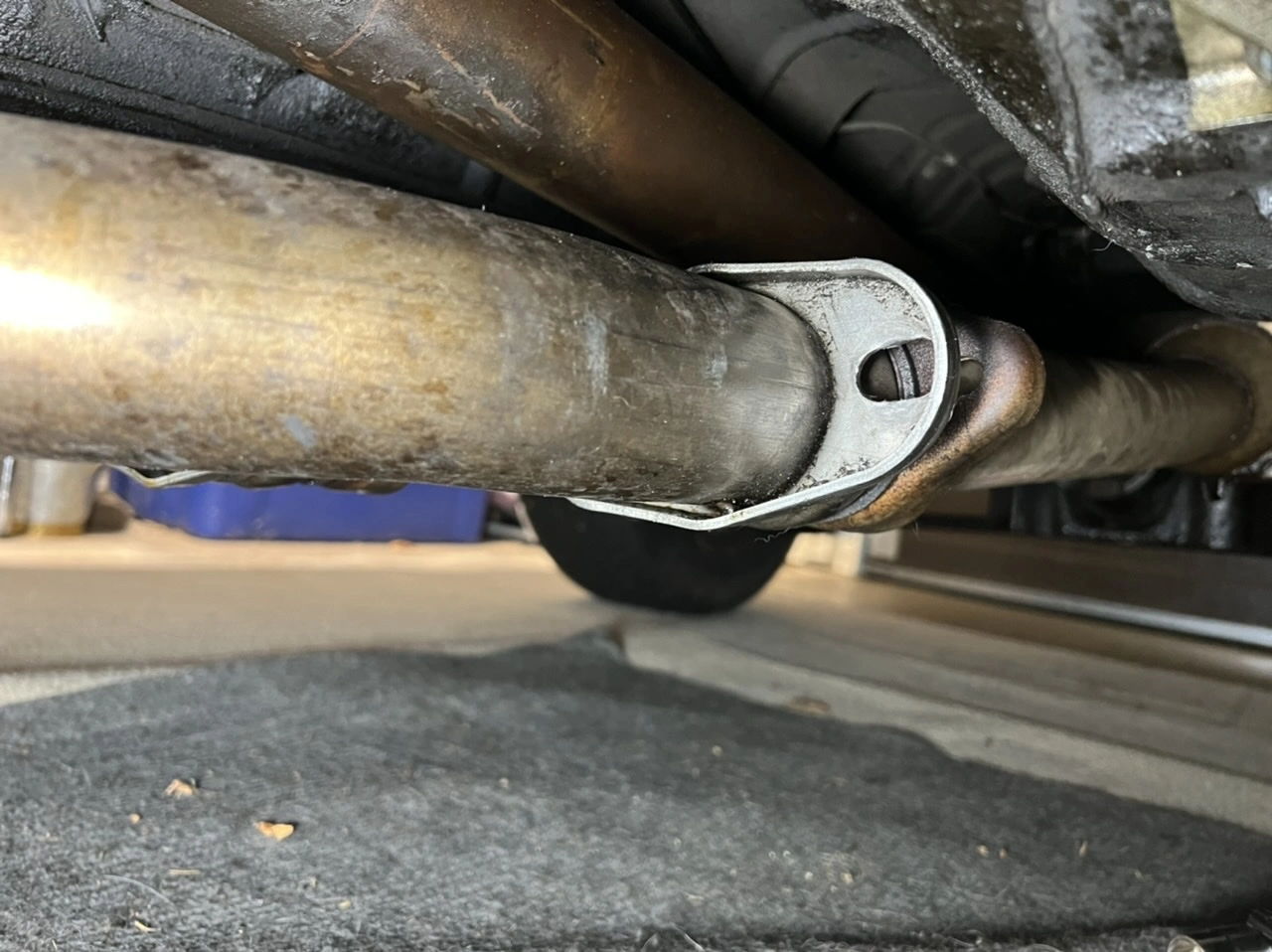

Feb 9, 2022
#963
  • Feb 9, 2022
  • #963

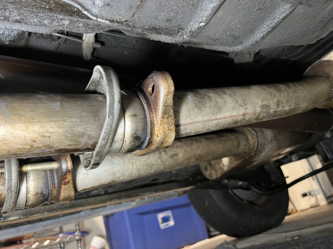

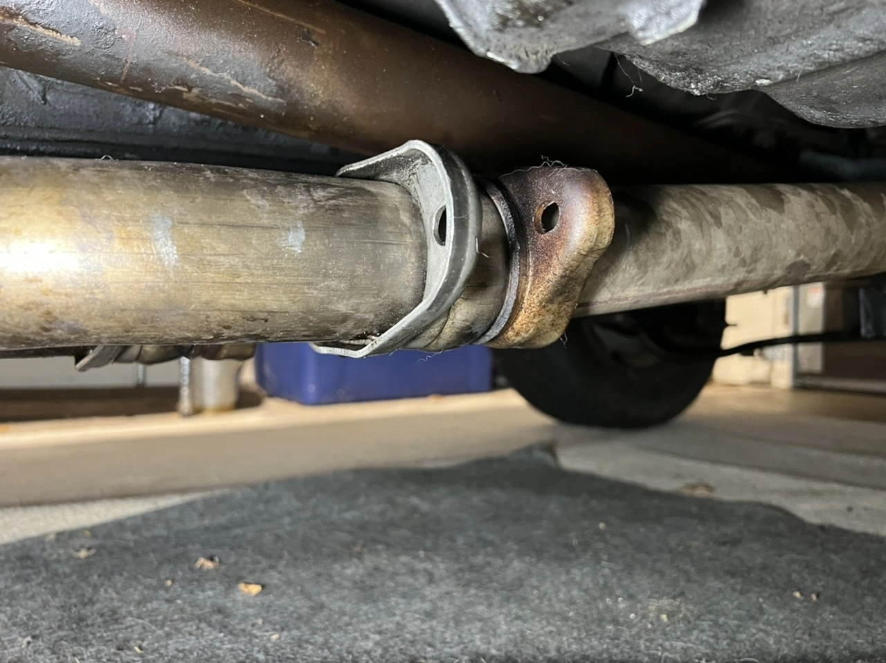

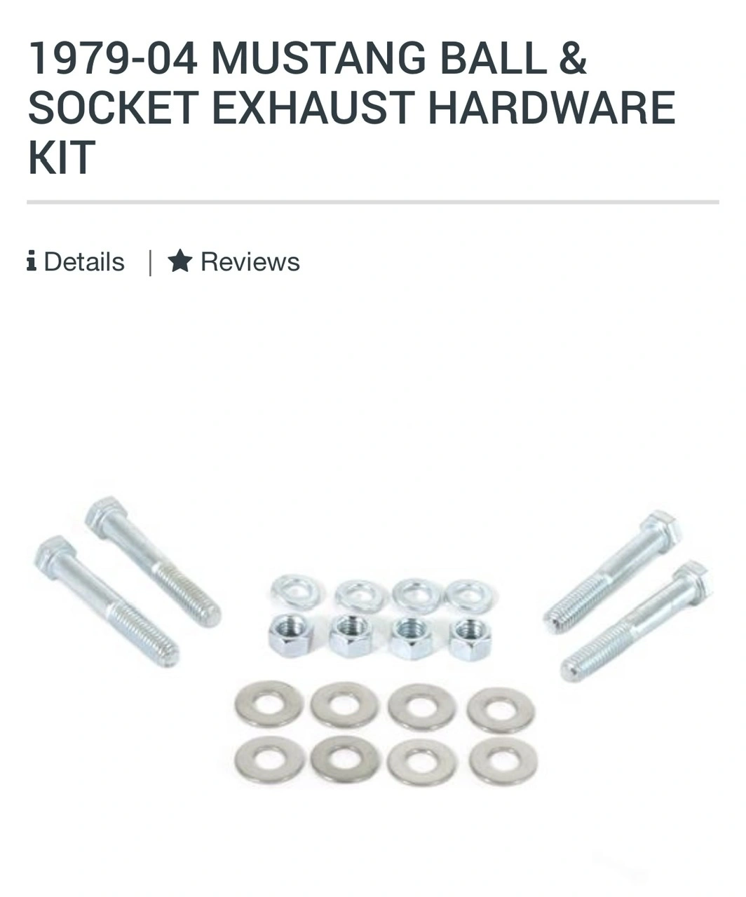

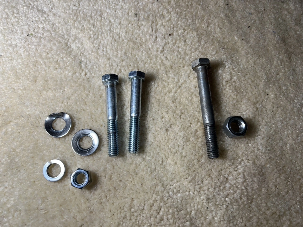

Ok, I have what’s probably a dumb question but whatever. My brain isn’t functioning properly at the moment.
Does this look like a normal ball and socket exhaust flange setup?
I’m asking because I’m trying to get the exhaust hardware tightened up and I couldn’t do it with the bolt that I had in there (one that I found to add to there when the one that was on the car stripped or broke, I can’t remember exactly). At first I thought it just needed some washers/spacers but I still couldn’t get it to tighten all the way. The nut just keeps spinning - almost like it’s stripped but it seems fine up until the end, if that makes sense.
I ordered this replacement hardware kit thinking I would eventually just update all four bolts on the ball & socket but the bolts seem a little bit short and thin for the flange openings.
When I tried one of the new bolts, I basically deformed the included washer (you can see it in the pic below) trying to tighten it down enough. It was being sucked/crushed into the oval shaped opening on the ball and socket flange.
The bolts on the left are the new ones and the bigger one on the right is what I had on there, which isn’t working now.

Those new bolts are too narrow. You can pick up some bolts, nuts, and washers from tractor supply down rt3. I use high temperature red or copper permatex sealant at all exhaust joints now. Guarantees a leak free seal. You'd have to take both sides loose and apply to inside of female flanges. Bolt up and clean the sealant off with a rag while it's still wet.
I'll have a lift at the new house soon.

I agree with sicko there and will add grab some thicker washers or stack a couple/ three to help with the deflection, I have to say the mid pipe looks larger than the tubes before the mufflers and that ball does look large. It should still work

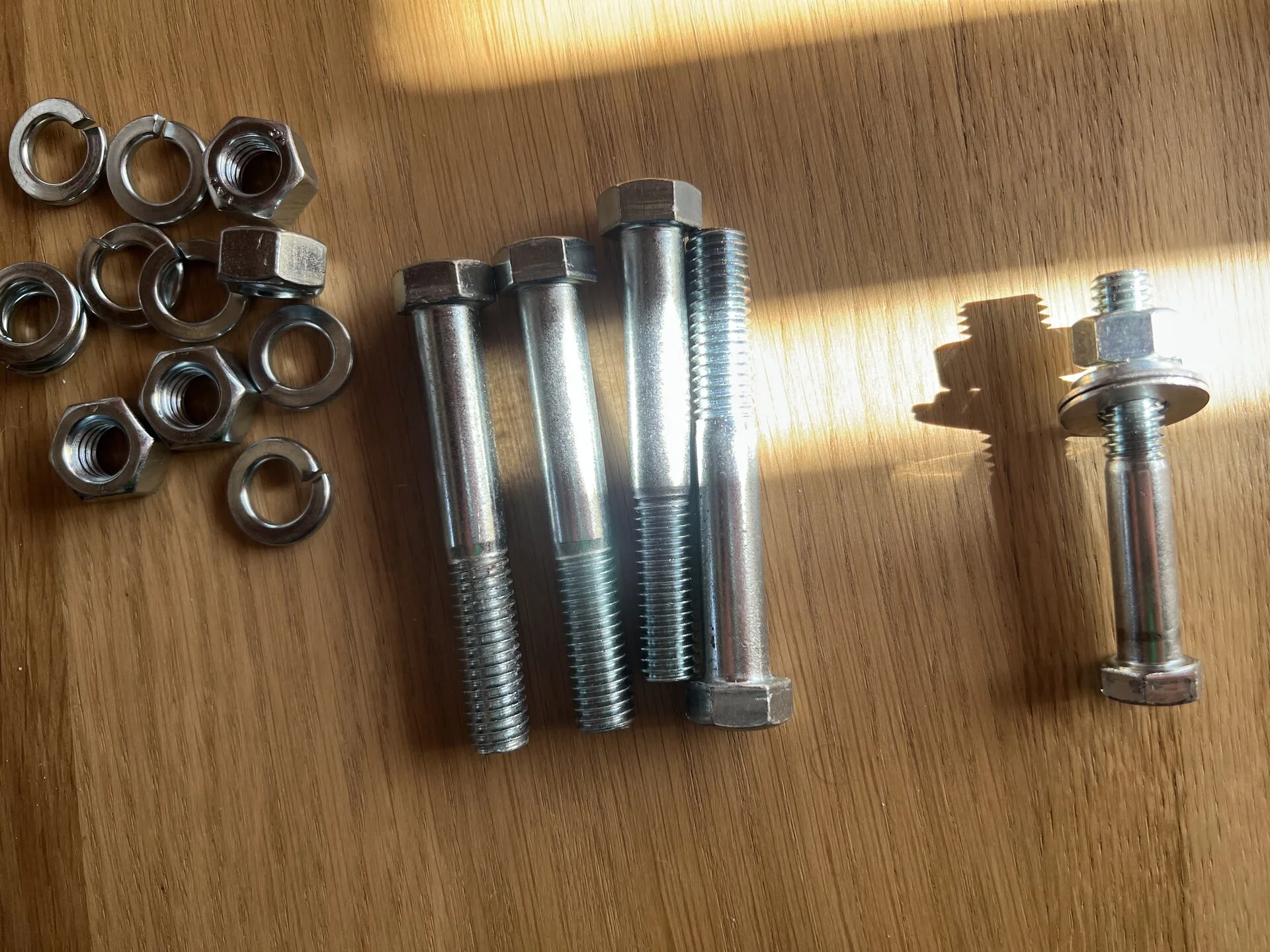

Stopped by Tractor Supply and picked these up. Thanks for the suggestion. Will try to pick up some permatex tomorrow and try to make time to get the exhaust leak sorted out while the weather is reasonable.
Karthief, maybe I will measure the exhaust on both sides to see if there’s a difference. I am trying to resist the financially irresponsible urge to get new headers and just redo the entire exhaust. Must focus on one thing at a time..

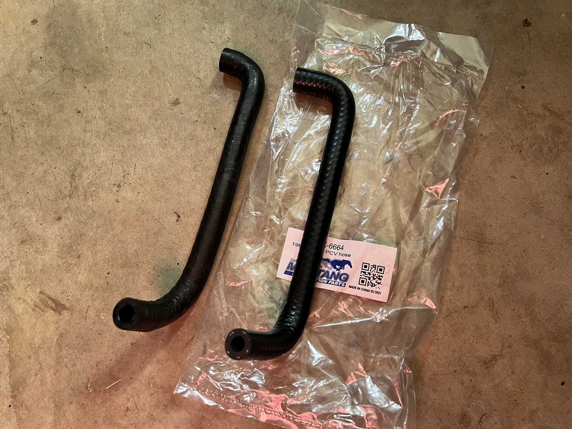

I haven’t had much time to work on the Fox lately but I can’t complain too much since I have a good excuse:
Yesterday I found a little bit of time to replace something small - the PCV valve hose:
It’s hard to see in the photo but the old one had some small cracks in the bends. You can kind of see them in my latest Vlog, which I uploaded yesterday:
View: https://youtu.be/wBz1R2_7SIo

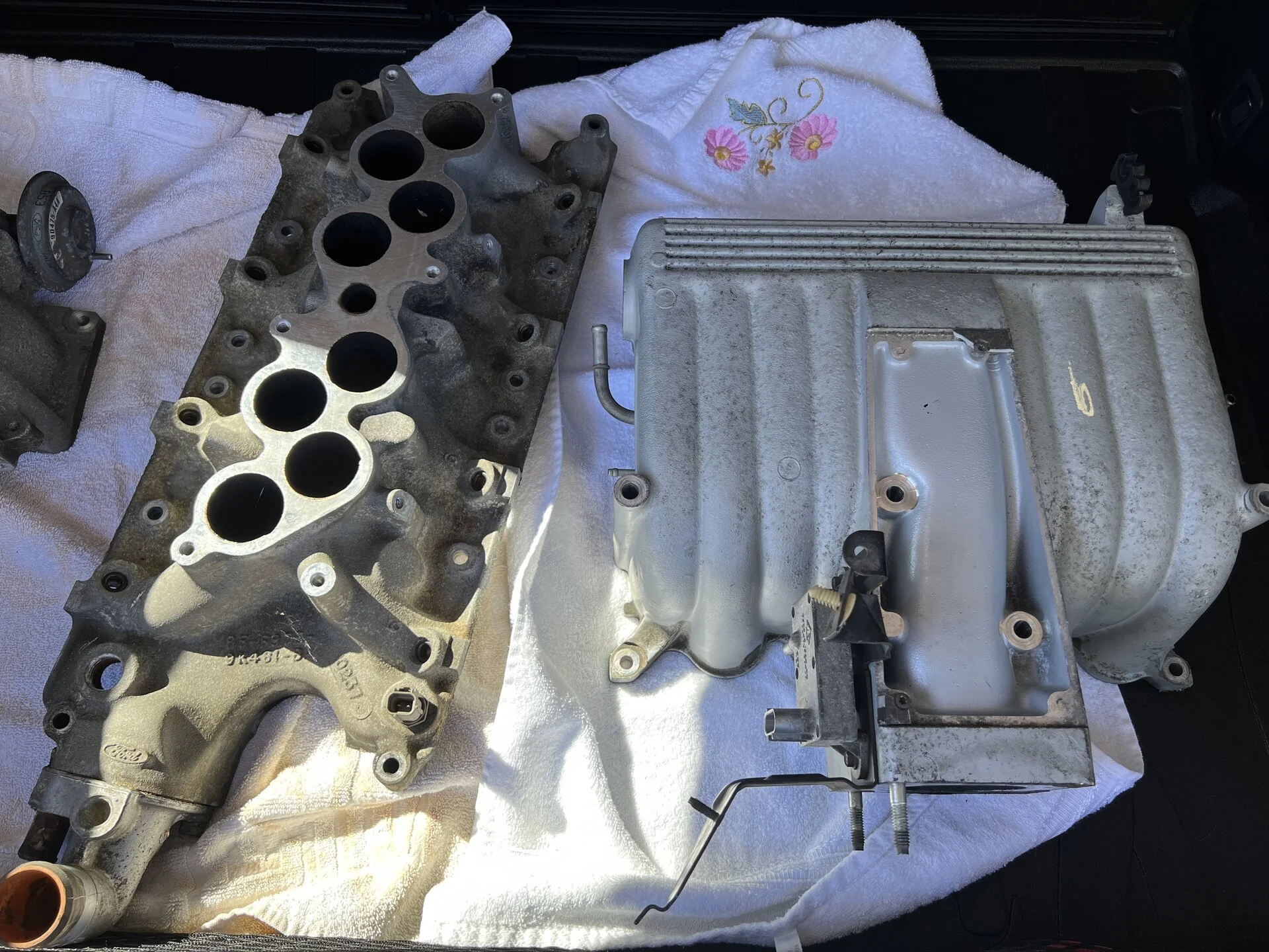

In other news, I found this on craigslist for pretty cheap so had to pick it up today.

Explorer intakes are good for what they are. The price will go up on them as time goes on. They're getting harder and harder to find.

Yup, you used to be able to get them for less than $100 with injectors and 65mm TB….but finding an explorer in a junkyard is becoming harder and harder these days. Prices going up.
