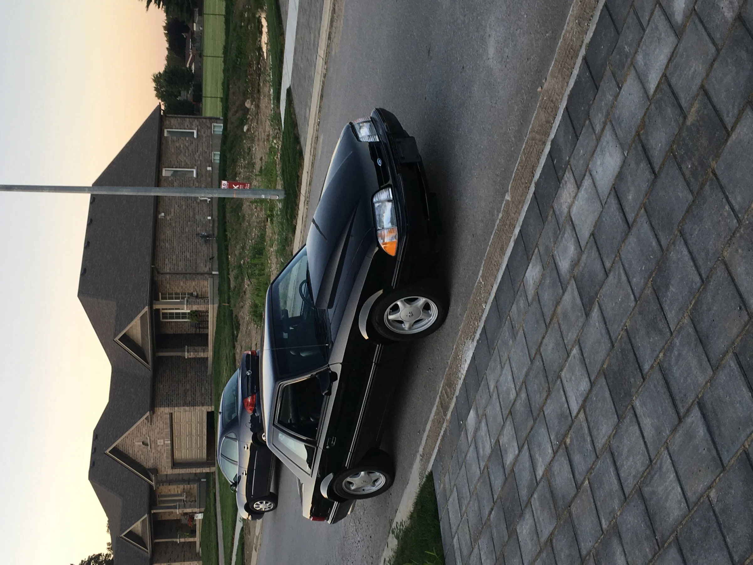

Thanks ! Keeping an eye out for a TKO lol. Very excited to see what it will put down. Here’s a picture of the car.
Sorry not sure how to rotate after it’s posted lol
