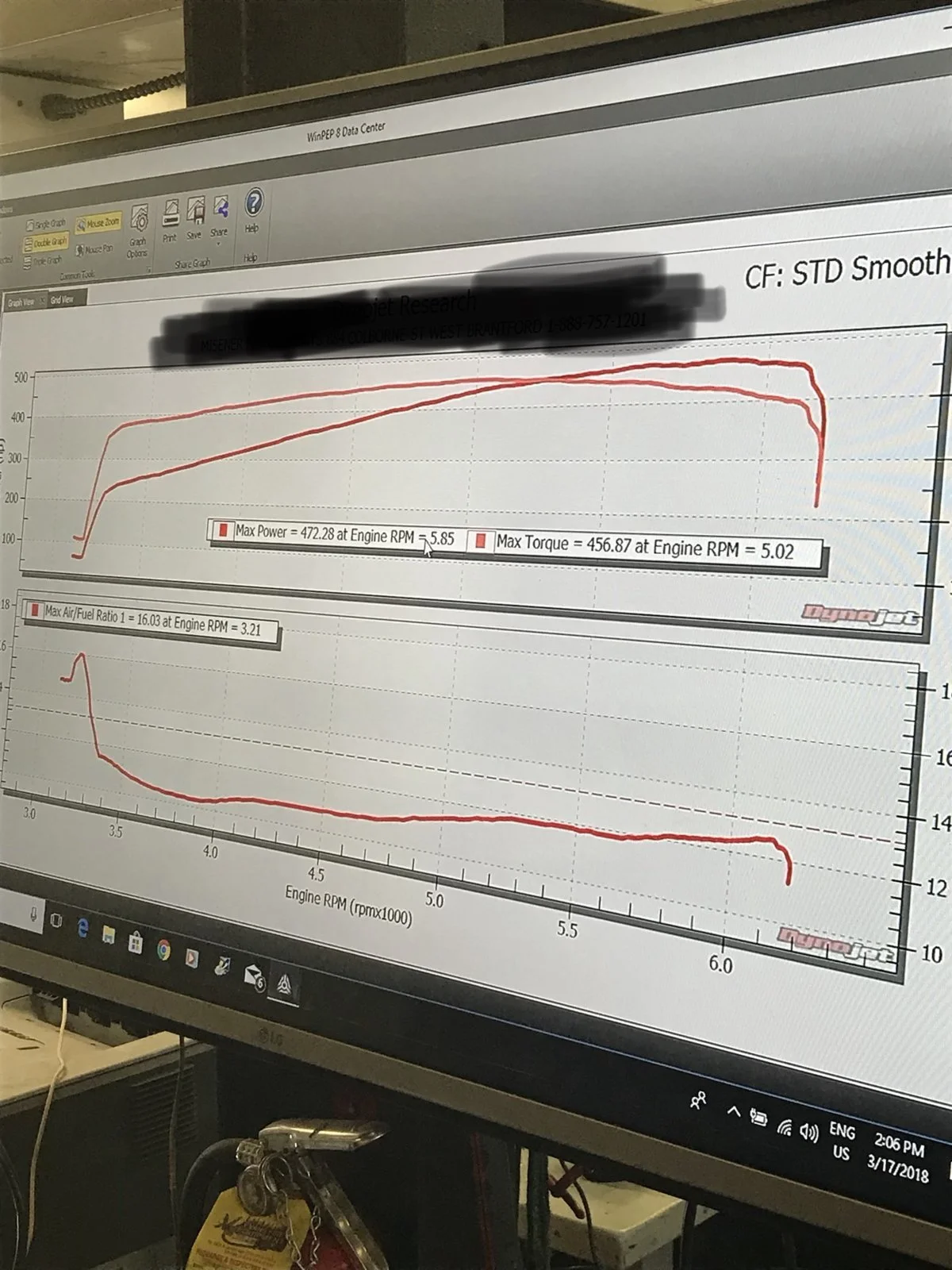

Tuner pulled plugs found 1 was cracked put it back on dyno and it made 472whp and 453 to but it was leaning out again. We switched to a 3.47 Pulley and made 445 and 444 but once again it was leaning out. He’s recommending a new line and hangers but I’m just going to get the car out of there for now.
I can post chart but AFR is around 12.3-12.5 @ 5900rpm

By all rights you should have been able to add fuel, ideally you want to stay around 80% max duty cycle. Now what was the MAF doing? What kind and size? What was the output voltage?
If the injectors still have room something was stopping the ecu from commanding more fuel, if the rails or lines were to small the duty cycle would go up with no change in fuel delivery.
MAF was a PMAS 95mm that was close to pegging out at 4.9 so we switched it to an SCT. He said when he’s trying to add fuel it’s not doing anything...said he tried to add a whack load of fuel at the top end but doesn’t change anything...still leans out.
He’s suggesting hanger, new lines and rails. It did not seem to lean out at 397hp but that was only running on 7 cyclinders.
