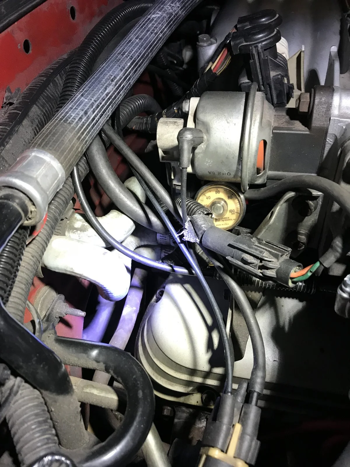

Little off topic but when the car was on the dyno it started to get a coolant leak...some was dripping down from the passenger side onto the ground. Once the car really warmed up it was actually spraying out the passenger side. Attached a pic of the area...I’m not sure if it was the heater core hoses but it did seem to increase when the rpms went up.
Right at the back above the valve cover.

It could be the heater hoses or the coolant hose that goes from the hard coolant lines to the back of the EGR Spacer. I assume you still have them hooked up based on seeing the EGR emission stuff is still operational.
Reactions: General karthief
Rent a coolant pressure tester. Or buy one they are great to have around, fill the system with water, hook up the tester and pump it up to 10 psi, let it sit on there, chances are your leak is bad enough where it won’t hold pressure, diagnose the leak, if it does hold pressure then the tester sit on the car for an hour come back and check for wetness and if the pressure has dropped. If your close to RI ma area I’ll let you use mine I’ll come by and check the car out if your not close to me, rent a coolant pressure tester from pep boys.

This cars turning into a flippin nightmare. It was the lower hose from the heater core. Father in law who’s normally more than capable changed it for me as I’ve been working 80hr weeks. Finally get a chance to take it out and car pulls hard but has a surge at roughly 3k rpms.
