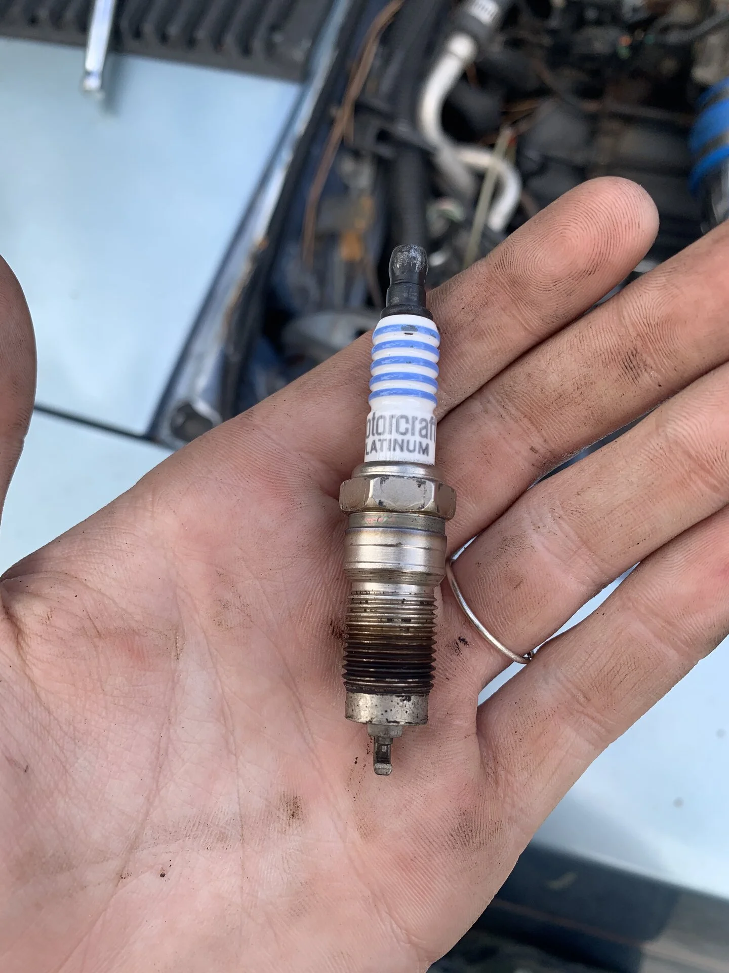

Here’s a pic of my cylinder 1 spark plug if this can tell anyone anything, they were brand new
