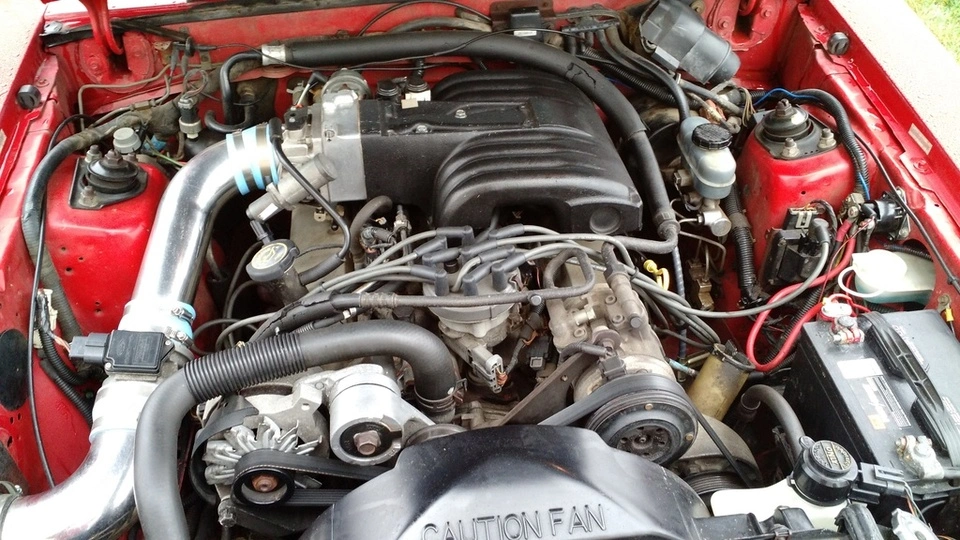

And, the engine compartment
There is a black intake manifold on there, an aftermarket throttle body of some sort (PO thought it was 70mm), a CAI. There's a nice electric fan with a very hacky switch under the dash that turns it on. It's also got a monster exhaust system, I think it's 3". I am not impressed with the quality of the mods by the PO. The exhaust was held on by wire and didn't fit right. I took it to an exhaust shop thinking it just needed some hangers welded on. Instead I got hosed and could've bought a new catback for what they charged to fix the poor fitting exhaust. I think I'd rather have a 2.5" system, but was just trying to get by for a while before spending the cash.

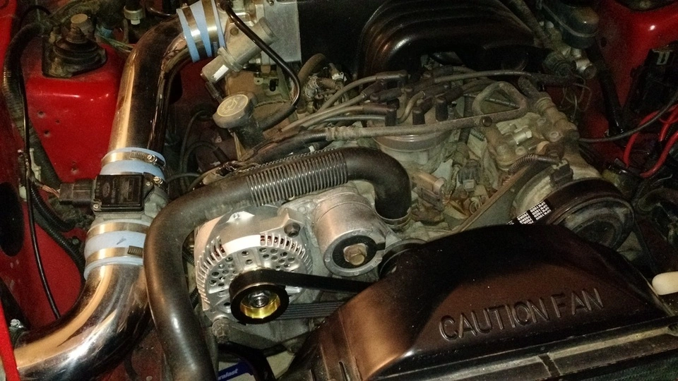

I have two questions to get me started ... of course :cool:
First, the throttle body has two nipples on it that aren't hooked up. I'm not sure what they are supposed to be hooked to and how important is it that they aren't connected?
Second, my cruise isn't working. Is there a common problem there or can you tell from the pic if the PO took it off?
The nipples are egr coolant lines. The egr is still on there. If it's hooked up and functioning then you need those lines attached for it to operate properly.
Sounds like you are on the right track. 3" if that's what it truly is is too big. Foxes came with 2.5 and he may have run 3" tails. That intake is the stock unit painted black.
welcome and good luck with the build. The lines coming off the EGR are for coolant- it is supposed to cool the EGR gases and help in cold start up; If you live in a warm climate area, you can cap them off. If not, I'm sure the PO plugged off the two lines that go into the EGR plate. One is on the passenger rear lower intake pad and one is coming off the hard coolant line..Simply by some new rubber hose and hose clamps and hook them back up.
I've been looking at the exhaust a little more. Not sure, but looks like aftermarket headers and big pipes all the way back. Sounds awesome, but might not be the best. Looks like the PO welded an h-pipe into the header tubes. Not looking forward to messing with that.
Kind of looks like he bypassed it. There's a line you can see in the pic running under the throttle body that may be a bypass based on your description. Sounds like I should be hooked up, so I'll add that to the list.

I see the the aftermarket TB. I also see what appears to be the stock HO intake manifold. The intake openings on the stock manifolds are smaller than 70mm. If there's a 70mm TB on there now, you want to check and make sure the stock intake was ported to a larger size to match the aftermarket TB. It's very common for someone to slap a bigger TB on and have mis-matched spacer, gasket or intake opening. If all components are not sized to match, it's pointless and the mod can even hurt you compared to the stock setup.
Based on other stuff I've seen on this thing, I doubt the TB and intake manifold are port matched.

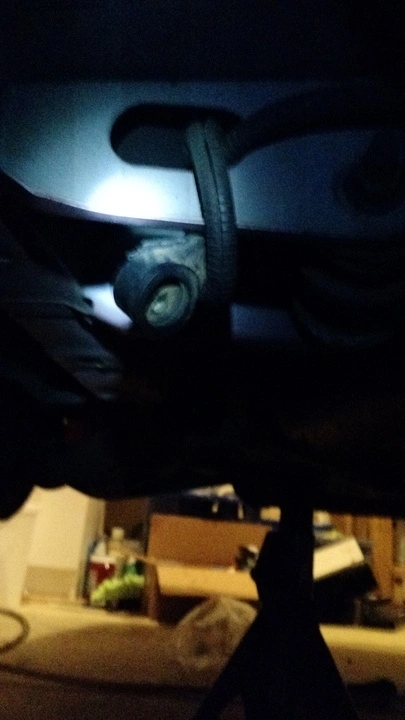

While I was under there, I found this. Hopefully you can see. It's a round connector with two female sockets in it. Tied to the trans cross member. Anyone know what it is supposed to be hooked to?

That plug looks like the reverse light switch. Was the car always a manual? Could be a hacked up wiring from a tranny swap.

Next issue caused by the moron ... Err ... Previous owner involves the reverse light switch wire that is hanging under the car. The neutral safety switch is installed where the reverse switch should be and vice versa. I was told a new clutch was installed, but this points to more than that. A rock grinder sound has also started when the trans is cold. Could be throw out bearing or could be internal. It's pretty bad when the clutch is released in neutral. But also makes the sound when first driven. Seems to stop after a mile or so. I hope this idiot didn't open the trans. I also hope I have found all the stuff this guy has screwed up. He didn't own it for long, so hopefully didn't have time to hose up anything else. So far, for everything I fix (or attempt to fix), I find a couple more things.
