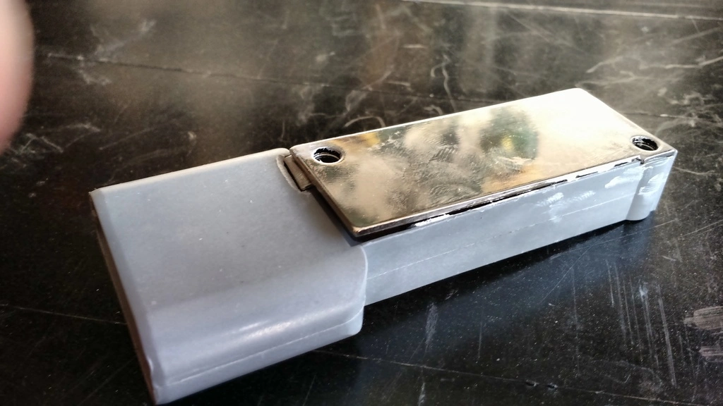

I finally had a little while and decided to try the replacement Dyna Mod TFI. I installed it and the car was missing just like the first one. In case you don't recall, this is what the first one looked like after it stranded me at the bottom of the hill near my house on the test drive and cost me a tow.
I got as far as my neighbors driveway 100 ft. from mine before I backed up and pulled back in mine. This is what it looked like after around 30 seconds of run time.
You can see some of the black goo already trying to make it's way out of the TFI and rip the back off again. If I gave it another minute it probably would've blown the back off and stranded me like the last one. Makes me kind of want to get rid of the PDI "Screamin' Demon" coil pack I put on also. I really don't want anything PDI on my car.
I now keep a packet with a spare TFI, the little wrench and a distributor wrench in the glovebox. I can change one of these out quick now. Most of the time is spent cleaning up the goop.
where is the dielectric grease?

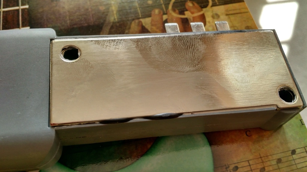

It came with it's own goop. Already cleaned off so I can hopefully pack it up and ship it off for a refund. The fingerprints are the remnants. I put their packet on, it made complete nice contact. There was some minor squeeze out upon installation and a nice contact patch left on both sides upon removal. Not the problem unless their supplied goop doesn't do the job.

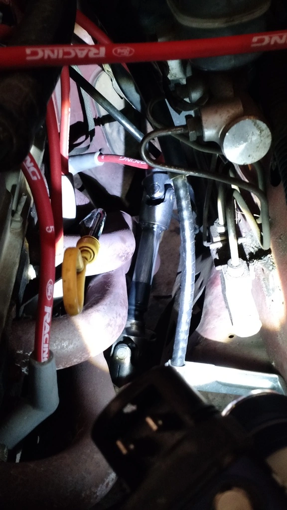

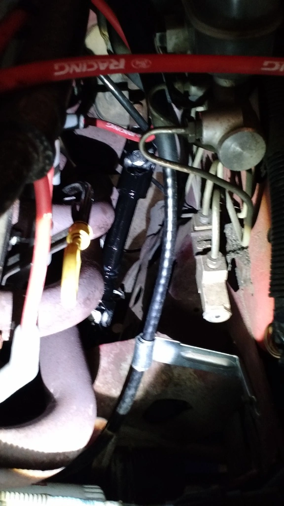

Here's the MM steering shaft after declaring victory over the ***** thing. It's the shiny thing next to the header.
Next I cleaned it up and hit it with some POR15. Now it's the shiny black thing next to the header. My paint job isn't show car worthy, but should keep the rust at bay. Good enough it won't be embarassing at the local cars & coffee either.

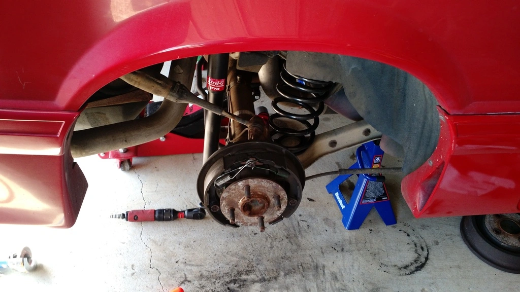

Today I finished doing the rear springs, shocks, and rear axle bearings (w/fluid change). I'll start with the result, no more '70s rake. Nice level car at the right height. Now I just need more tire in the wheel wells.
First thing I did was the rear axle bearings. Drained the fluid, pulled the axles, and used a slide hammer with axle bearing puller to get the bearings out. Made a mistake here, I did too quick of a check and used the middle size bearing puller. It was just a tiny bit too big and gouged the inside of the axle a little. I caught it when one bearing flew out and I figured something was wrong. So I didn't make too bad of a boo boo. It's the small one ... use the small one.

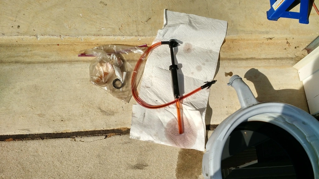

Refilling the rear-end wasn't as easy as they show on the video. My Al drive shaft and flowmasters were in the way of getting the bottle in there to just squeeze the fluid in. So I had to get out the transmission fluid pump. Ughhh, it doesn't really fit in any bottle correctly so I wind up pouring the fluid into a solo cup and sucking it out of there. By the time I finish the whole garage is a toxic waste dump. I also needed 2.5 quarts of the gear lube (plus the friction modifier), so another trip to the store to get the 3rd quart.

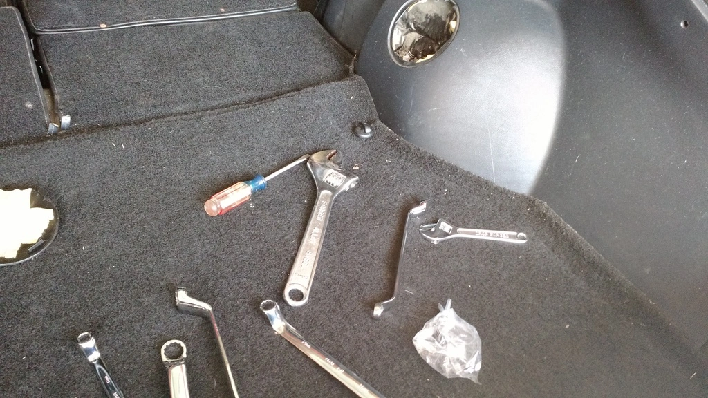

Getting the shocks out required me to go shopping again. I needed offset wrenches to get down to the top shock bolt. I needed a 15mm to get the stock one off and a 14mm to put the new one on. The wrenches are 13/15 and 12/14. Since I needed two wrenches, it was just a few more bucks for the full set.
Doing the springs ... again life is not like the videos. I had to use death sticks to get the springs in. Only had to compress them a couple inches, but still couldn't just shove them in like the videos show. Done and ready to clean up.
All the rear end noise is gone now. Plus the car feels much tighter. The only downside of all this is that I have to put the car up on a 2x to get the jack under the back GT lip. I have a solution to that in mind, but probably not this month.

Not that you want to hear this now...but if you unbolt the main and quad shock out back, you can lower the rear far enough to do both springs by hand. No compressor needed.
Nope, that's exactly what I did. I could pry the stock springs out with a pry bar, but couldn't get the new ones in. I was expecting it to be much easier based on the videos on LMR.
unbolt the quad and rear shock and place a jack under the other side of the rear end under the conrol arm and jack it up.. then the spring on the opposite side should fall out
That I didn't do. I'll remember that when I change the control arms. Thanks.
