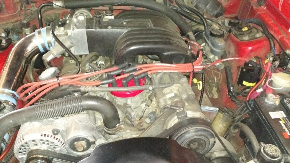

Over the last couple weeks I've done a little work. I put the SVT upgraded alternator in and that fixed the idle issues with the fan/lights etc. I wanted to upgrade the engine ground, but couldn't get enough torque on the bolt behind the head to get it off. I plan to hook up a 2nd ground, I'm thinking from where the smog pump used to be to a hole below the air filter somewhere. But, for now I can live with the way it is working. I should get the parts I need to automate the electric fan today. Got the thermostat housing with a temp sensor fitting and a ron francis temp sensor controlled fan relay.

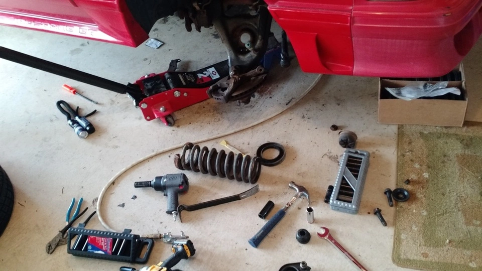

I replaced the rear seal on the trans. Now there is a sound when I move the car slowly. A squealing sound that happens when the wheels turn. Sounds like a dragging brake, but I don't think it is. Only happens after the car warms up and makes noise at slow speed before stopping and when I start moving. If I let it glide at 3-4 MPH it sounds pretty bad. I suspect it's the driveshaft spinning in the trans. I plan to take the driveshaft back off and see if I galled something. But, may just be that the tailshaft bushing is worn. It sounds like it's possible to just take the tail shaft off while the trans stays in the car. Is there a significant difference in effort doing that over pulling the entire trans out?
Finally got around to taking care of the squealing sound. This weekend I replaced the tailshaft bushing. I bought the removal/install tool and it was pretty easy. Here's the thread on the tool I got: http://www.stangnet.com/mustang-for...hing-on-your-t5-heres-the-tool-to-get.760200/

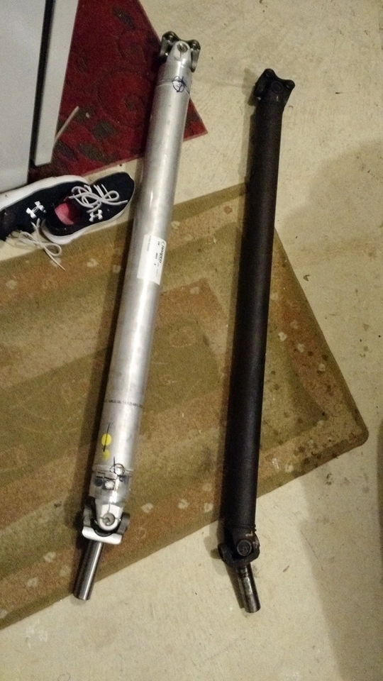

I got a new bushing and seal. I had gnashed the old bushing with ham-fisted use of the seal removal hook tool and it also scored the drive shaft yoke (not yolk). Instead of just getting a new yoke, might as well get some aluminum attached to it (my credit card disagrees, but the deed is done).
Forgot to pick up trans fluid, so hopefully I'll get it back on the ground tonight or tomorrow night and see if I fixed the problem.

Jesus Murphy, that old driveshaft looks like it was King King's anal thermometer.

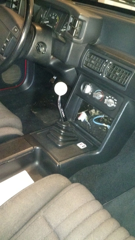

Car has a Pro 5.0 shifter in it. Overall, the shifter was too short for me. I am pretty tall and sit with the seat almost all the way back. I had to lean forward to reach the handle. Also, the PO tore off all the nubs to mount the boot and had it double stick taped on. It was on pretty good, but you could see the tape. So, couldn't resist this
