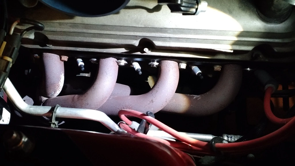

Those aren't stock headers. Shorties of some sort. Solid flange so that is a plus. I would say BBk, but that would be stamped on one of the primaries.
I haven't seen any markings, but I'll pay attention and see if I see anything on them. I also have a CAI that looks like a BBK, but has absolutely no markings on it.

First thing I did was finish the stage 8 bolt install. I did the other side. The headers didn't cooperate there. There were 3 bolts that wouldn't come out with the headers in place, they got stuck on the pipes. I didn't really want to pull the headers off so I could get the bolts out so they stay stock bolts for now. Fortunately, the two end bolts worked and some of the middle ones. With the nice thick flange on these headers, one or two bolts coming loose shouldn't be a big deal. I've put the rest in the bin for installation someday.

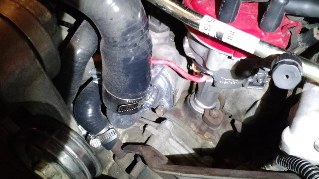

Here's the new distributor with the new wiring installed.

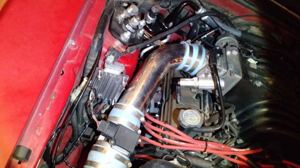

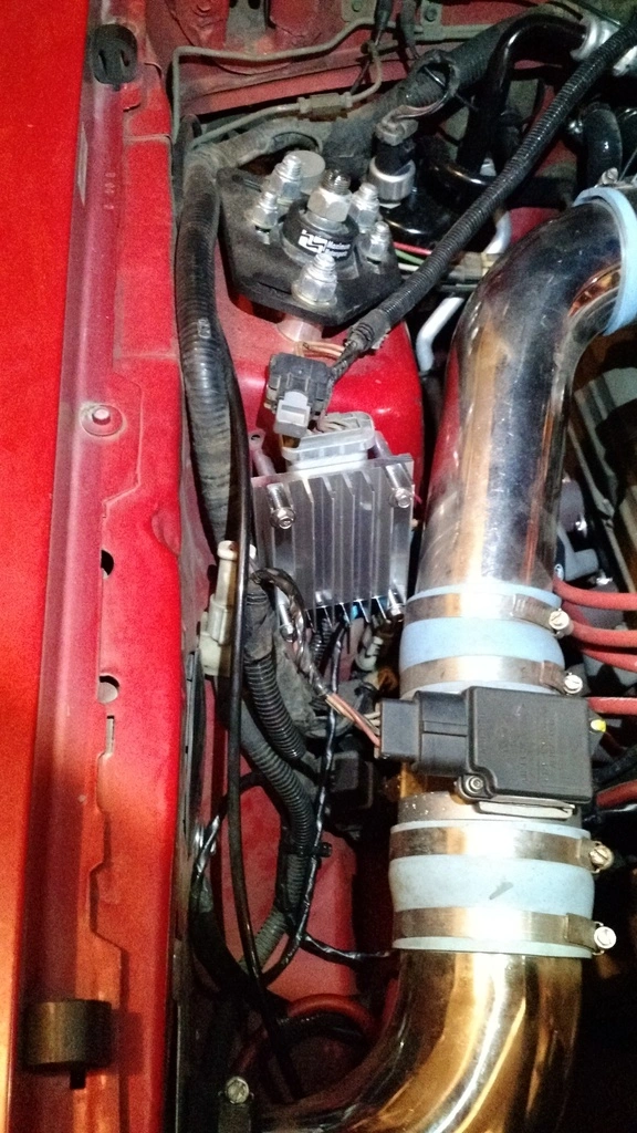

And here's the TFI module location. I was fortunate the stock wiring just makes it to this location. If it didn't, I might not have installed it. I really didn't like any of the other locations where the reach would've been shorter.
I have to admit, I'm not 100% sold on the wiring that comes with the kit. It doesn't fit great, either in the distributor or on the TFI module itself. But, I don't think it's going to come off. I need to figure out something on the distributor to keep dirt out of the connections as they are basically just open. A final pic for good measure. Timing set and test driven. Back running again. Hopefully for longer than last time.

Take the zip tie off your plug wires, get some wire separators and space them out. Keep coil wire away from spark plug wires as best you can.
Wires zip tied together cause the Corona effect and can lead to failure/strange ignition issues. Also keep them away from all other sensor wires including the tfi/distributor wiring, it can cause voltage bleed to these wires affecting signals. In a recent data log I relized some of my drive ability issues were being caused by this. Everytime the #4 cylinder would fire it caused a tps voltage spike.

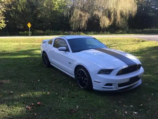

Assuming everything works out with financing and the other guy paying off his loan etc., the new 2014 GT is kind of neat. It's a base GT, but the guy did a lot of stuff to make it an autox/track car. But, once he got it together, he found a deal on a Boss 302. So he swapped all the expensive stuff he had bought onto the Boss and put the guts of the Boss onto the white GT. It has Boss 302 springs/shocks/sway bars/exhaust/wheels/brakes/rear axle with Torsen/control arms/radiator/oil cooler, and the track key. It should be a good starting point for me to go have some fun with.
