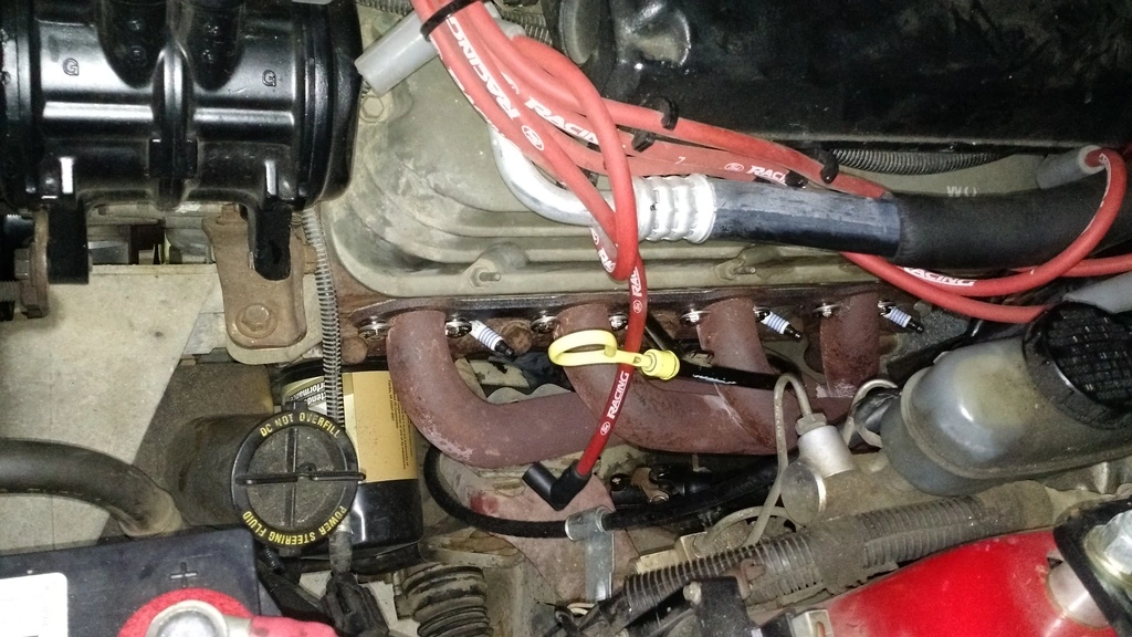

I had a free couple hours, so I started putting the stage 8 bolts on the headers. It's a tedious high curse count job. I got the driver side done. I had to grind a little off about half of the securing rings to get them to fit. There are kinks and weld boogers on the headers that prevent them from sliding on. I don't know what headers these are, I'm assuming stock. The other side looks to have easier access so I'm hoping it will go a little faster. Those brake lines really tear up your arm when you get back there.

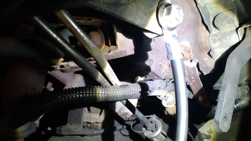

Next up, I attached my additional ground. I really wanted to get to the cast mounting point instead of the one on the alternator bracket, but I haven't been able to figure out what the thread is on it. A 3/8-16 will start, but doesn't go far. It's definitely not a 3/8-24. The alternator bracket is a 3/8-16, so that's where it is for now. I tried some random metric bolts I have from various Miata parts, but none are quite right. One is close in size, but way too fine thread. It might be a coarse M9? A known M8 is too small.
