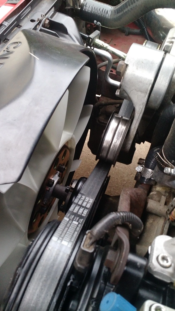

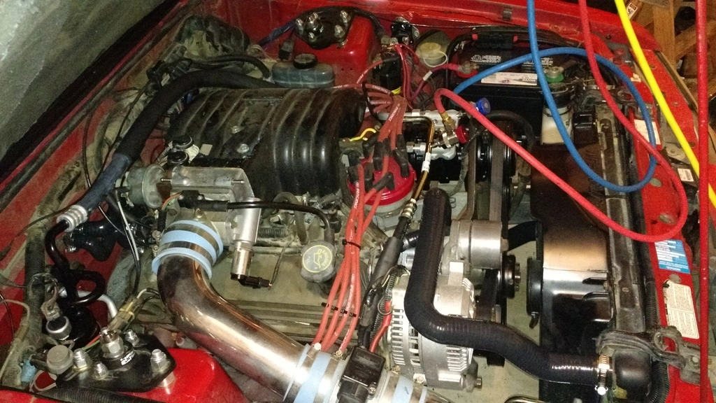

Since the A/C blew up, the compressor started making noises even when it was off. I was going to wait until next year, but now something needed to be done. So I ordered up the LMR A/C conversion kit. It comes with everything except the evaporator. Since the radiator had to be drained, I figured it would be a good time to install the SVE silicon hose kit I had sitting around waiting for a reason to get installed.
Things went pretty smooth during the install. Almost went without a hitch. But, that never happens to me.
First glitch - The instructions for the kit say the compressor is shipped dry and you should put 10oz of oil in the system. The compressor has a sticker on it that says it shipped with 3oz of oil in it. Yep, there is oil in there. I sent an email to LMR on Friday asking for advice, but no response. So, I added 7oz of new oil and installed the system. On Monday I got a response that said I should've poured the oil out and added 10oz of new oil. Doh. Too late.
Second glitch - Some of the smaller silicon hoses shipped too long. I had to test fit and trim them to get everything in right. The 4 smaller hoses are installed in tight spots. Just a 1/4" here and maybe a 1/2" there and it all fit fine. But, made the install time double what it would've taken to install a set of stockers. Especially since they are installed essentially as pairs of hoses and sometimes had to remove both hoses to trim the one that needed it.
So, I wound up here.
Pretty nice. But am I going to get things to work ...
