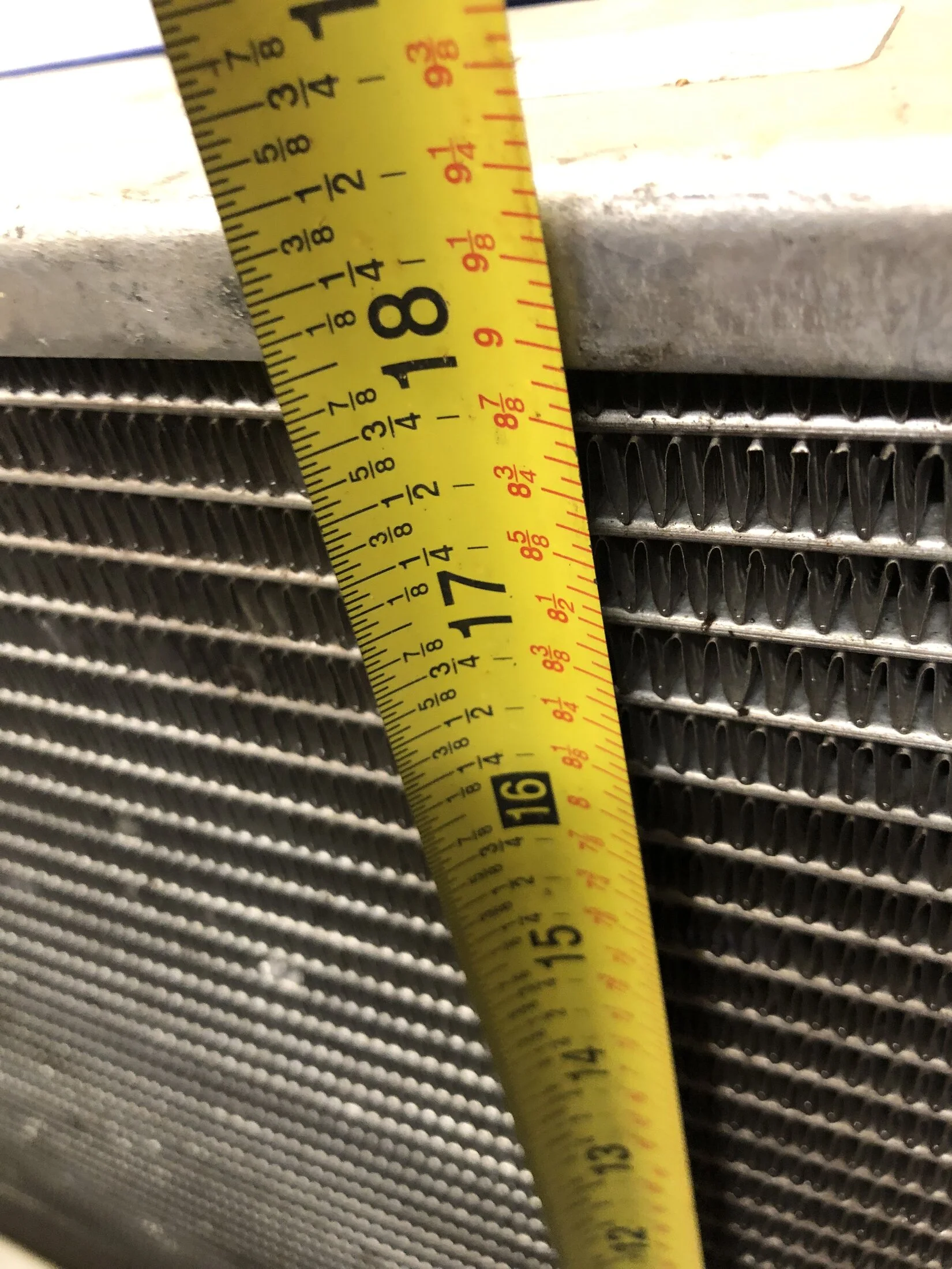

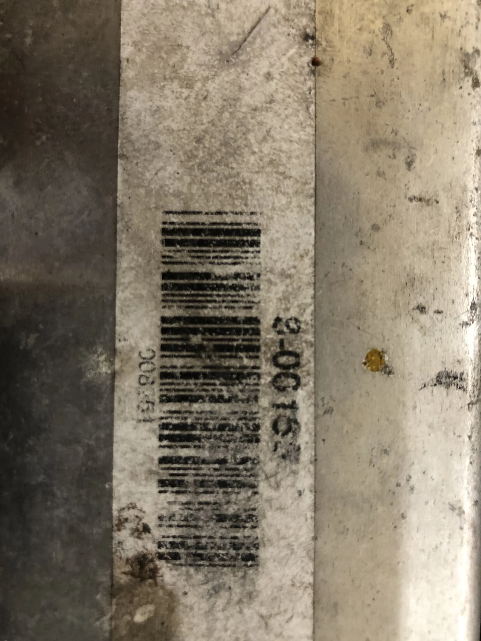

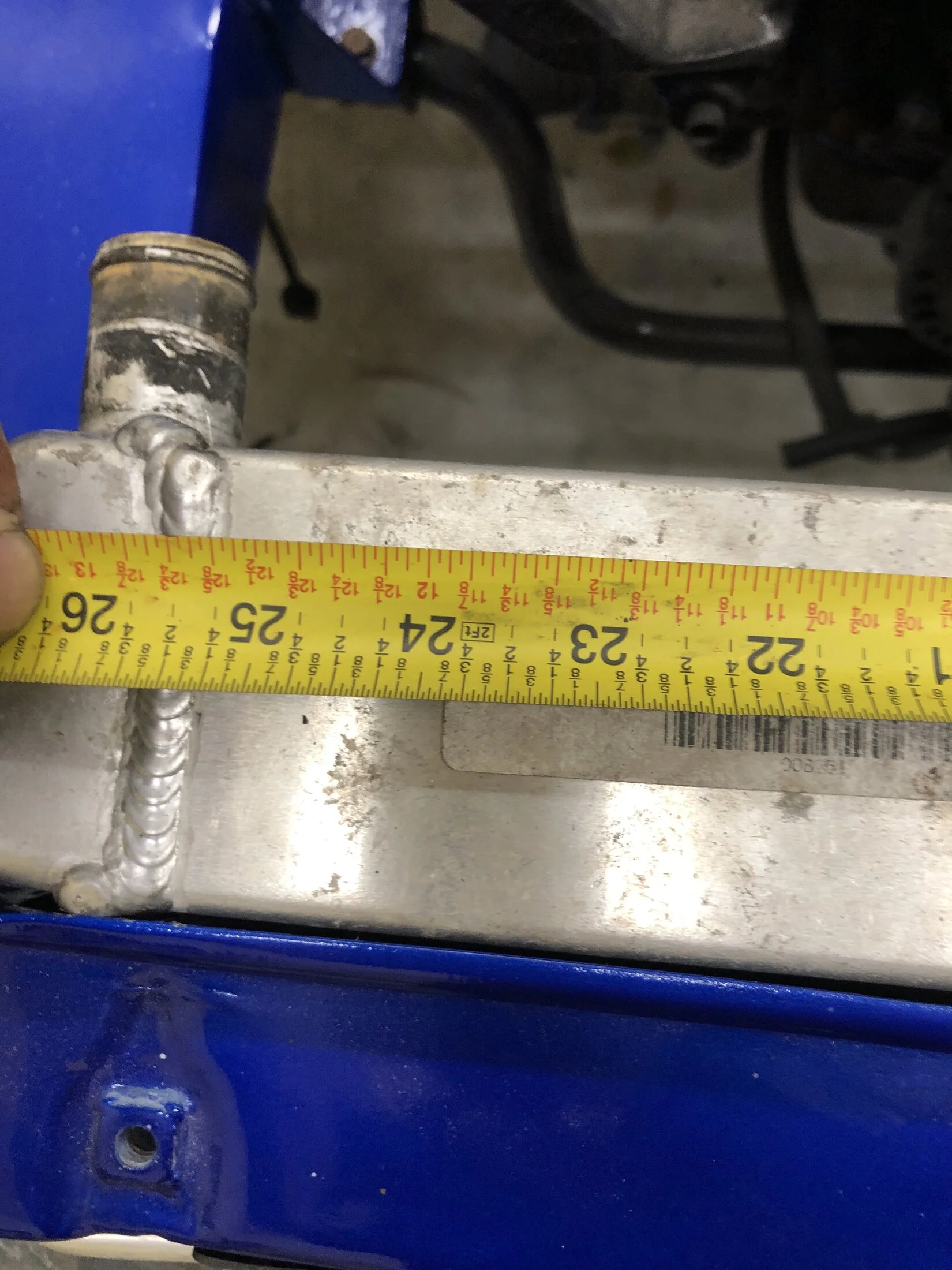

Alright I am at the cooling system in putting the 85 back together. Stock bottom end, B202 cam, aluminum heads and fitech injection. I do have a large Griffey radiator. I believe my overheating issue in the past was the coolant flowing too fast and not staying in the radiator long enough so I am also installing a flow resistor.
Biggest question is how many cfm’ s are you running. I seem to remember an engine builder told me 500 cfm for every 100 horse. But I really can’t remember.

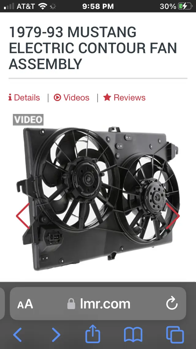

Went with the contour. LRS had the fans and kit for right at 300.00. At the rate I’m going it will be fall before the car is back on the road but I guess we will see how it goes. Maybe we will fix this global warming stuff by next summer

what jeff said..... I live in Florida and with a contour fan, 180 stat, Champion radiator I rarely get above 180- 190.... I'm prefer E fans as they tend to move more air at idle and in stop and go vs the stock setup. But get a GOOD E fan like the ones above- a Cheap Chineese one that doesnt flow at least 3000 CFM wont cut it

The fan in the pic is from late model they advertise it as 3500 cfm

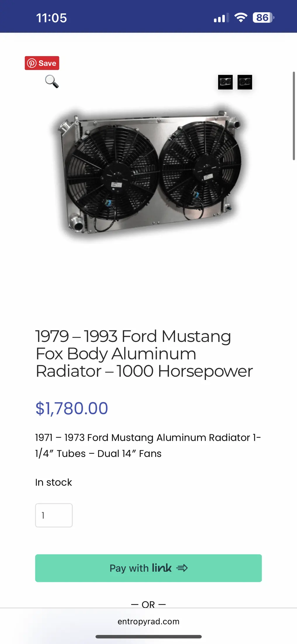

I lost my trusty mishimoto rad 2 weeks ago . I know I am nuts but I have one of these coming . I moved the upper hose to the driver side though .
-20orb in and out , going to run 16 an upper hose . 20 an lower hose . The radiator is a 2 inch tube core . The spals are 14 inches I believe . Hoping to have hurricane air and be able to idle all day long with zero air flow .
