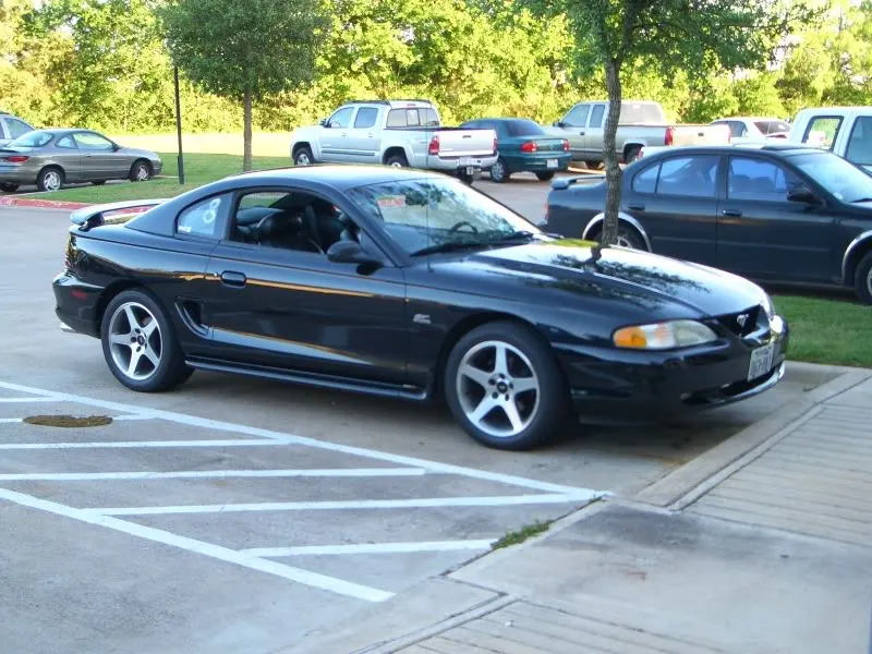

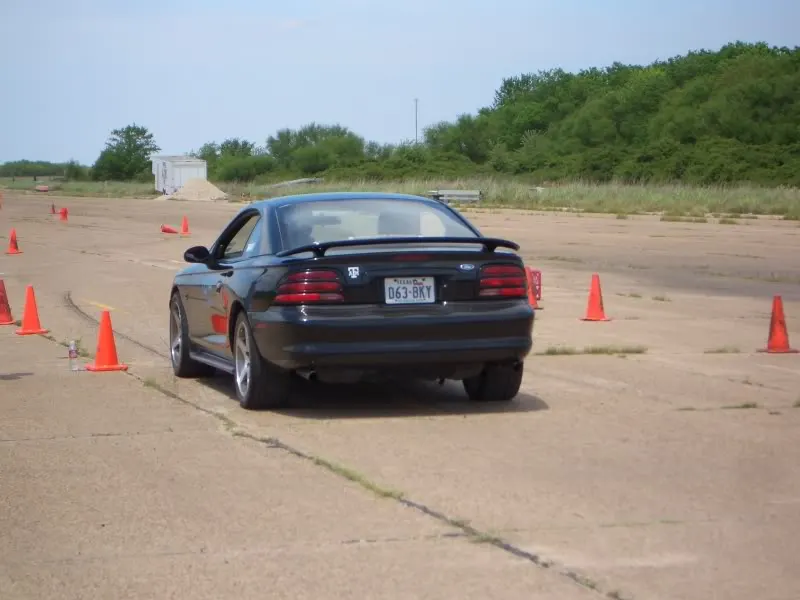

The widest wheels Ford offered were the 17x9 1995 Cobra R, 18x9 2000 Cobra R, and the 17x9 2003-2004 Cobra's. Just search through here and look for pics, plenty of people have them. But if you don't want to search...here's one of 04 Cobra's with 275/40s on my '95 GT.

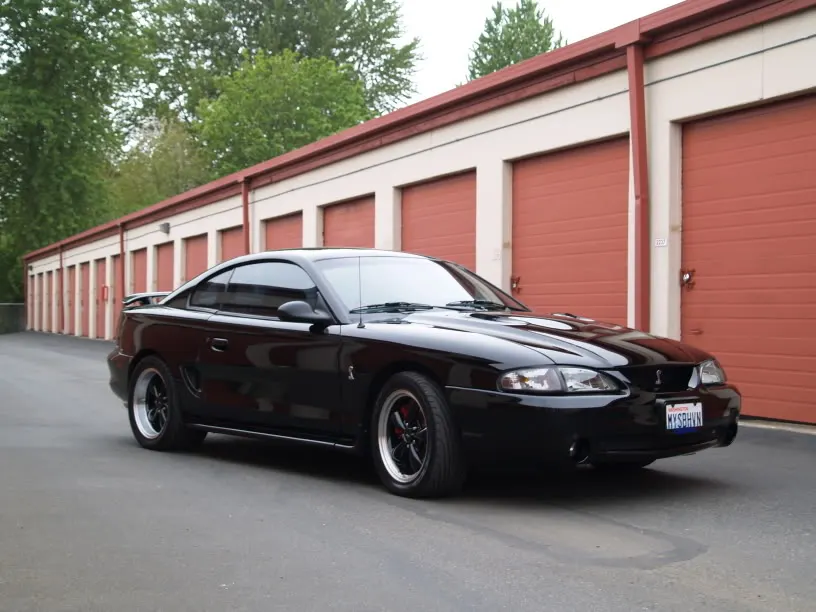

If you really want to "fill out the wheel well", you can move up to 17x10.5 on the rear. On my wife's car I used FRPP 17x8 Black Bullitts on the front with 255/40's and www.americanmuscle.com 17x10.5's with 315/35's on the back.

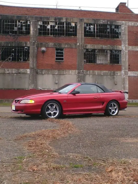

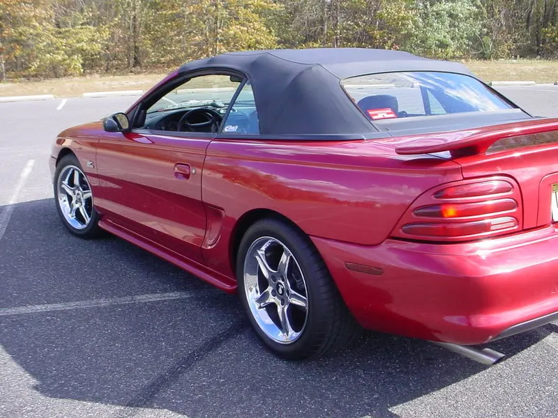

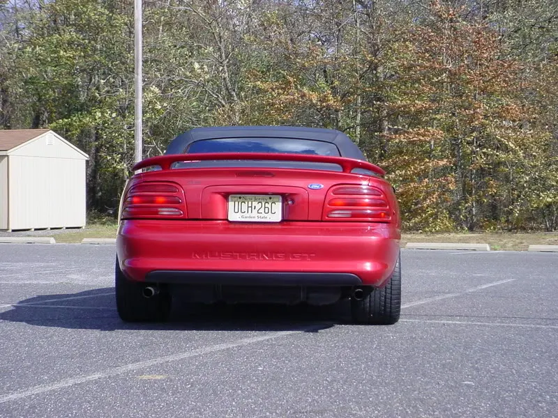

I personaly like my AFS rims... ive had them on this winter... no problems wih pealing flaking etc... good quality... i fyou keep your eyes out you can find a pair at a good price... i paid $420 for mine wiht tires with 1k miles on them.. the tires still had parts of the stickers...
