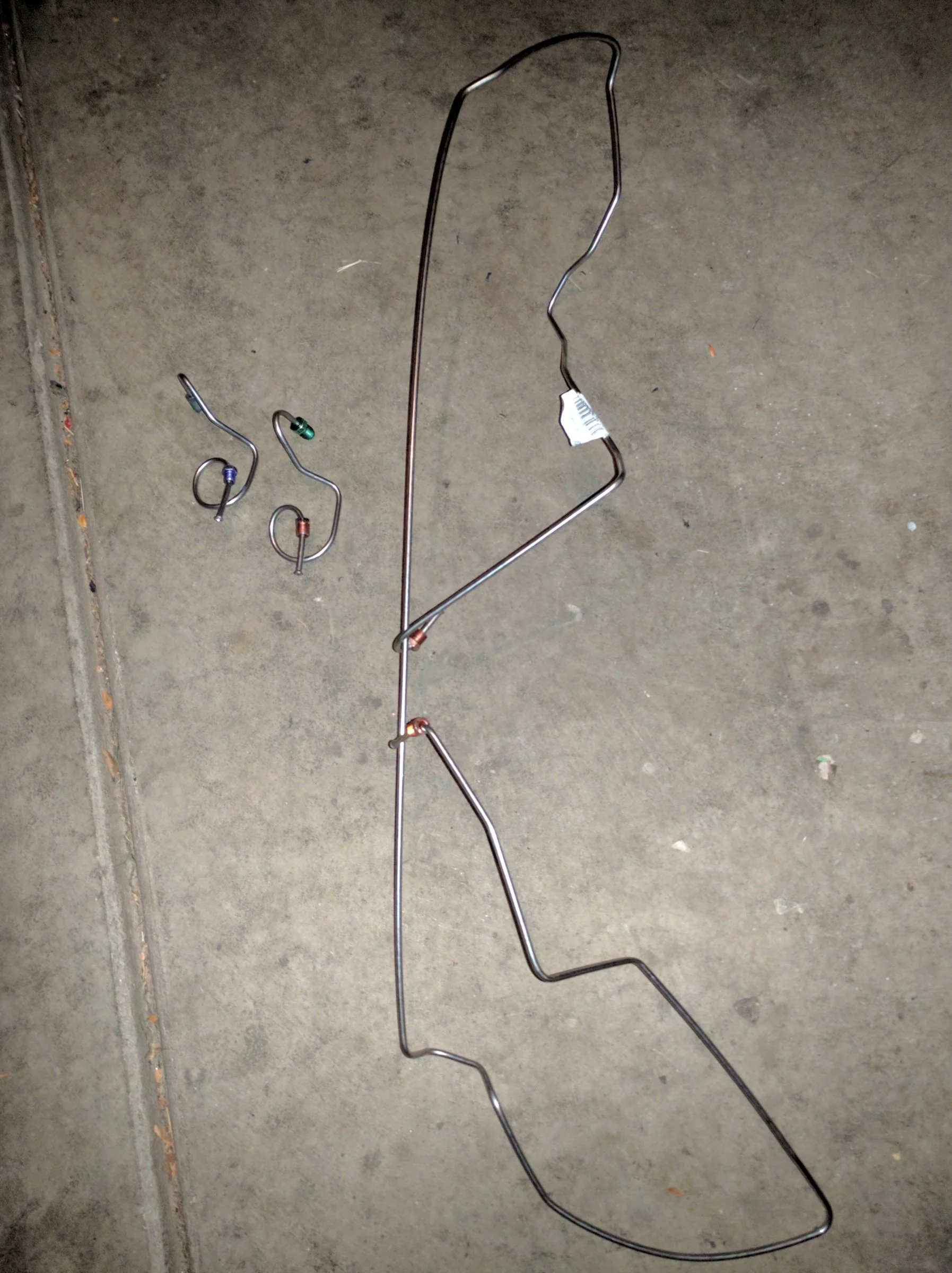

My brake lines came in:
These are the lines I didn't need, but which came in the kit. When I took this picture, the line I needed was in the car. Stainless steel, pre-bent.
First annoyance: the long line (which goes to the passenger front brake) has what they call "shipping bends", which is why the master cylinder end and caliper end are so close. Supposedly, these bends are identified by stickers. I don't see such stickers. The one sticker that's there is basically the part number, which is also on the driver's side line that didn't have shipping bends.

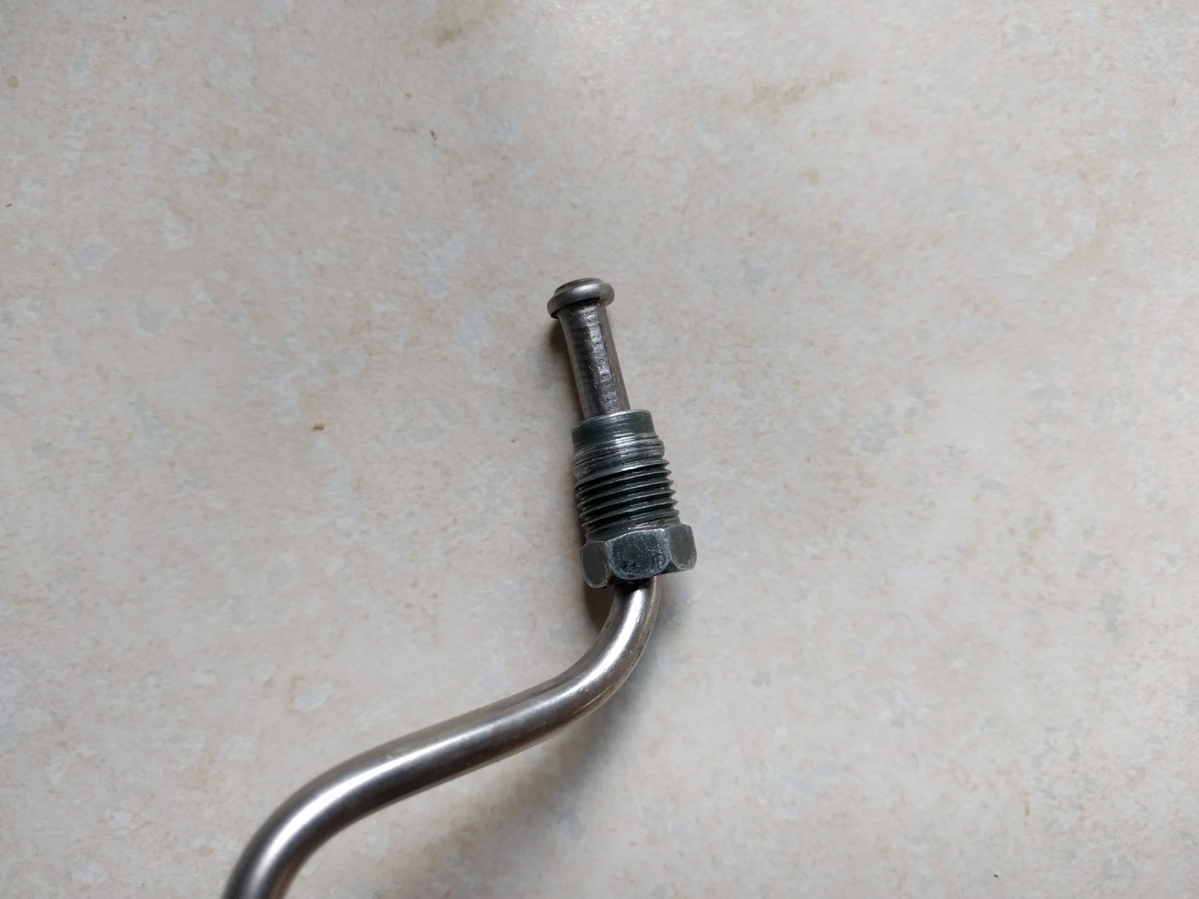

Yup. Stripped. You're probably asking yourself, "What about the end the fitting screws onto? Did he just destroy that new brake hose?" Nope--I wish. I destroyed the master cylinder end, which is equally stripped out.
Nuts. Time to order a new master cylinder.
That ordered, it was time to see if I could salvage this line. Cutting off the flare should be no problem, but can I re-flare the end afterwards? Survey says "nope, not without an expensive flaring tool." So, rather than go that route, I bought some generic 3/16" steel brake line and rented a flaring tool.
As I type this, the line is cut, bent, flared, and test fitted, and seems ready to go. The master cylinder is also loose, awaiting the delivery person tomorrow. And I have a few jugs of brake fluid. I've reviewed the instructions for bench bleeding, and apart from being a huge mess, doesn't seem too intimidating.

Have you considered running a thread chaser/tap into the threads of the master cylinder?
Harbor freight carries a decent flaring tool-cones in handy more than you would think lol

All long brake lines are bent like that so they can fit in the shipping boxes. You can unbend the, by gently undoing the bend with your hands, or buy a cheap brake line bending tool at HF. You can also use various sized of pipe, cups, containers, or other items with smooth radiuses to bend and unbend lines. Brake lines are sometimes tough to line up straight. Best thing is if you dont think they are going in straignt, stop and realign the brake line. You may be able to tap the MC back to the line size. Make sure you double flare the lines.

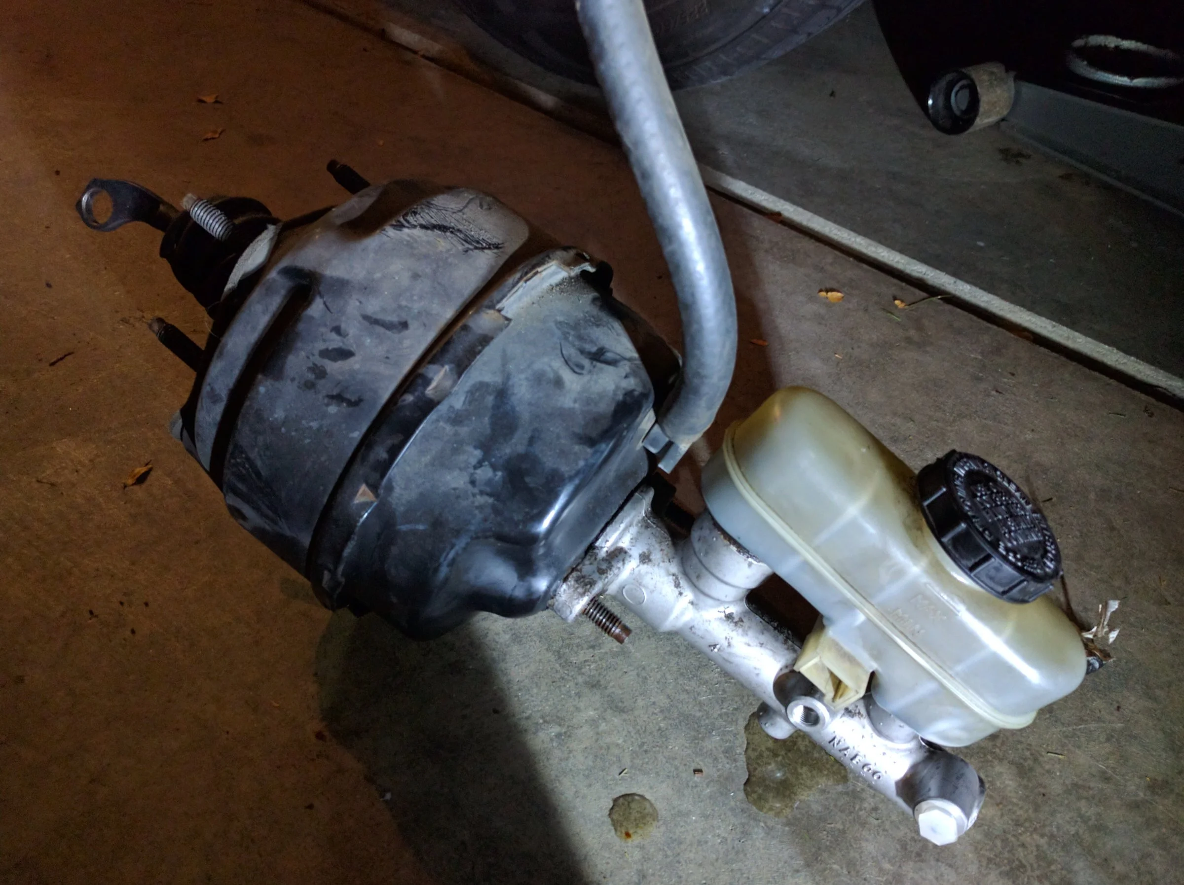

So you all know how easy it is to remove a master cylinder from the brake booster? All the videos online show it basically sliding off once the two nuts are removed.
Not for me. Dang thing is so stuck, I've broken off a chisel tip trying to force the master cylinder to separate from the booster.
I'm taking a break, because I started getting angry at it, which is foolish. I'm actually thinking the next step is to remove the whole brake booster.
Any hints or tips from those of you who have been here?
so you do have all of the brake lines disconnected right? And sprayed PB blaster on the studs for the nuts? Give the master a little love tap with a rubber or plastic hammer.
Yes, yes, and I've given the master a little love tap, and a less little tap with a little less love.

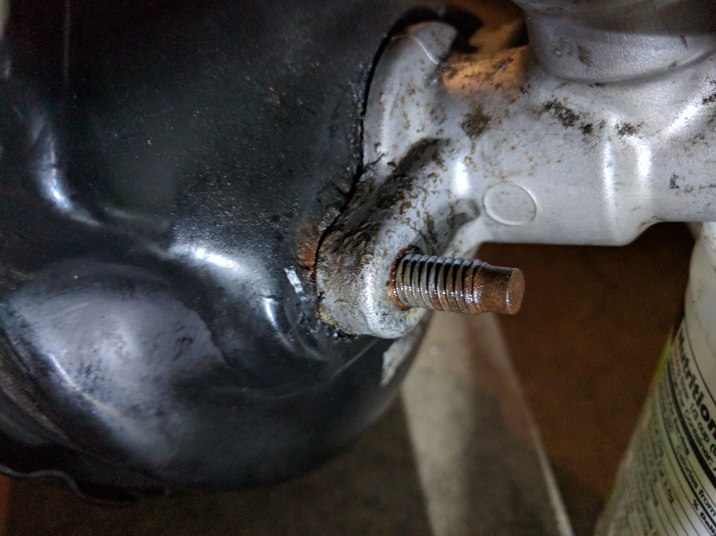

One side is loose. The other--well, if you told me it was welded to the brake booster, I'd believe you. That's the side with part of my chisel broken off and still embedded.
Didn't get to the car for a few days due to general busyness and sickness in the family, other than fairly regular soaking of the master cylinder with PB Blaster and futile attempts at removal.

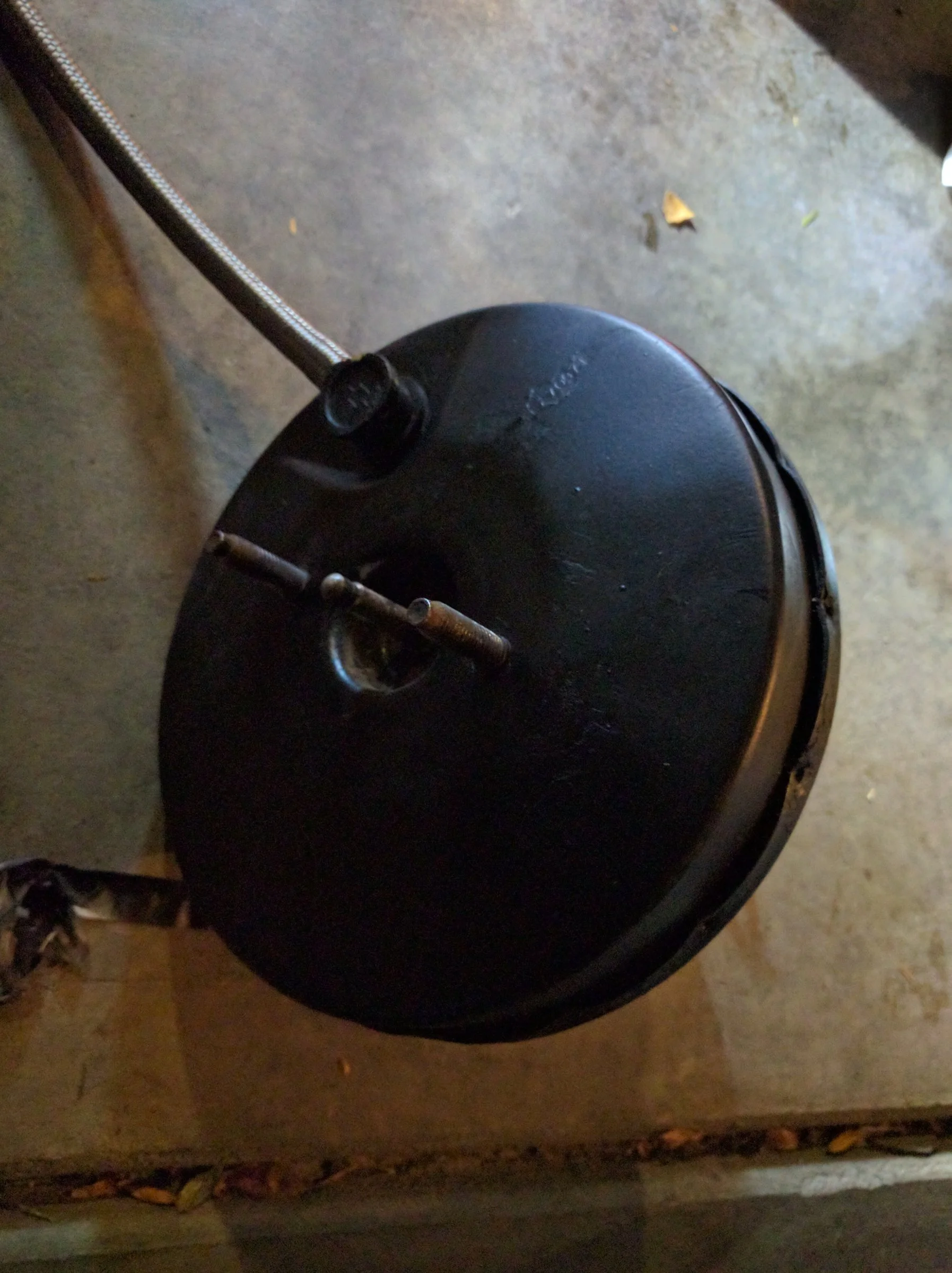

So, I took a different approach:
Haven't played much with it, but it's still holding on like it's welded on. Here's a close up of the offending bolt hole:
And Craigslist has provided me with a plan forward:
There was a little bit of rust; took a wire wheel to it, then painted it with some semi-gloss I picked up at the parts store. It's not quite the same; not sure if it's a '93 Cobra booster or just one of those third-party ones. I've got it sorta positioned in the engine bay now, but all kinds of stuff is getting in the way, so it looks like I'm going to have to take apart more of the engine bay to get it in. Which I'll do tomorrow.
I may poke at the old booster a bit more, too; if I can separate the master cylinder from it without damaging it, maybe I'll go back to it. We'll see.
If you've got that kinda stuck, your gonna want to replace the booster along with the master. Somehow moisture got in there. Don't give yourself a further headache by dealing with rust. Replace both, you never take a chance on brakes. You only get one chance to stop. Money's not worth the trouble.

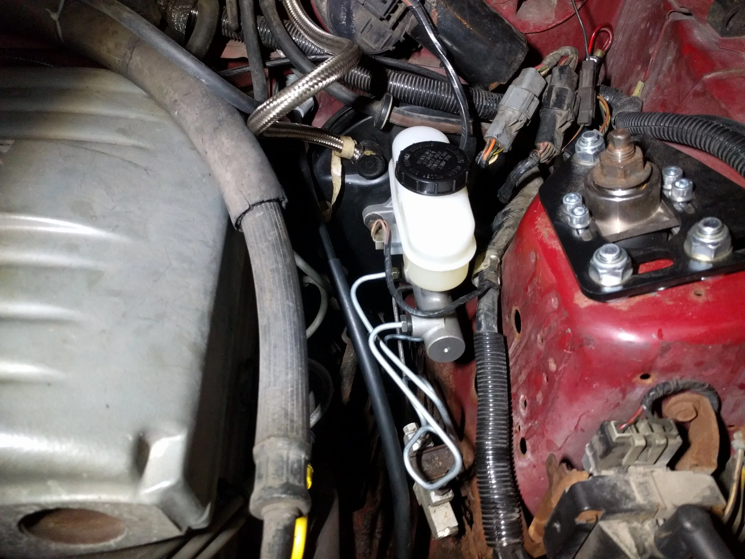

Work, work, work. Technically, I'm still under the gun, but I was getting tired of not having a car to drive, so...
Behold my new awesome brake hydraulics! Brand-new master cylinder, new-to-me weird brake booster, and hand-bent hard lines. Amazingly, no leaks--yet. I'll be keeping a close eye on those. Only strange thing is that I don't seem to have a dash light for the parking brake anymore. But they work; took it for a spin around the neighborhood, and couldn't even tell a difference from before the line failed.
