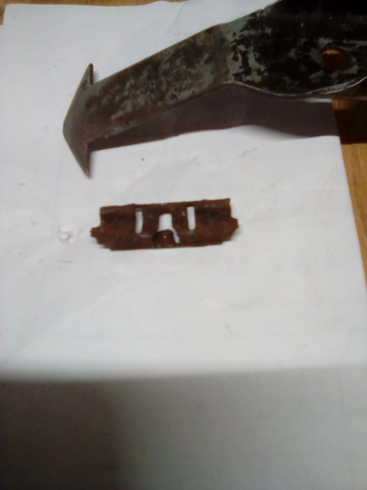

- What do the rear hatch window trim clips look like, how do they work? Which trim tool do I use and which way to pry?

There are about twenty of them, they push down onto a little stud in the channel, you'll see the slot in the middle of the clip. To get them to release the trim you kinda slid the pointy end of the tool you see in the pic under the u shaped part of the clip tilt the tool sideways, don't pry up or down on the glass, that should release the trim if you apply a little pressure outward on the trim, be careful, the trim bends easily,
there is a fair amount of butyl tape gooped around them so you have to work the tool digging around, I use a plastic scraper to shield the glass from the tool scratching it, I also take a gasket scraper to pry up (gently) on the trim, just a small amount of pressure up on the trim with the scraper and it should pop off, I start in the upper corner, across the top then down the sides and the trim will slide off at the joint at the top, this is for the rear glass, for the windshield take the top loose first, then the sides. IIRC.
You may be able to wedge a scraper and pry up a little on the trim and use a flashlight to see the clip, remember the trim is flimsy and kinks easy.
Thanks! That’s the tool I figured. And kinking the trim is what I want to avoid.

On some really stubborn clips with lots of goop on them you have to attack the clip on both sides.
I just had all of tge trim off of my car to repaint it. I always get it off tge same way, ( and it has always worked whether it’s right or wrong)
I place a piece of 1/8-1/4 thin, flat wood parallel to the trim and lift on it with my fingertips until i can determine where the first trim clip is. stick a large flat screwdriver or trim panel pry tool under the gap, and pry the trim up being careful not to tweak or bend it. the wood protects the glass from break8ng.It’ll pop that clip off of the stud it’s setting on in some cases, and will slide out from under others

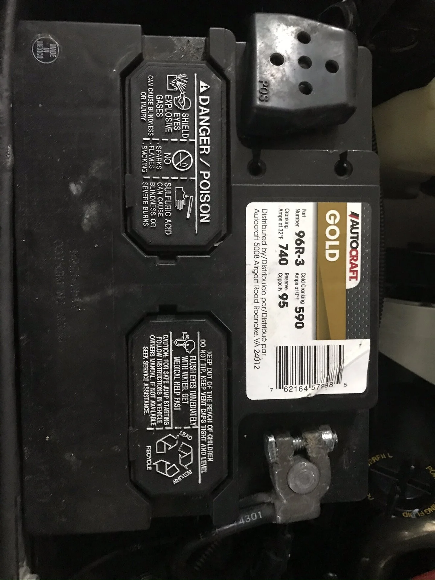

The battery for our recently acquired 96 fox is way smaller than the tray. The parts store said the correct size was discontinued and the new one was the only recommended one. The 86 tray is a little smaller than the 88 tray. The HD down is useless but I have an idea for a custom one.
My '86 is also in a storage unit right now, so I can't easily access it. It has a larger-than-stock battery in it that does fill the battery tray. The downside is that the stock battery had a molded tab at the bottom that the stock battery clamp snugged over, and the new battery doesn't. The battery clamp is now snugged against the side of the new battery, but not as secure as the original.
Bill
I found a picture of my battery, an off-the-shelf battery from AutoZone:
