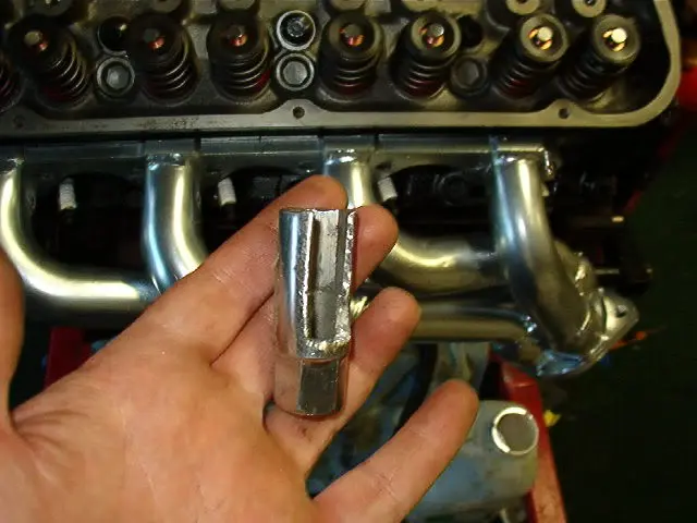

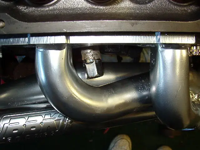

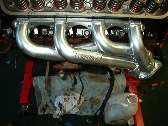

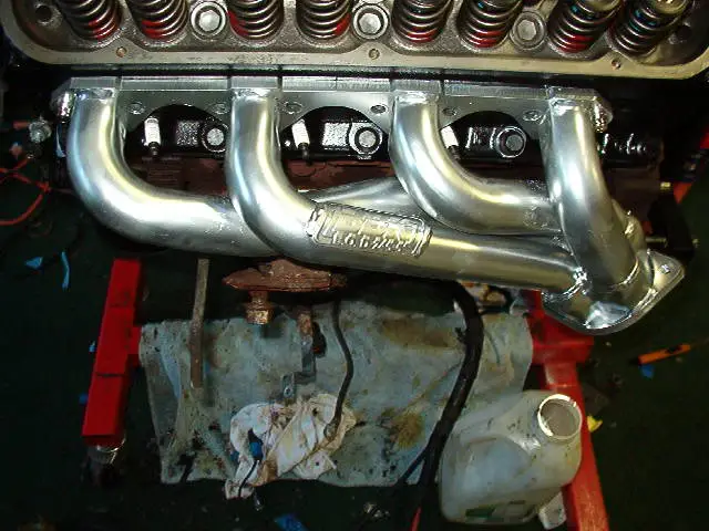

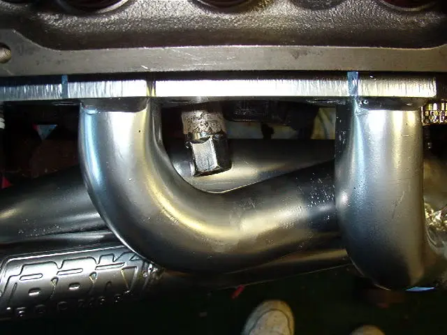

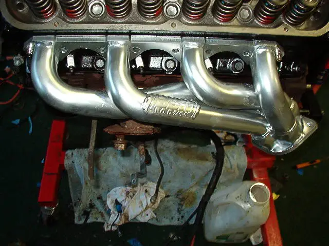

put the headers on tonight, i was wrong about #3 plug, u can get to that just fine.. its only the #7 that you would have to amke a special socket for
headers bolted to heads
socket i made (just cut a slit in a normal plug socket)
clearence with socket on the plug

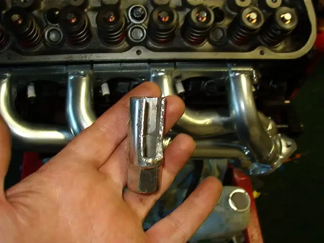

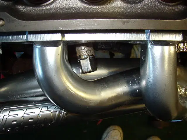

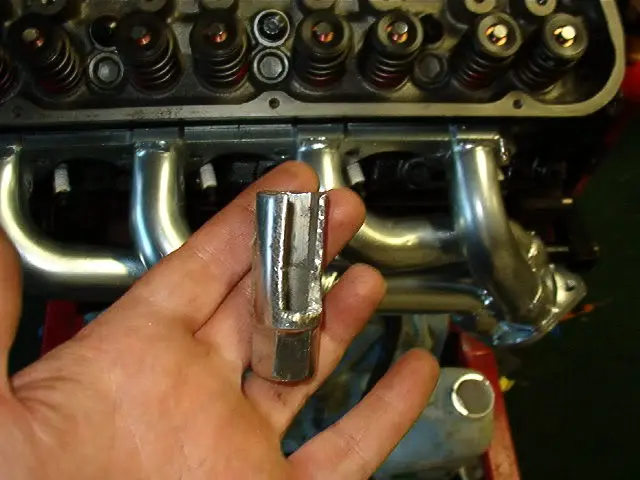

Which bbk part number did you use and is the setup working good for you now?
