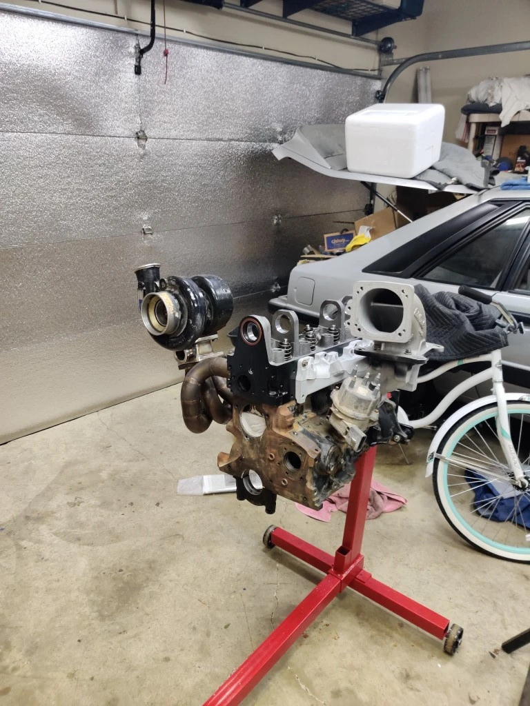

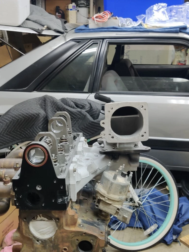

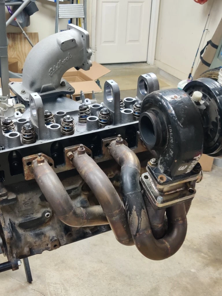

Well, I mocked up some stuff today. Trying to make a 4150 throttle body elbow fit to the lower intake was a FAIL. There's just not enough meat on the lower to meet up the elbow and have A)either the ability to get all 4 bolts in or B) enough meat to seal a gasket.
Another FAIL. The header is a T4. The HX35 is T3. The header has the WG flange cut off and welded up. So I thought, sure get a $30 adapter/spacer with a WG flange. I can tell by LOOKING at the adapter that the flanges on it are warped to hell. Plus I would need an wastegate pipe extension to get the WG to clear the compressor housing.
But it looks cool and I got to make turbo and bov noises. I'll probably go back to my idea of making an adapter plate out of 1/2" plate to mate the elbow to the lower. Or buy a gutted and rotated stock upper, but we shall see.
I guess I'll buy the $90 adapter plate that keeps the header twinscroll and put a wastegate flange back in the header.

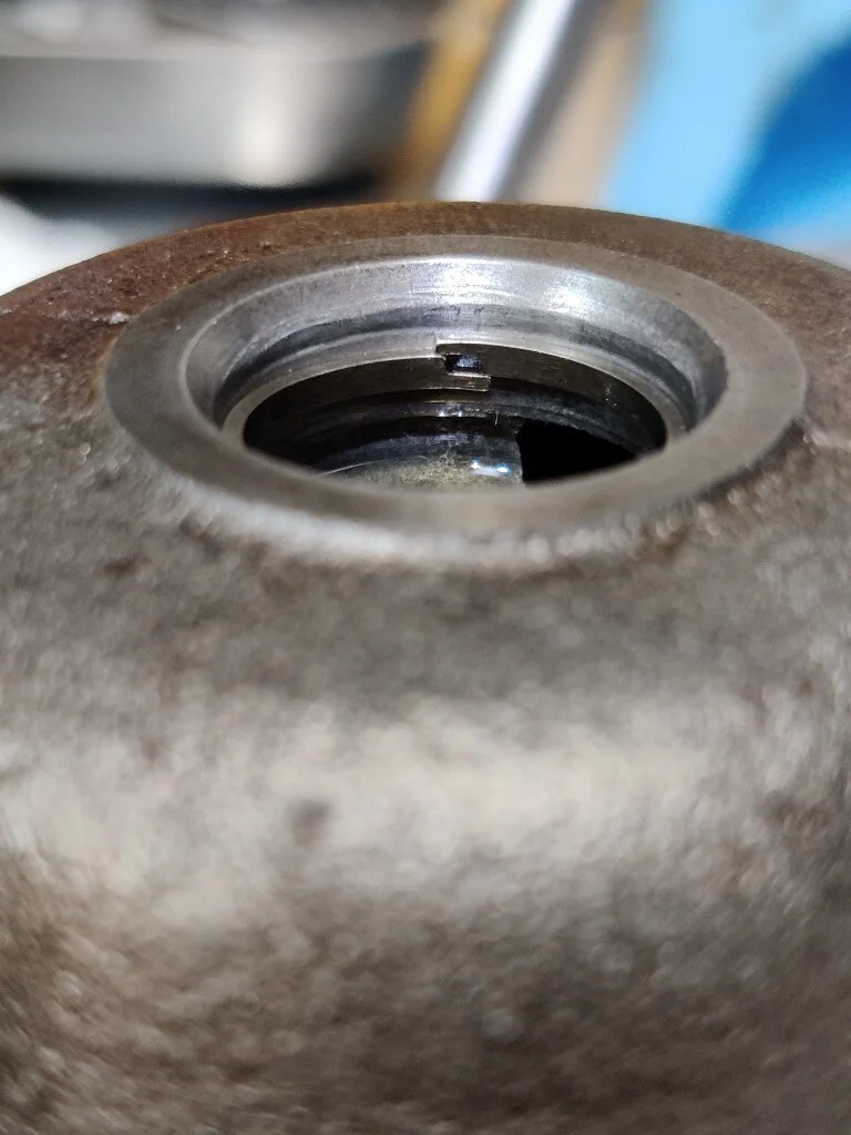

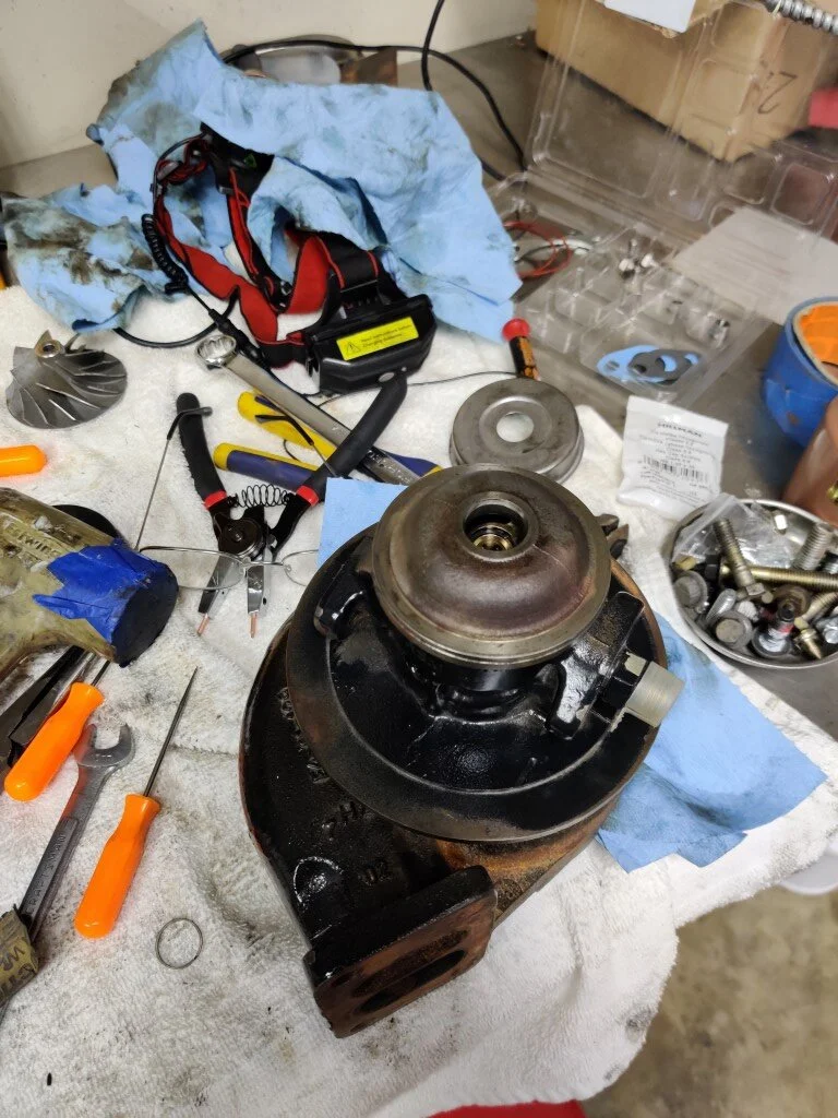

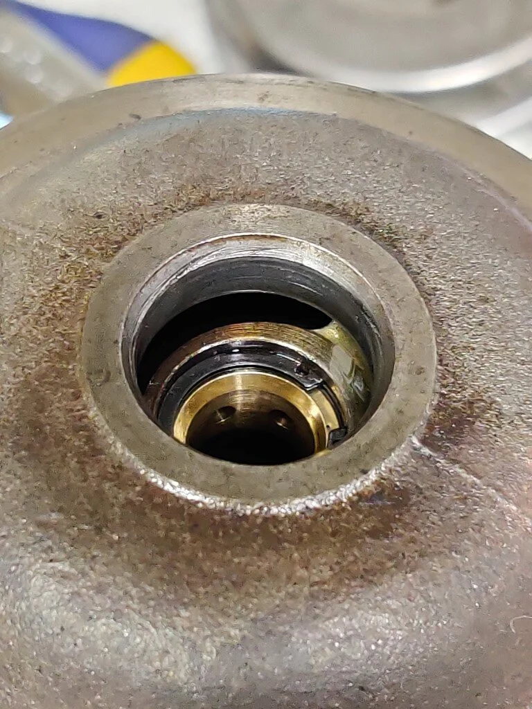

I'm so friggin pissed today. So last weekend, I went to rebuild the HX35 turbo. Cheap assed Amazon snap ring pliers are a tad too short to get the bottom snap ring for the journal bearing on the turbine side. Not terrible, I get it in, and don't mangle it. Get the cartridge together and go to put the turbine in. Oh, I notice I have 1 oil ring seal for the turbine (the new gapless fancy kind). Hmm, my turbine has 2 rings. I email dude at Turbo Lab America where I got the kit and he says, NO problem, I'll send you another one. $8. $4 for the ring, $4 for the mail. Damn, that's not bad at all. So last Monday I pay him. Wednesday I get it....all the way to Memphis, TN from VA in 2 days.
Go to put the turbo together and in a bag for safe keeping. And the turbine WILL. NOT. GO. IN. It will with the old rings....but not with the new and not with 1 new and 1 old. WTF. After an hour I give up. Send dude another email.
He replies take some measurements of the housing and the turbine. Well, Sat morning I put the new rings in the housing It won't go. They are too big. WTF. The gapless part butts up hard. So again I punt and send an email. Don't get a reply Sat or yesterday. Figure dude is ghosting me. Until I get home tonight and notice my email failed to send from my phone. So I email him again, hopefully he knows what the hell is goings on.
THEN, my 19 year old son comes over and I hit the close garage button and halfway down all hell breaks loose and the garage door goes cattywampus 45 degree sideways. We get it back up and I am thinking damn...those springs I put on last year sure sucked if they broke already. They didn't break. The cable on the right side came off, so I finally got the door down. Made sure both drums are oriented the same. Get the cable back on. Release the springs all the way and rewind them exactly even. Door goes up and down by hand. Hook it up. It goes up, it goes down. It goes up, it goes and s itself again.
I disconnected both cables, let the spring off and went and cooked burgers. I can't believe this POS door that's only 20 years old, would up like this. What the hell is this world coming to. So I order a new set of whizbang 5 star rated wheels that will be here Wednesday. The wheels are pretty worn out. I hope that's it.
Maybe by then I'll get an answer on the seals on the turbine. Maybe I just need to get 2 old style rings. If they are too big, I can always file the gap like a regular piston ring. Oh which reminds me, this wasn't the end of my turbo pains.
So while I am trying to read up and figure out what's up with the seals, I read that the snap rings for the journal bearings should have the beveled side towards the bearings, and the flat side away. When I put them in, I did the opposite. Dude from Turbo Lab says bad juju happens so I said ok, I'll pop them out and flip them. An hour later I am sweating and cussing and ready to pour gas on the whole thing. The compressor side took 5 minutes.
It then took 20 minutes to get bottom snap ring on the turbine side out. FIrst try to get it in, snap-bing-bang it flies across the room. I search for 20 minutes and somehow find it! Woohoo. I then get it in, but realized I have now mangled it. It almost falls out. FRICK AND FRACK. So I use the other new one and it pops right in. Put the bearing in and put one of the better looking used ones in. So the center housing is DONE. Just need turbine seals and in the bag it goes.

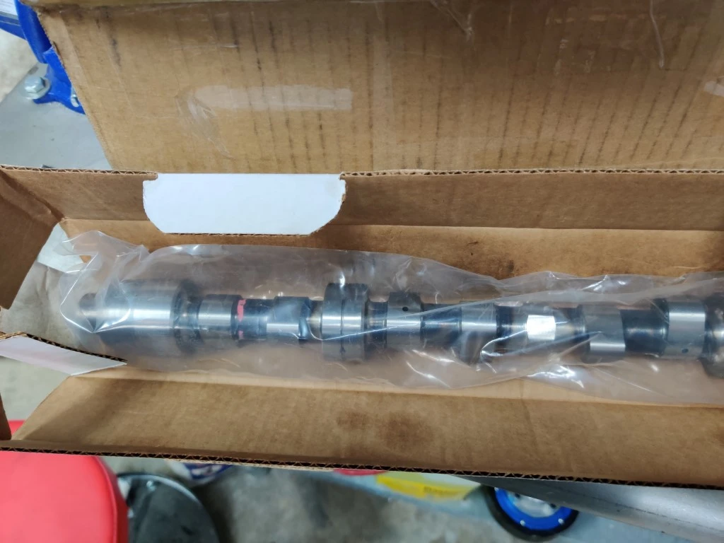

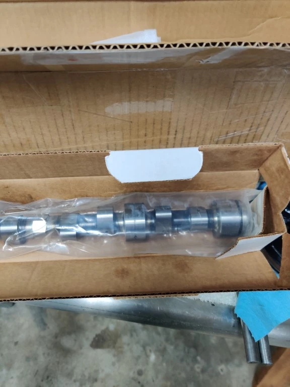

Well, I didn't have anything up on me yet today, so I have that going for me. A box from BoPort Racing showed up. My roller rockers, HLA's, and Stage 3 cam. I can almost smell the hole in the side of the block that's to come!
Dude from Turbo Labs emailed me and punted. Said I could buy a new center section for $55 and the seals he sent fit it. I did more digging and am buying a $22 rebuild kit for an HX50 that has 2 old style rings. By Googleing for a couple of hours I found the Holset part number cross references to some HX35 HX40 and HX50. I'm not sure why my turbine has 2 sealing rings as all the other ones I have seen have 1, but the HX50's have 2. Maybe this will work. I think 2 standard rings will be a better seal than 1 gapless ring anyway. It should last longer perhaps.
Reactions: a91what, 90sickfox, Boostedpimp and 2 others
