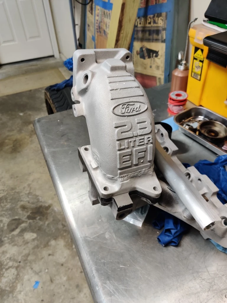

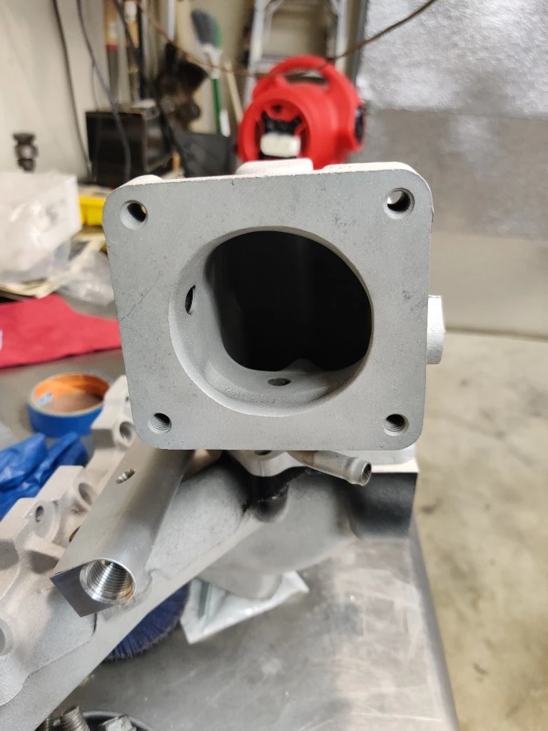

Oh yeah, more goodies came in the mail this week whilst I was away in Chicago for training. A 90 degree (forward facing) rotated and gutted upper intake. It's a work of art. I didn't even realize at first glance the EGR was cut off and welded closed. I honed the block last week and wire brushed it off. Still need to wash it one more time. I'm going to wash and do a little home polish on the crank. Once the pistons and rods arrive, it's go time.

That is one nifty looking piece of aluminum.
The best part was the price. I got it from a guy off the Turbo Ford group out of Canada. It was $225, so I think it was a helluva a deal. The welds are high quality.

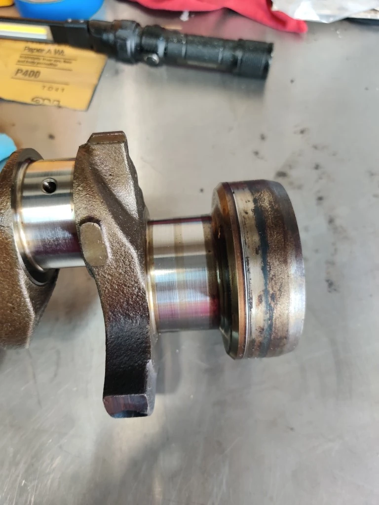

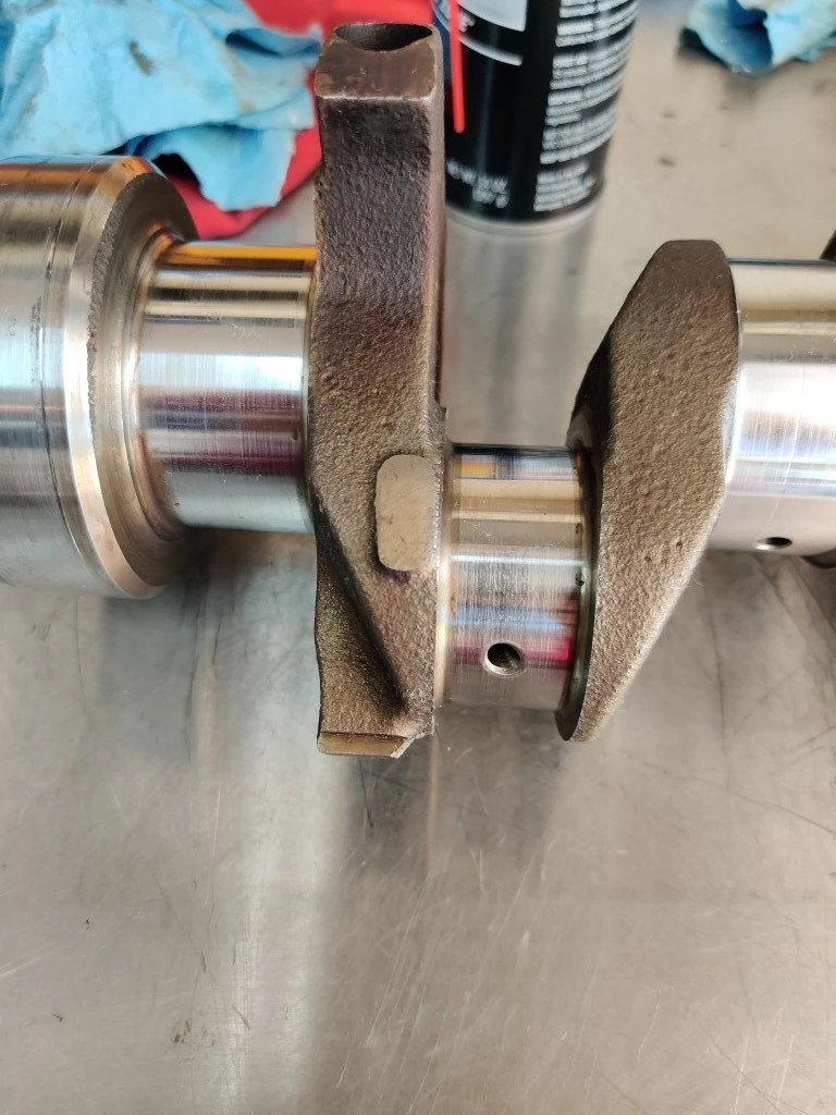

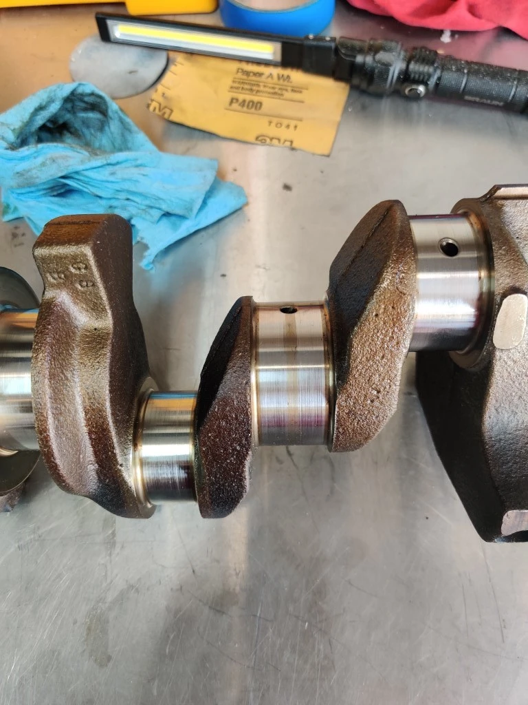

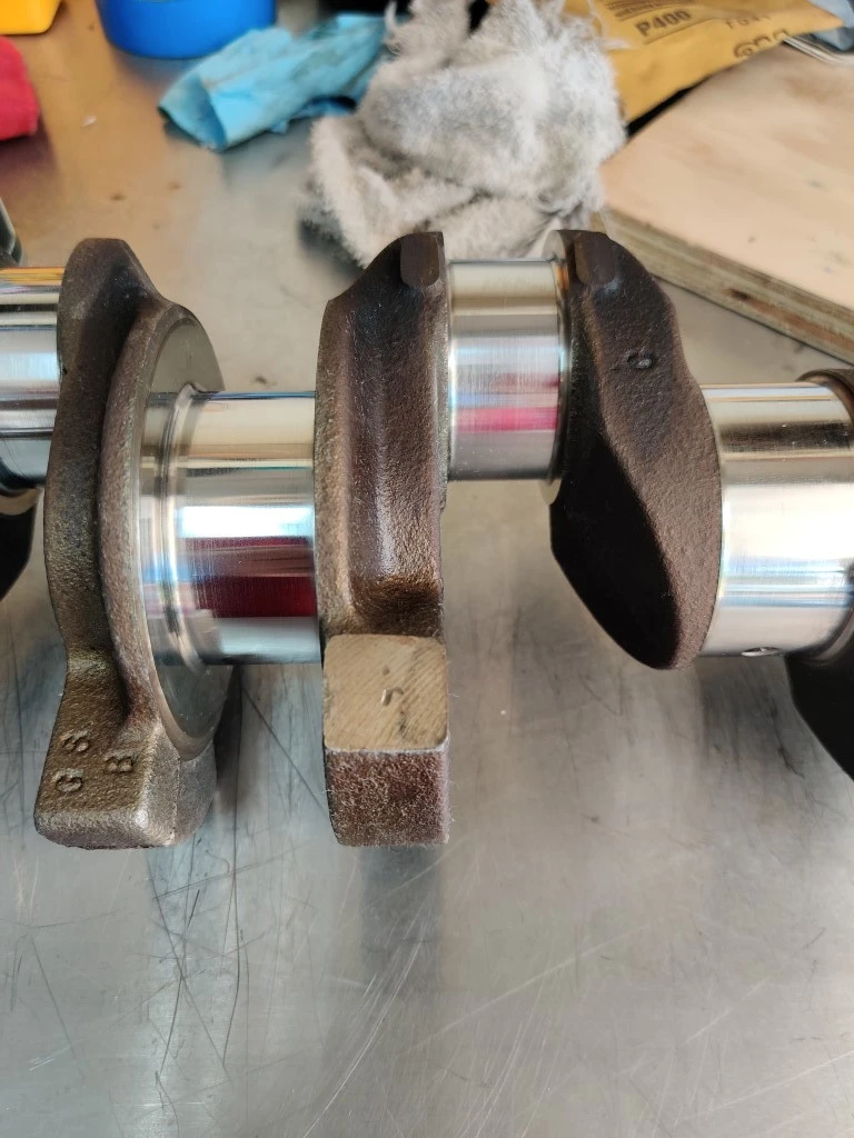

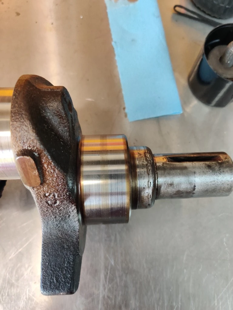

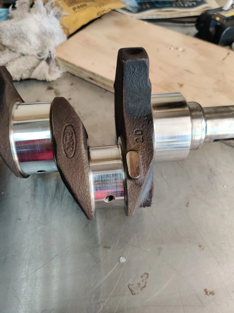

Small steps. Yesterday I polished the crank. The home garage way. I got some metal polish at the 'Zone and tore strips of on old wash cloth. I then went to sawing on each journal. I think it came out good enough.
I only wiped it down with some brake clean. I still need to do a final wash in soapy water and get some rifle brushes and clean out the oil holes.
Hopefully the forged pistons and Total Seal rings get here in the next week or two. After spending way too much time and cussing way too much, after another week or two, I'll have the spiral locks (Satan's invention) in and ready to assemble the short block.
How are you polishing the crank at home?
Exhibit A
Blue Magic Metal Polish Cream from Autozone on strips from a wash cloth. Wrapped around and sawed back and forth. The actual best home polish I have ever done actually was with an old real leather belt. It was on a Buick 455 and when we were done, the journals looked like a mirror. I can't remember what we used for polish.

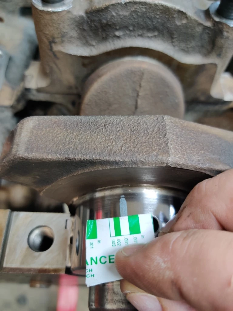

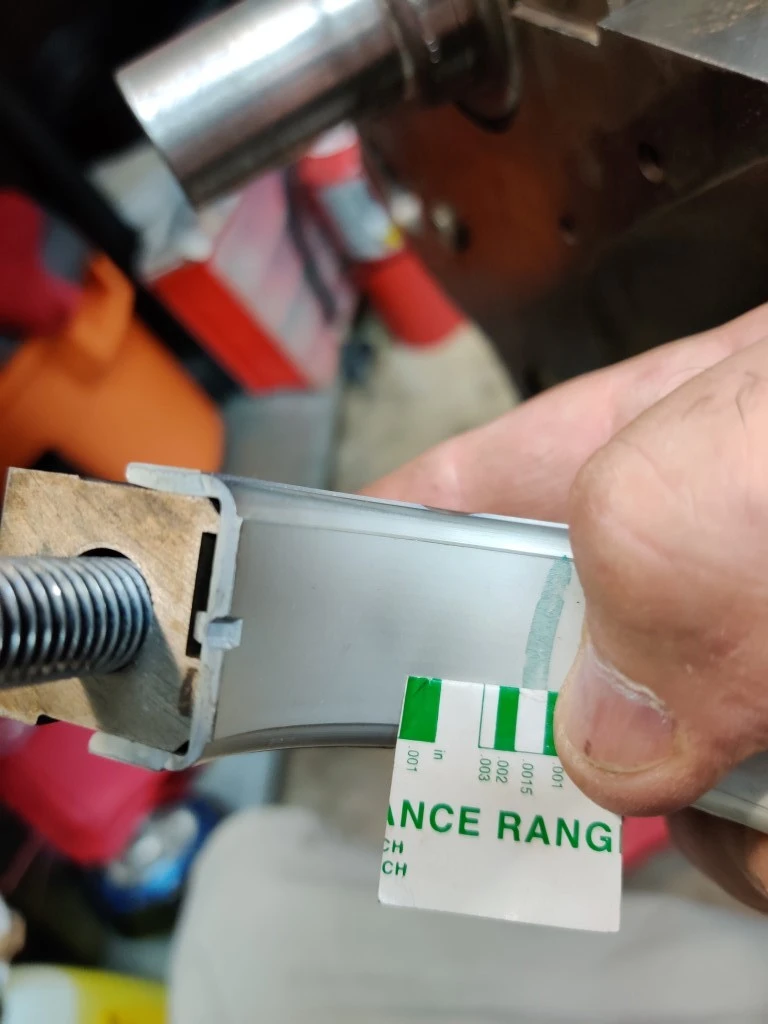

After thoroughly cleaning the crank, I put the main bearings in and torque the crank down to plasti-gage it. Looks like between .0015 and .0020. So .0018 maybe?
CONNECTING ROD BEARINGS
  1. Clearance Crankshaft --Desired 0.0008-0.0015--Allowable 0.0008-0.0026
    Bearing Wall Thickness (Standard) (4) 0.0619-0.0624
MAIN BEARINGS
  1. Clearance Crankshaft --Desired 0.0008-0.0015 --Allowable 0.0008-0.0026
    Bearing Wall Thickness (Standard) (4) 0.0956-0.0951
Looks good, I'll wait and see what the hot oil pressure is, but it should be good.
